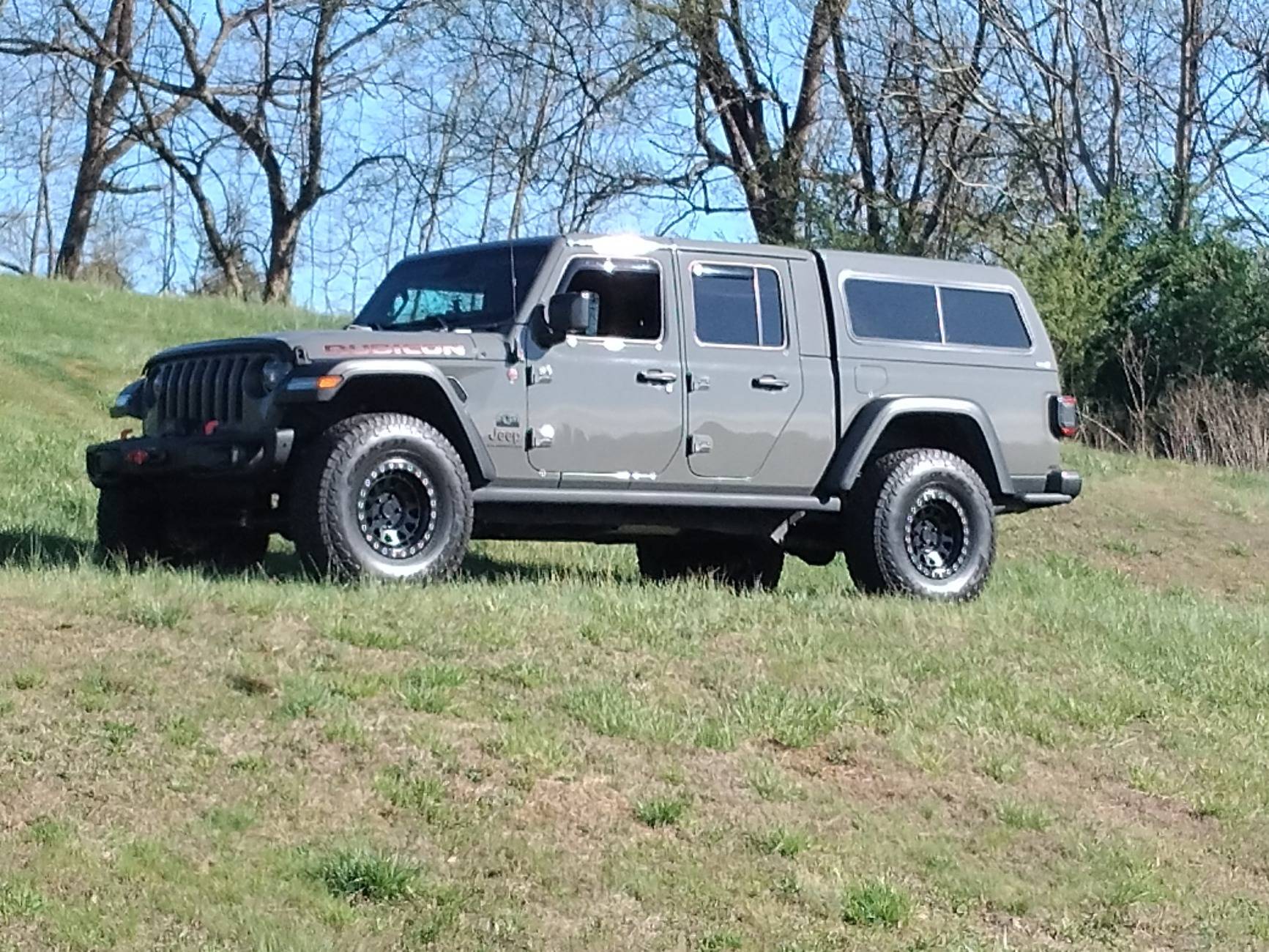

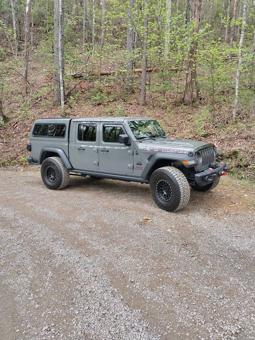

Gladiatorx2
Apr 6, 2024
42
328
463
Knoxville Tn
2021 Gladiator Rubicon
Police Officer

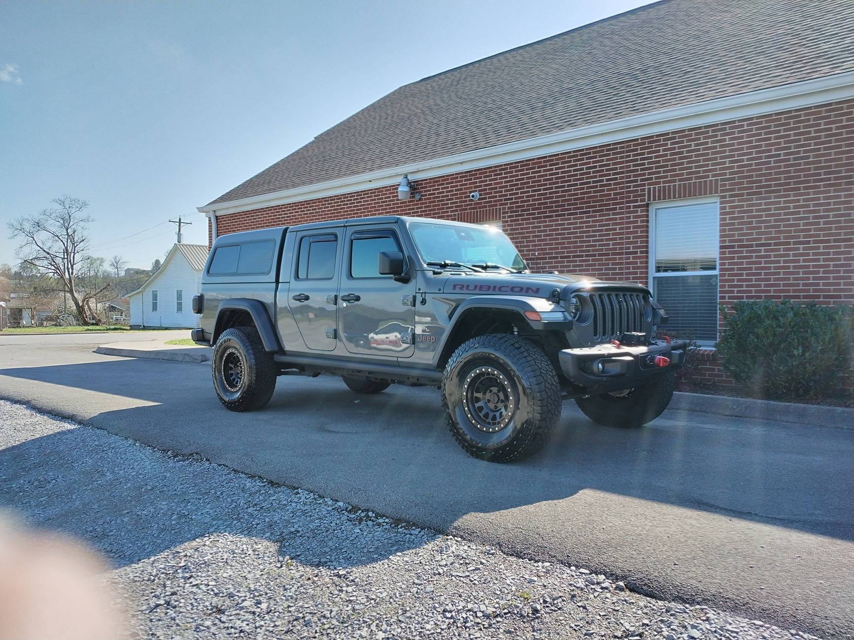

37's on Rubicon was fine on and off road. Never used sway bar disconnect though.

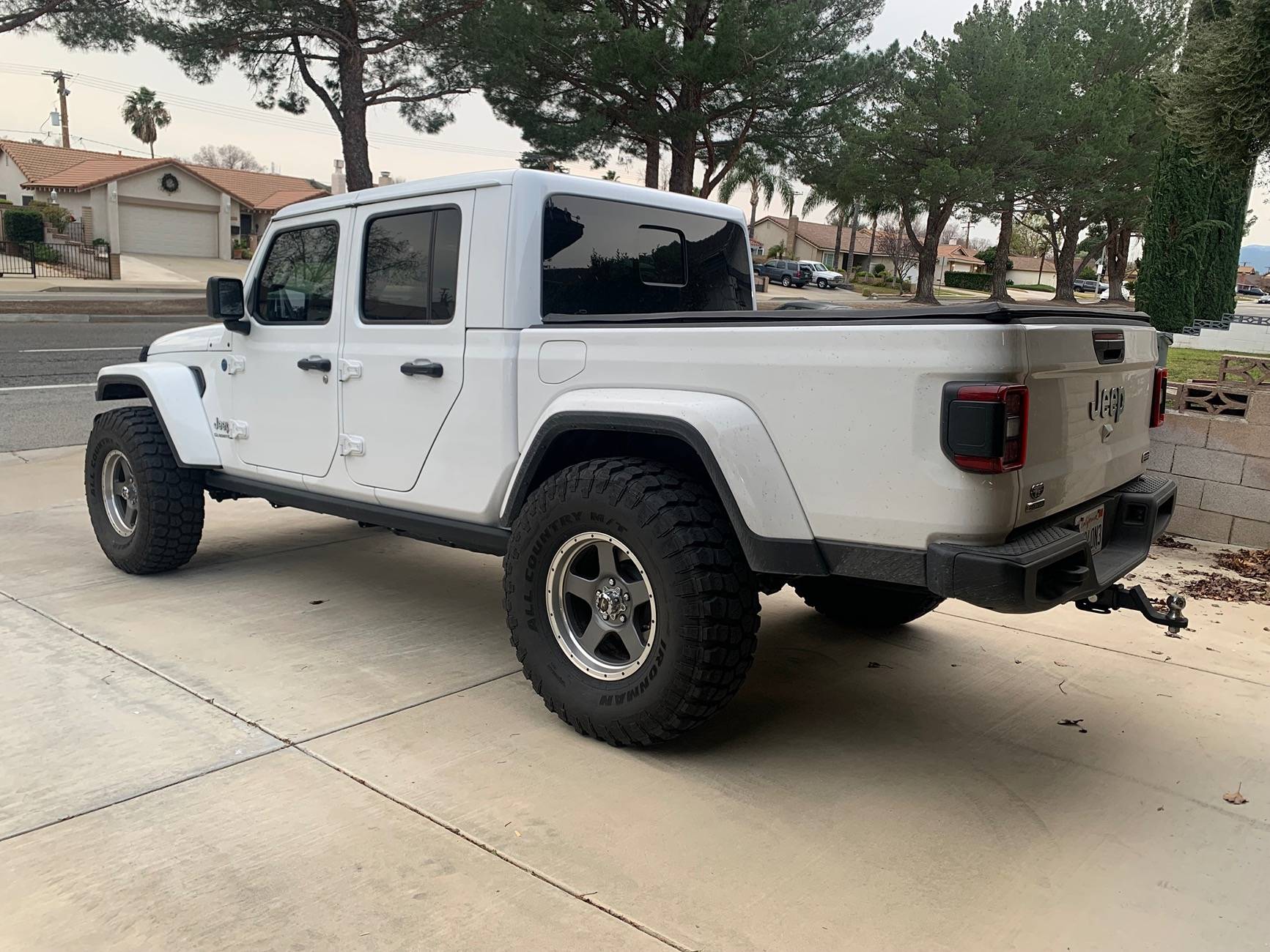

Camaroboi13
Aug 22, 2022
1,821
2,935
SoCal
LEO - Life in Chino
Spacers up front alone and you can run 37s. I did that for a few miles while deciding what parts to buy for my lift. Mine is an Overland so I don’t have the fancy high line fenders either.

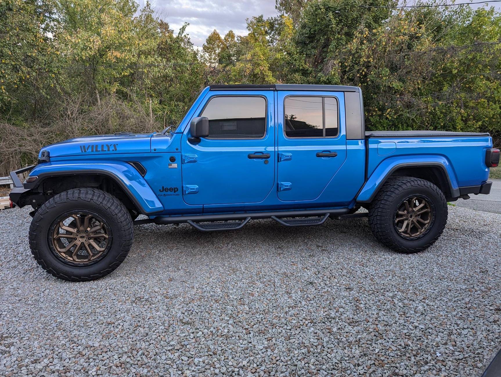

Clancaster23
Jan 7, 2023
51
PA
2021 Jeep Gladiator Willys Sport
Here's where it sits now. Do I need it seeing as I'm rarely going to take it offroad? No. But I love the look of a good lift as I'm sure a lot more guys who don't go offroad do. I've had a '19 and a '21 Ram 1500 that I put lifts on and never went offroad with but I loved how they looked .
I'm not really concerned with fitting 37s on it. My main question is after installing a 3.5" lift, how much more height will I get over this current leveling spacer setup? The leveling spacers are the Rough Country 2.5" type. If I'm right, the lift in a 3.5" kit is how much it lifts the front then the back parts level it out. If that's correct, does that mean I'd only get roughly 1" over where it's at now? And assuming I went with 37s, that would give me roughly another inch up over the 35s.

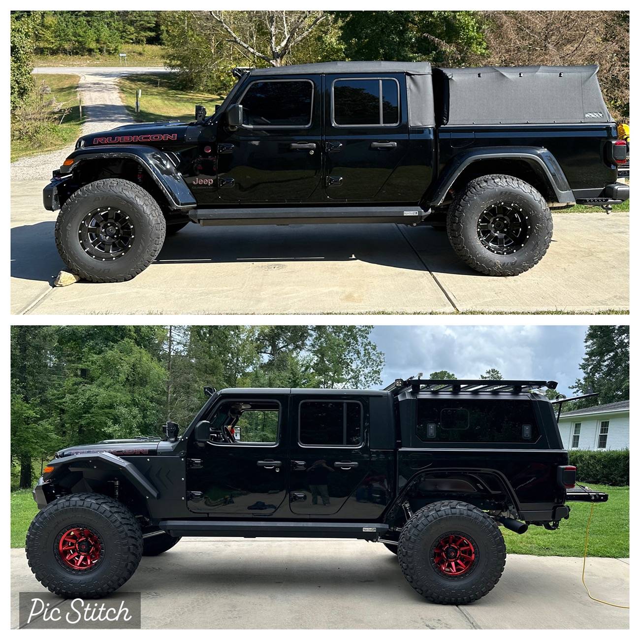

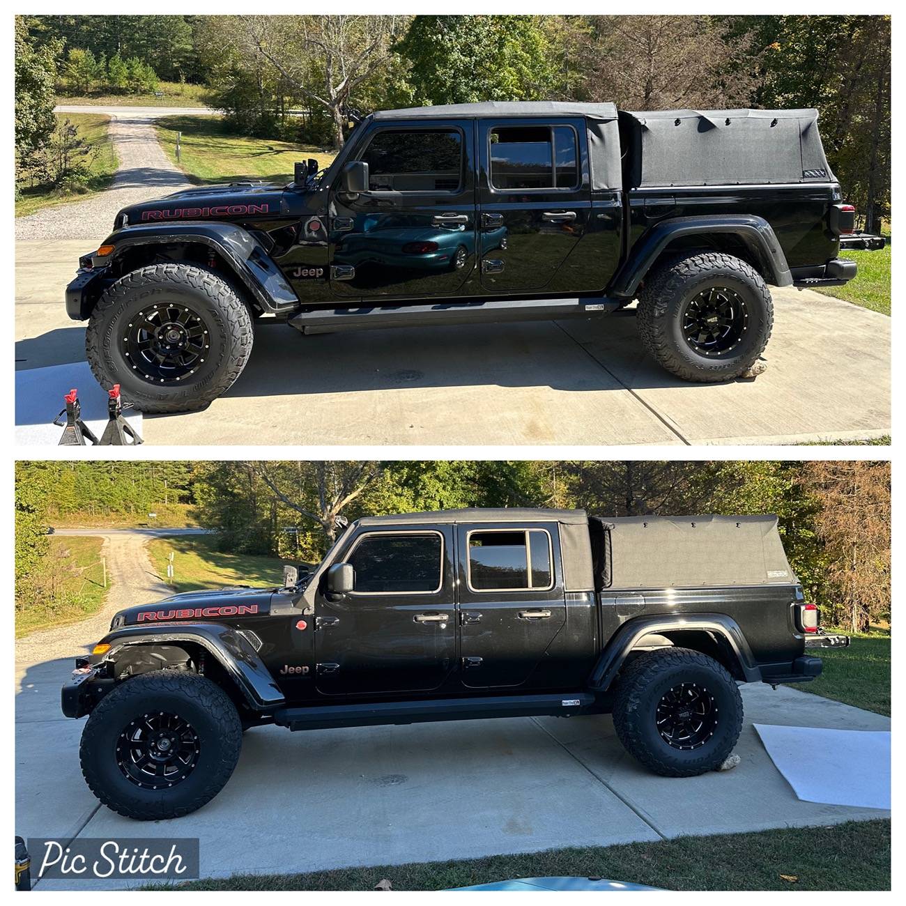

Stitchedupseats
Nov 27, 2020
362
402
North Carolina
22 JTR
Jeep Gladiator Lift height difference IMG_5770
Jeep Gladiator Lift height difference IMG_2712
2” spacer lift on 37s is top pic in both. Bottom pic is 4.5 RK on 40s for top. Second bottom pic is 2.5 rubicon express lift on 37s
the back end on 40s has leveled out now that suspension settled.
Camaroboi13
Aug 22, 2022
1,821
2,935
SoCal
LEO - Life in Chino
your name is on the title, nobody else’s. Do as you please.
A 3.5” lift will net you roughly one more inch in the front and another 3-3.5 in the rear depending on what manufacturer you’re looking at It looks like you have just spacers in the front now and nothing in the back which is why the truck sits as level as it does, am I right?
When I finally lifted mine, I went 4.5” front and 3” rear because I like the leveled stance. It’s not for everyone, but it is for me.
What lift kit were you interested in, there’s probably several people here who could help you out more if we had specifics.
