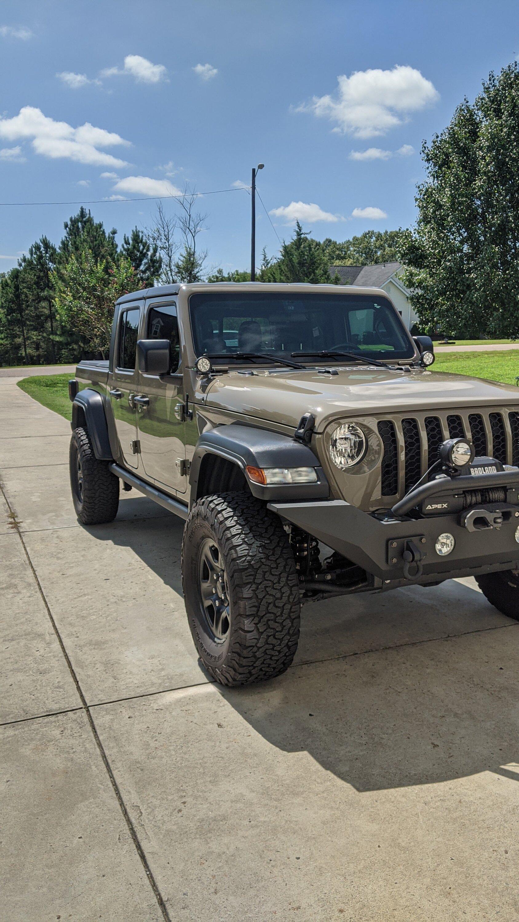

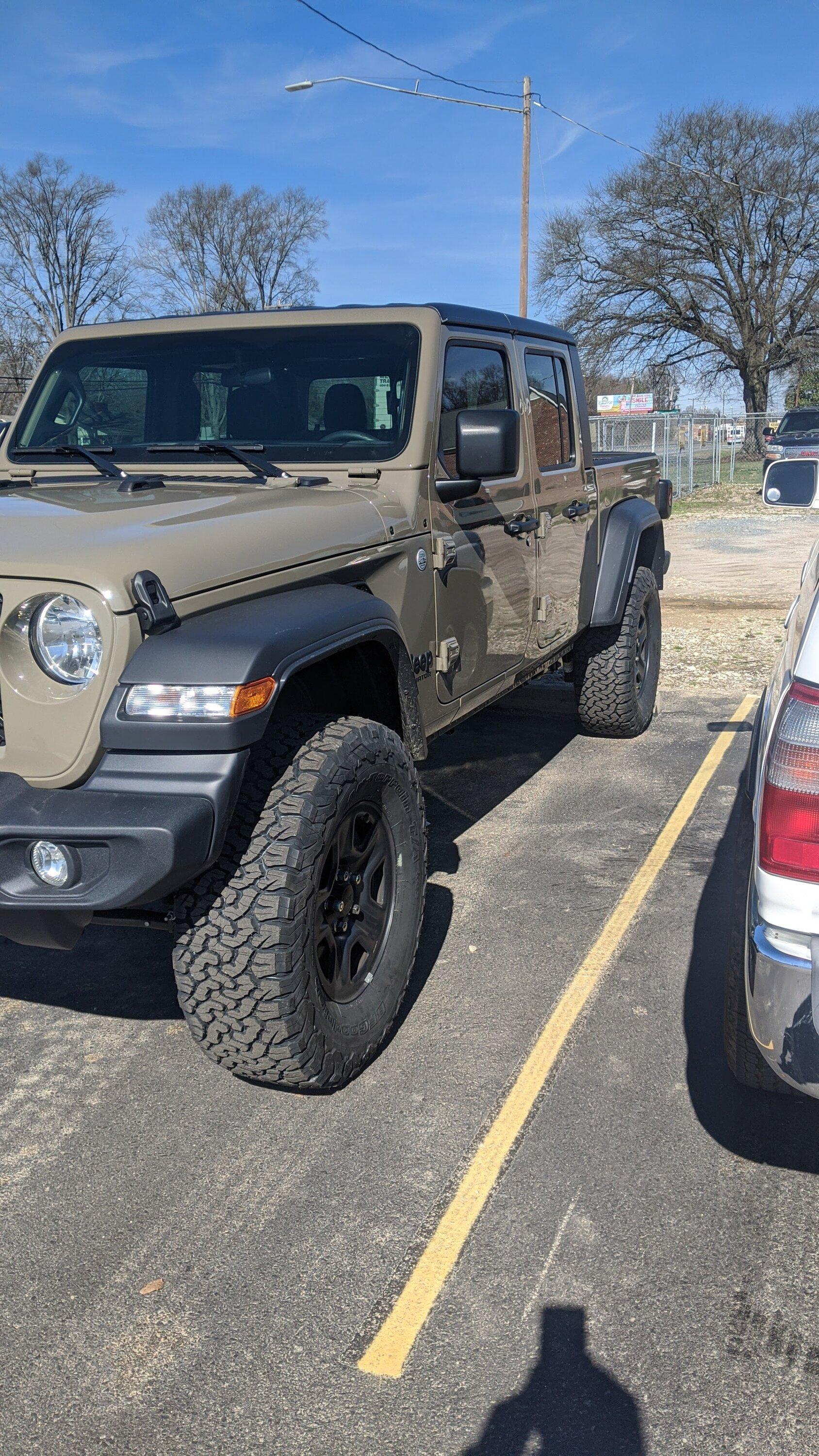

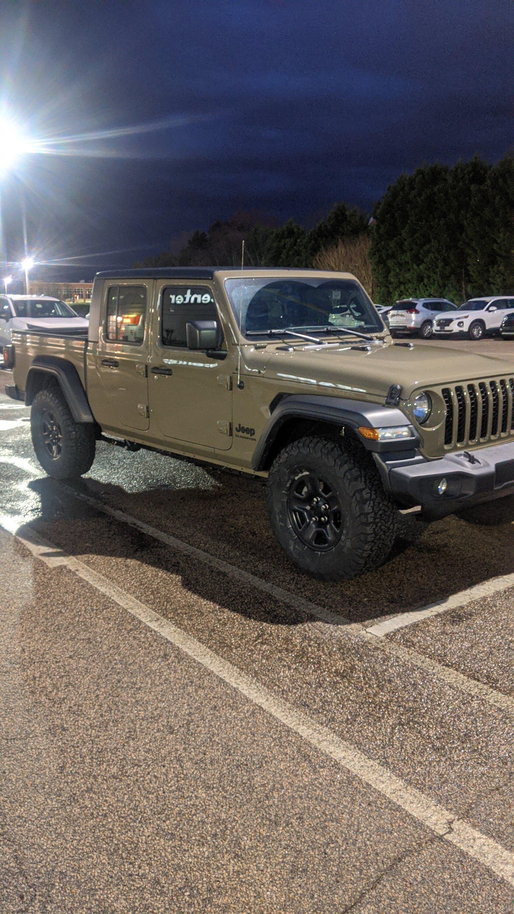

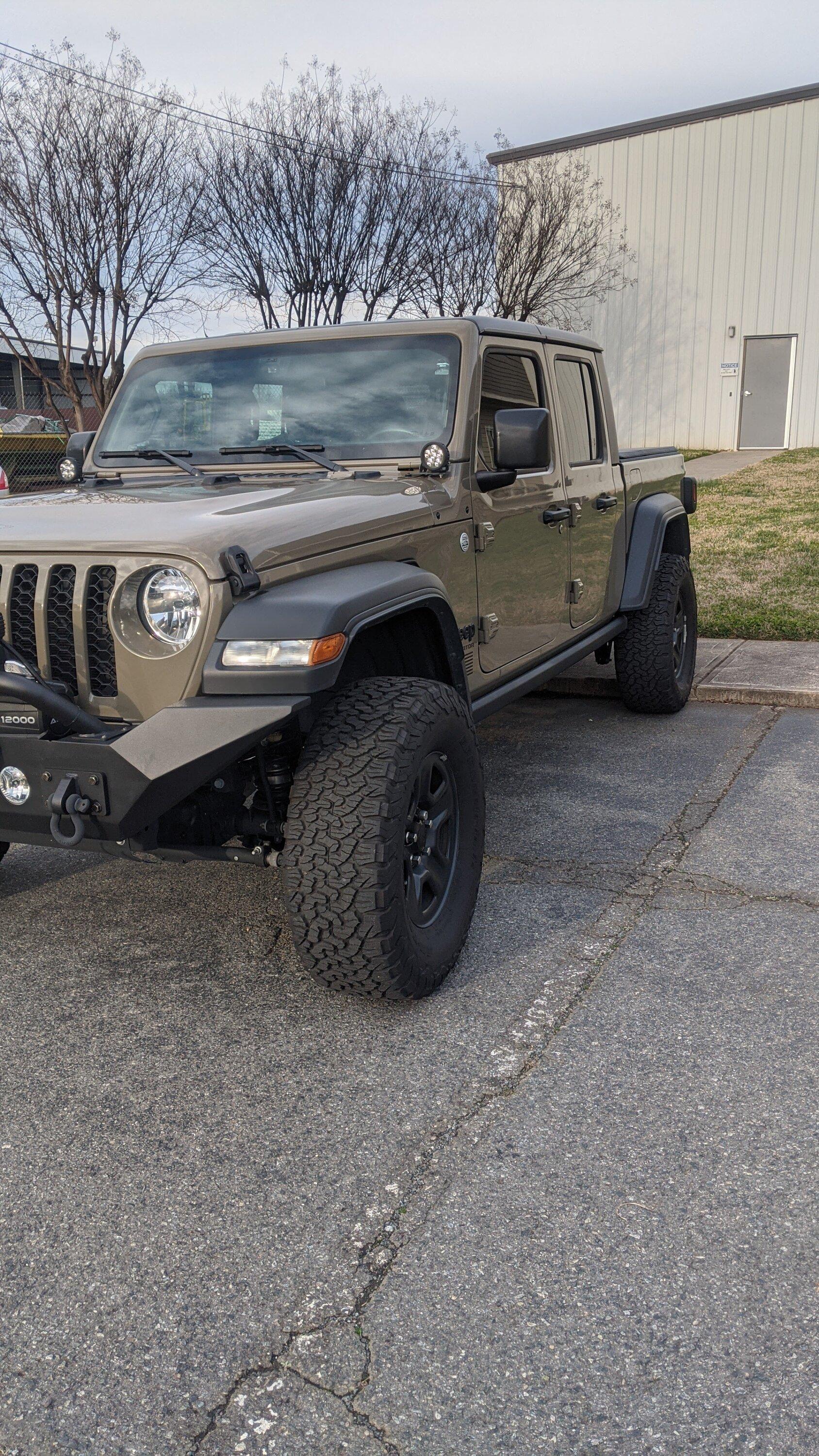

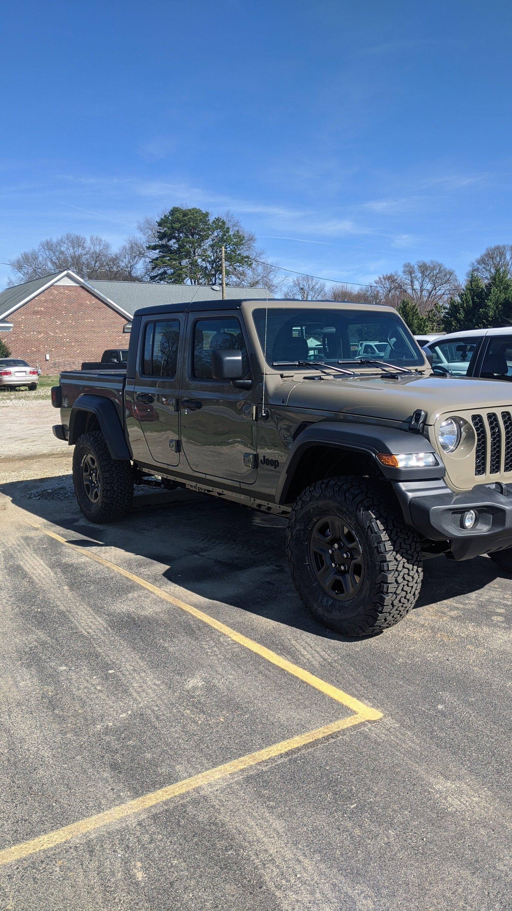

Here's mine with no lift on 35's and with 2.5" SST Readylift on 35's and with 2.5" SST Readylift and Rubicon Takeoff springs in the front on 35's which gave me about 3-1/4 inches in the front and 2 in the rear with the Readylift spacers.
No lift on BFG KO2 35's
2.5 inch Readylift with BFG KO2 35's
2.5" Readylift and Rubicon front springs on BFG KO2 35's and 1-3/4 inch wheel spacers

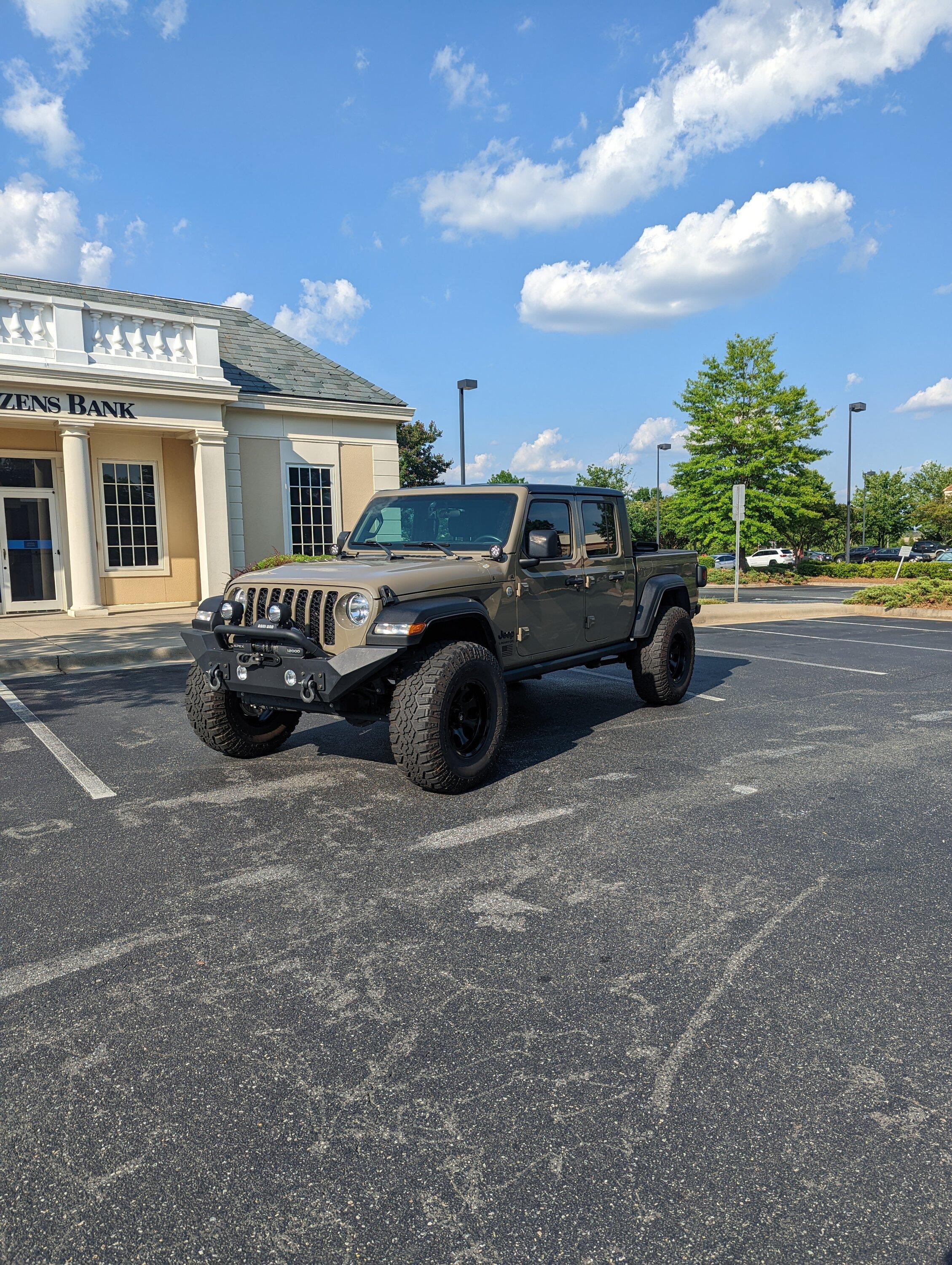

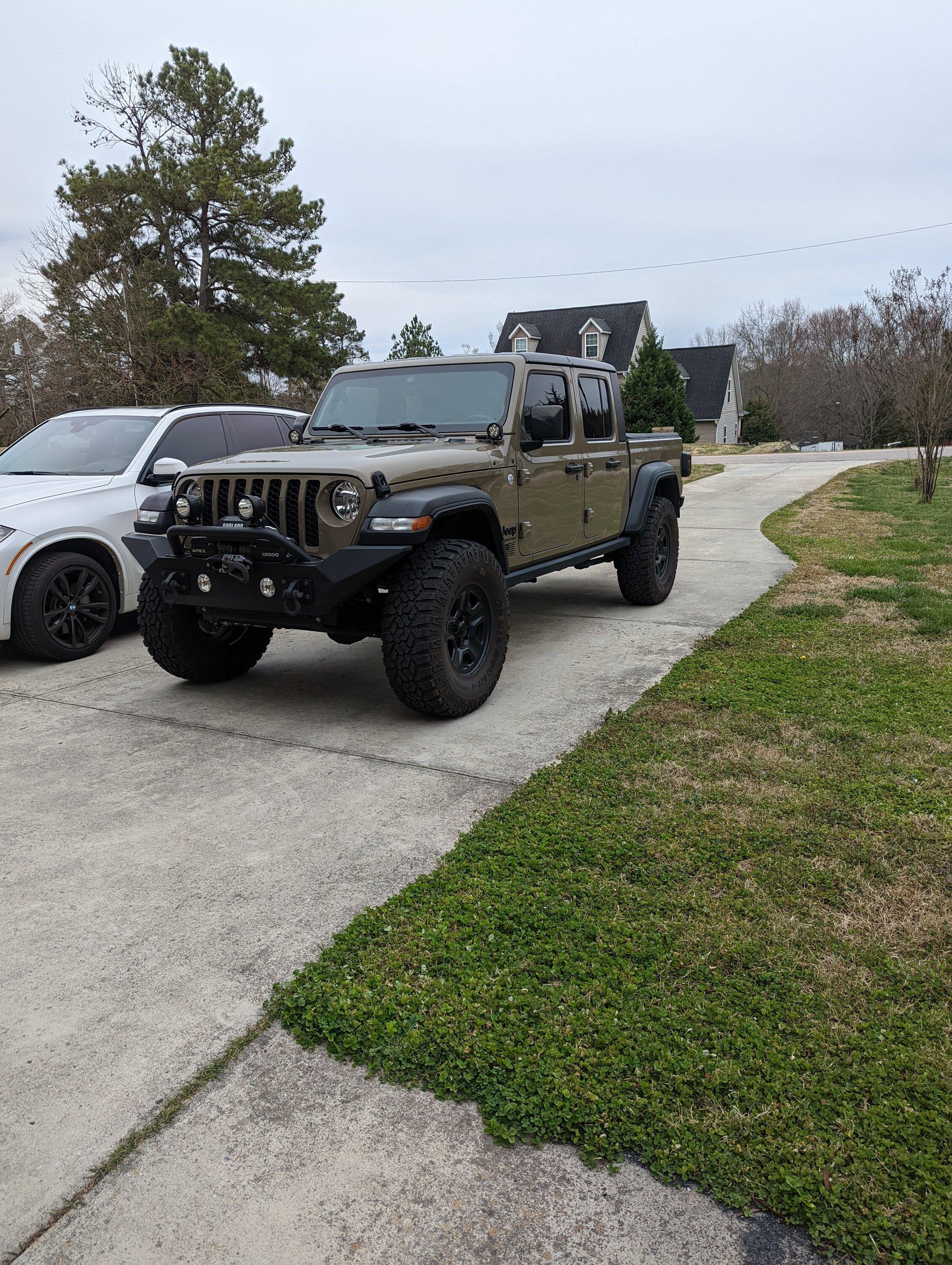

Same lift setup on Kanati Trail hog 37 12.5 17
Same lift setup on Fuel 17x9 wheels with -12 offset and Kanti 37's
Just to give you a idea. Personal I think anything over 2 requires 37's to look right. Almost like they are made for 37's
Looks great.
Any rubbing? Thinking of doing the same, Max tow with SST 2.5 and 37 KO2.
