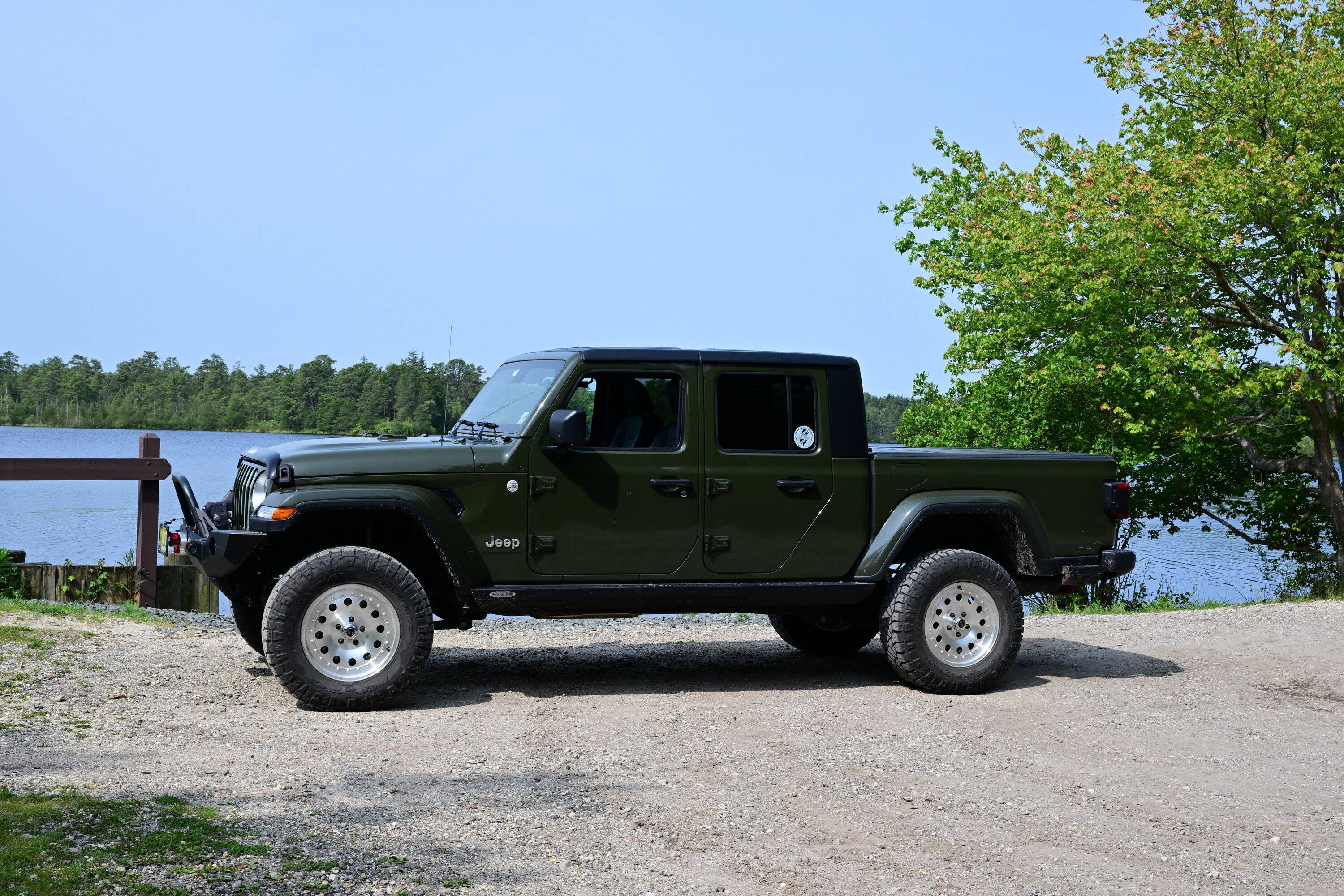

49Gramps
Apr 8, 2019
312
333
NJ
'21 Gladiator Overland
Retired Fire & EMS Dispatcher
Mine is a '21 Overland with the AEV Suspension (with the drop brackets), Terraflex 1 1/2" spacer in front to level it out, Clayton front track bar, and 285/70 18 Ridge Grapplers (34") on AR Outlaw II (18x8, +30) wheels. I kept the original 3.73 gears for just over a year before having it regeared to 4:56.

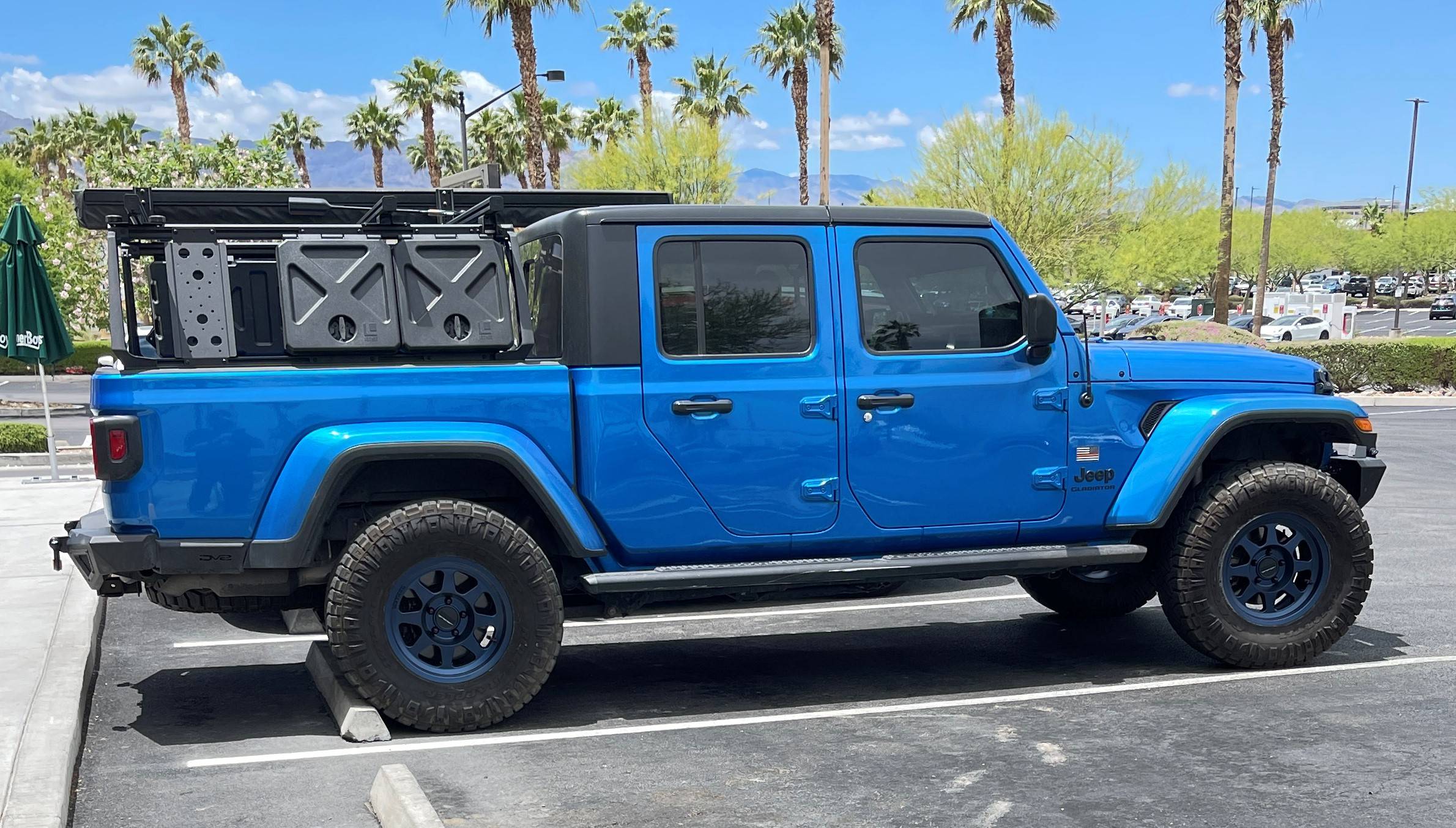

Wheelin98TJ
Ryan
Jul 27, 2021
3,699
4,358
Devils Lake, MI
2021 Jeep Gladiator
Bean Counter
I went with the Clayton 2.5" Ride Right. I thought it was the best value for the price. It includes everything you need except shocks.
This kit removes some of the factory rake, but not all of it. You can easily add a spacer in the front since the kit comes with adjustable arms and adjustable track bars. I think the slight amount of rake with this kit looks just right so I did not add a spacer.

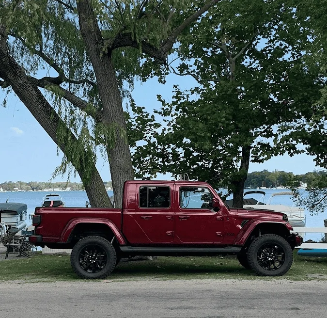

djthumper
Larry
Oct 5, 2021
528
420
North Las Vegas, NV
21 JT Sport S Eco Diesel, 18 JLU Sport S
I.T.
I had mine installed at the dealer to keep my warranty intact.
I have the Skyjacker 2.5" and bought a few extras to match up to the MOPAR lift kit. I bought it for less than the MOPAR kit and got more lift and better springs.

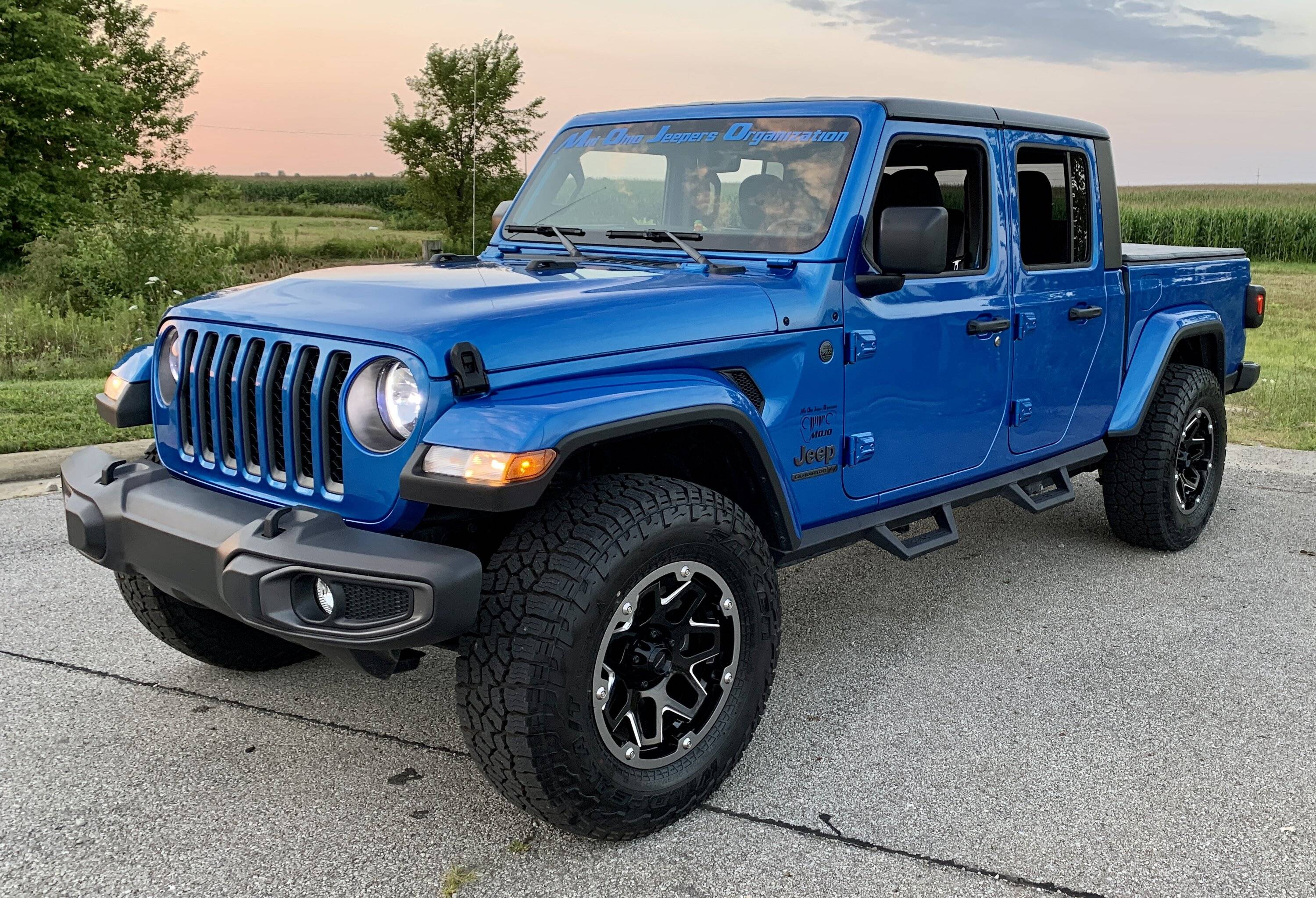

jjdustr340
Jason
Nov 5, 2020
458
825
Ohio
2023 Gladiator Mojave
Crime fighter.
Jeep Gladiator Lift kit for dummy’s E8892093-2D2A-4095-AC27-7A3869E1ECD8
Jeep Gladiator Lift kit for dummy’s E341ADF6-4A8F-42AD-BC21-E69679935B5F
295/70R18 Wildpeaks (34x11.5)
1.5” Teraflex Level kit
Mopar LCA’s
The LCA’s help add some badly needed caster. As a result, it drives better than stock.
Reprogrammed with Jscan and I still see 8th gear all the time without issue.
Admittedly I’m currently looking into a bit more lift and slightly larger tires, though this setup has served me quite well.
