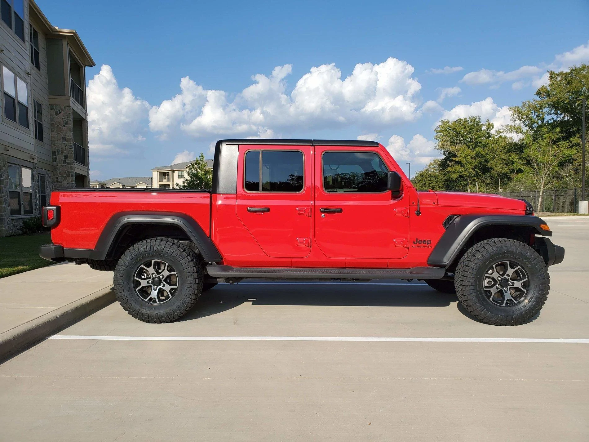

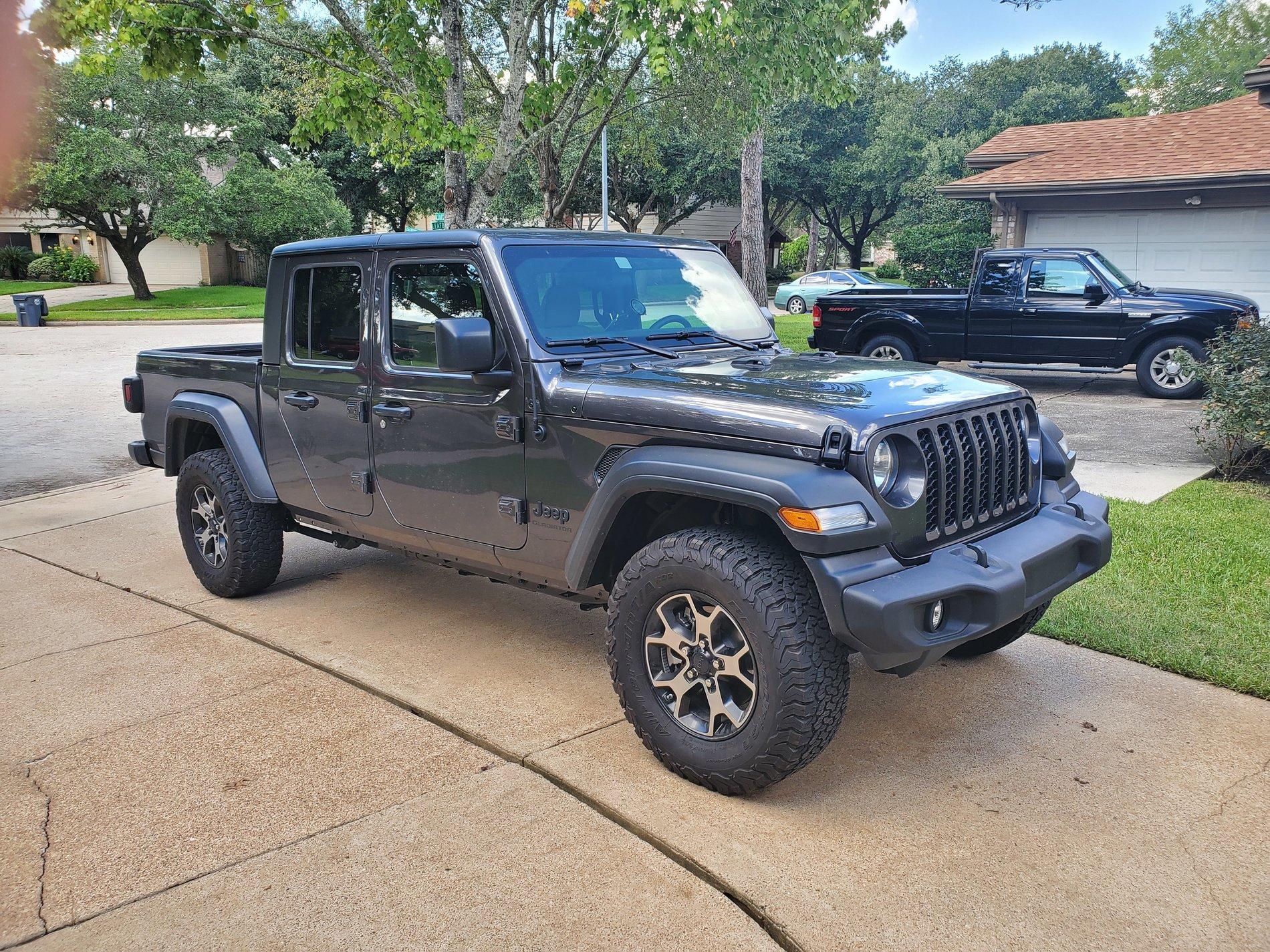

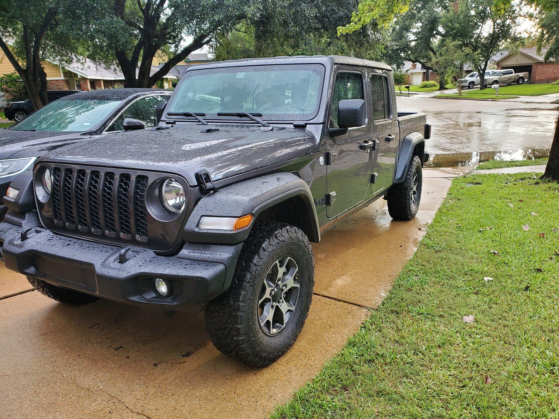

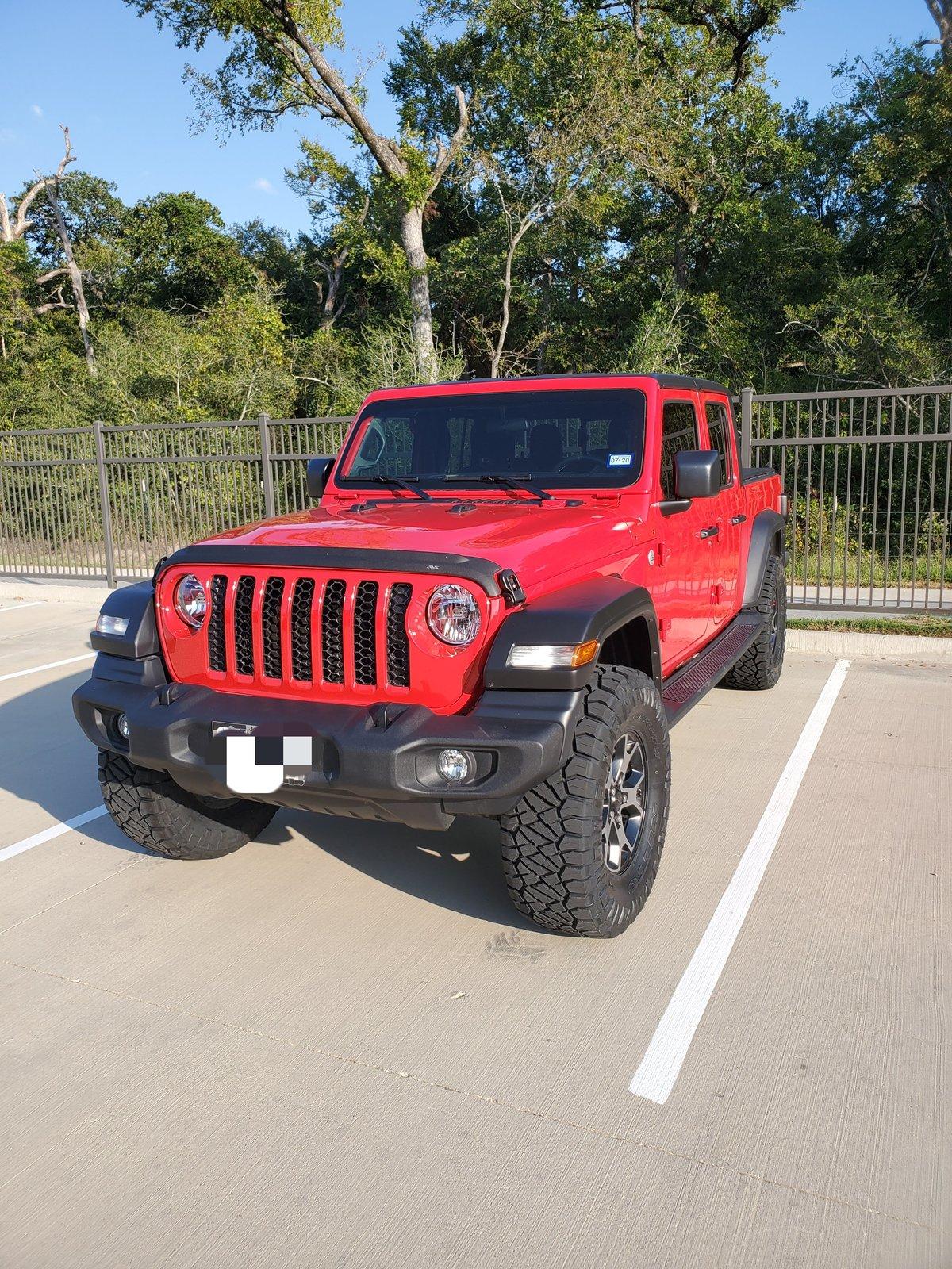

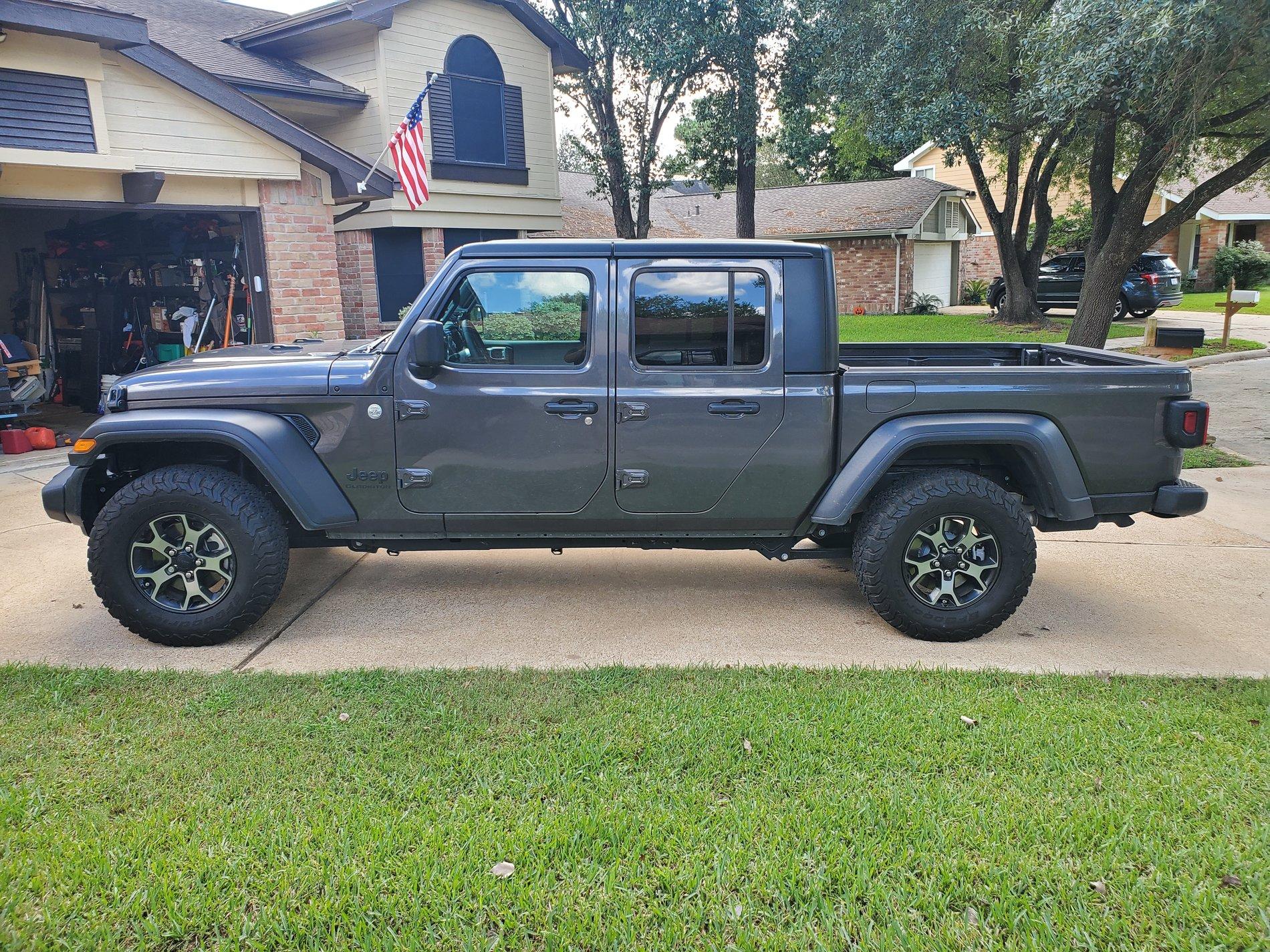

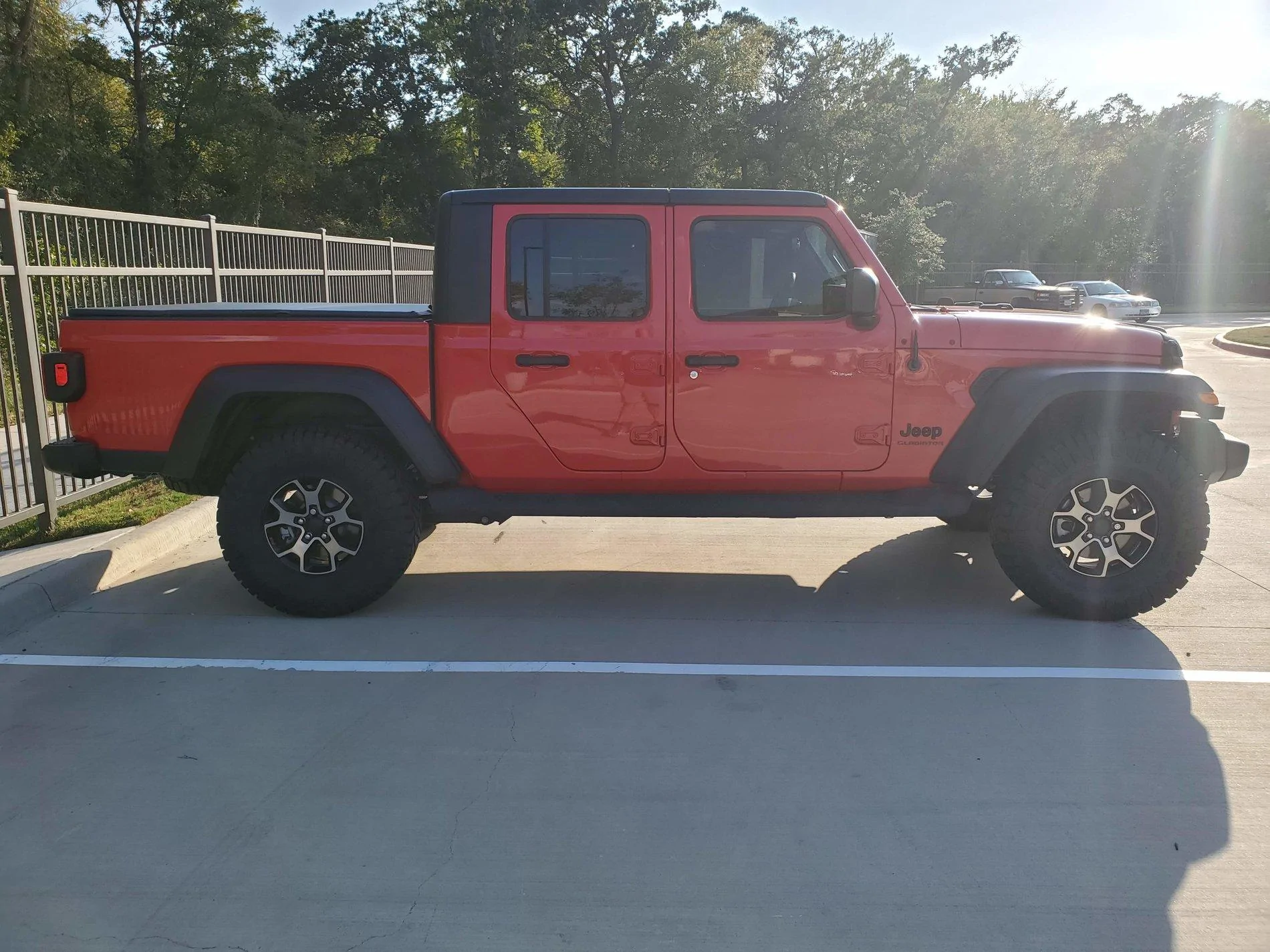

This is what I have come up with... adding a front 2.5 level and a rear 3/4 spacer to achieve the height I want and the level. Also adding the rubicon fox shocks but keeping my max tow springs... thoughts?
I have a Sport Max tow and was wondering the same thing. I was thinking of doing the Daystar level lift kit with Rubicon shocks and keeping the max tow springs.
Is this what you did? How did turn out?

works great... really happy with the set up

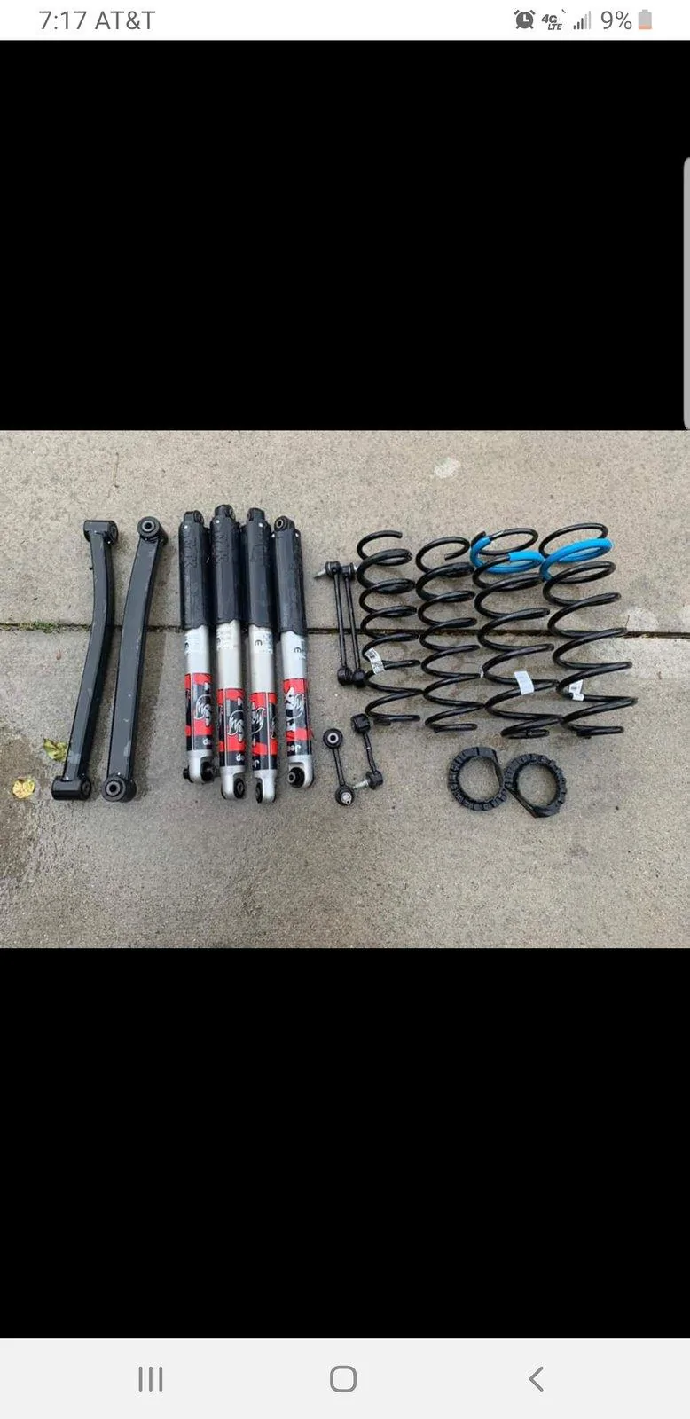

.but I didn't get the max tow pkg because I got a great deal on one in stock. If I buy these Rubicon takeoffs what it benefit me at all, or even fit on my sport S? Price is $300

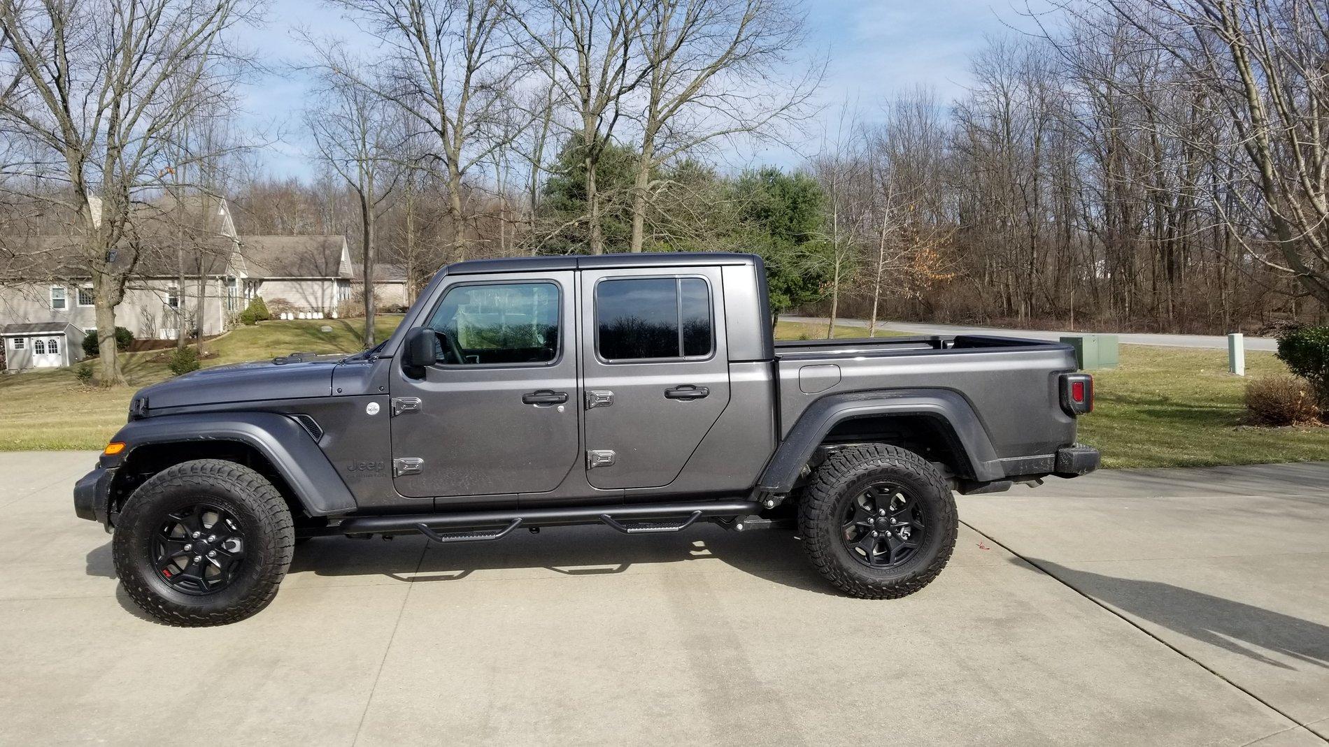

I am currently running 33s and have the Daystar 1.5 inch spacers (found them for $65 shipped) sitting in the garage for my next day off. My plan is a level until the 33s need to be replaced and then 35s and MAYBE more lift.
As she sits now:
