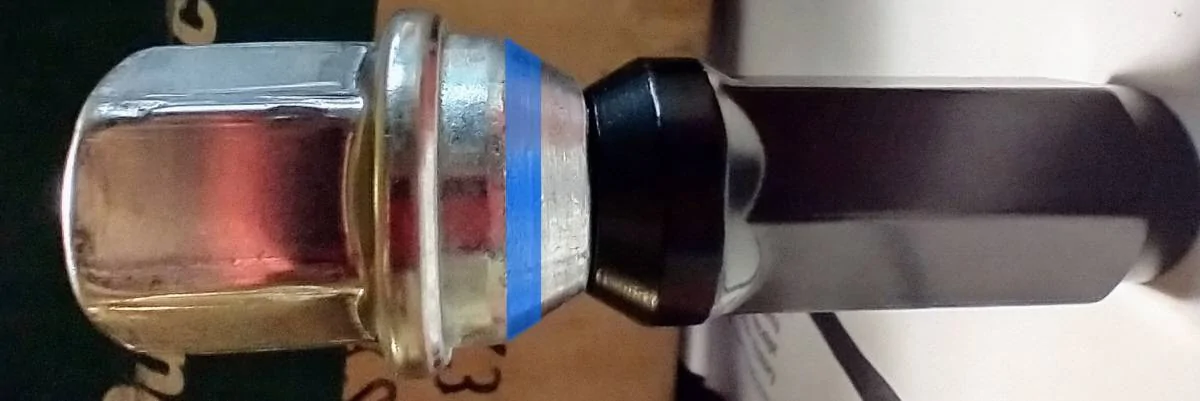

Here is a visual of the difference in the contact area (blue area) between an OEM lug nut and an aftermarket lug nut that @Viper501 mentioned. I agree with him that if Jeep did not think the added contact area was necessary, they would not have gone in that direction. As always YMMV

That’s a great photo comparison.

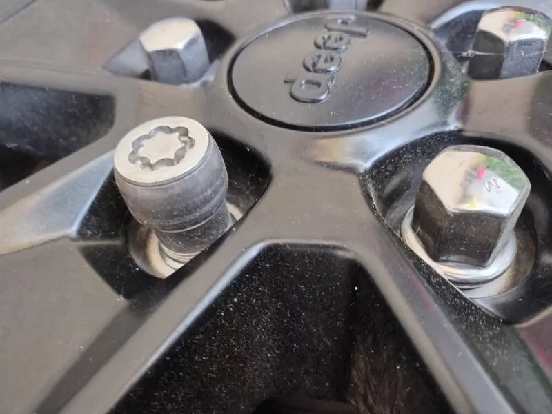

The only plus side to the spline type is if the crooks don't already have a 'master' socket, those sets come in a 20 to a set vs. the 4 to a sets for most locks. So if they are hammering on a socket to remove the lug nuts, they will have to do that 20 times. The OEM locking lug nuts stick out future than you would think, so easier for 'criminal tool access'. I'll snap a photo tomorrow for reference.
Note-they spline lugnuts I am describing are the generic sets available on Amazon, not the specific 4-pack like on the above test video.
Update - OEM locking lugnut
Jeep Gladiator Locking Lug Nuts lln
