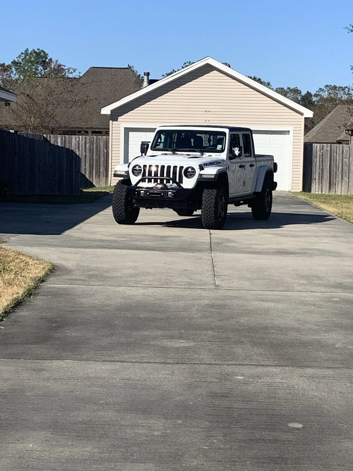

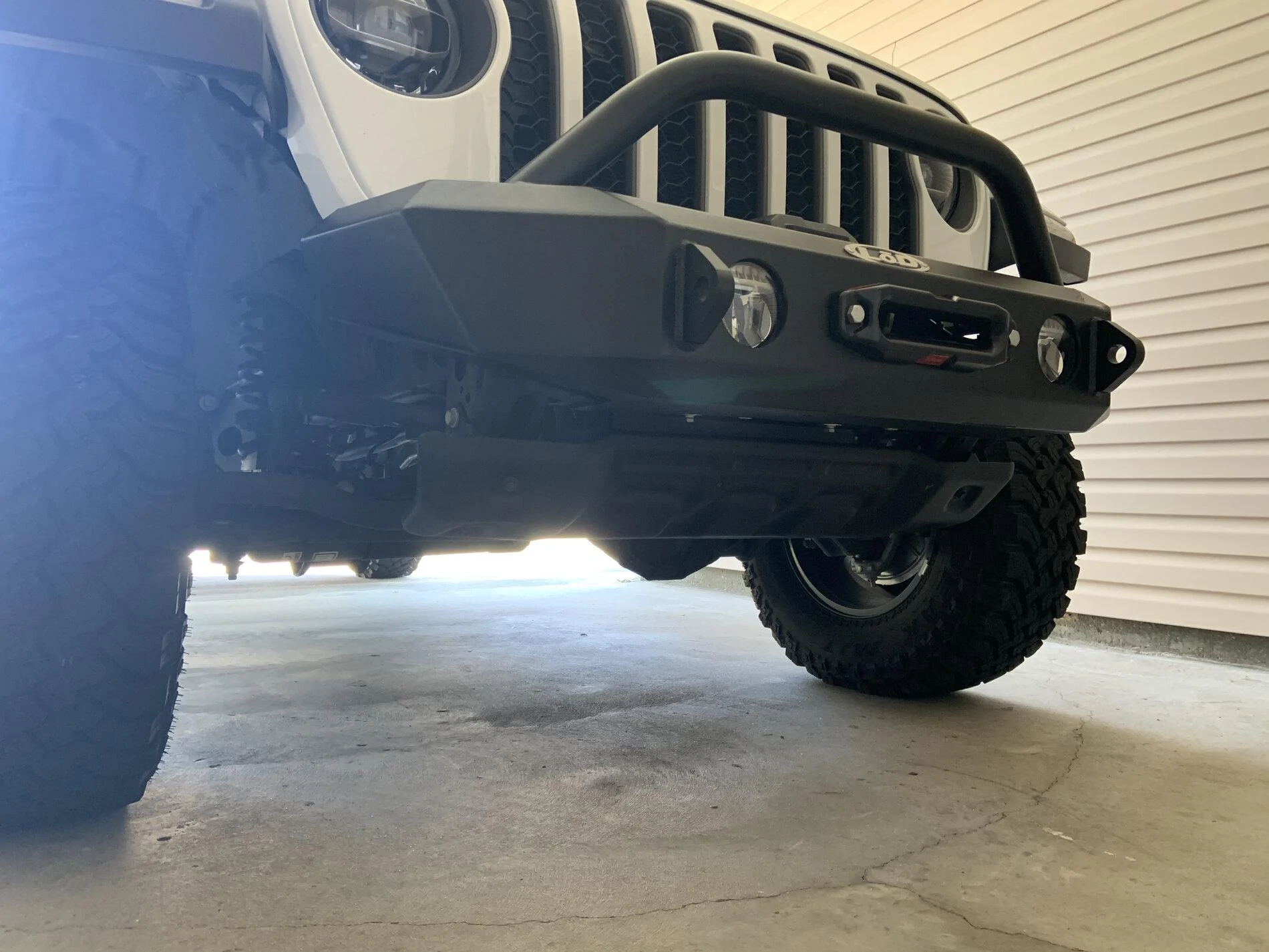

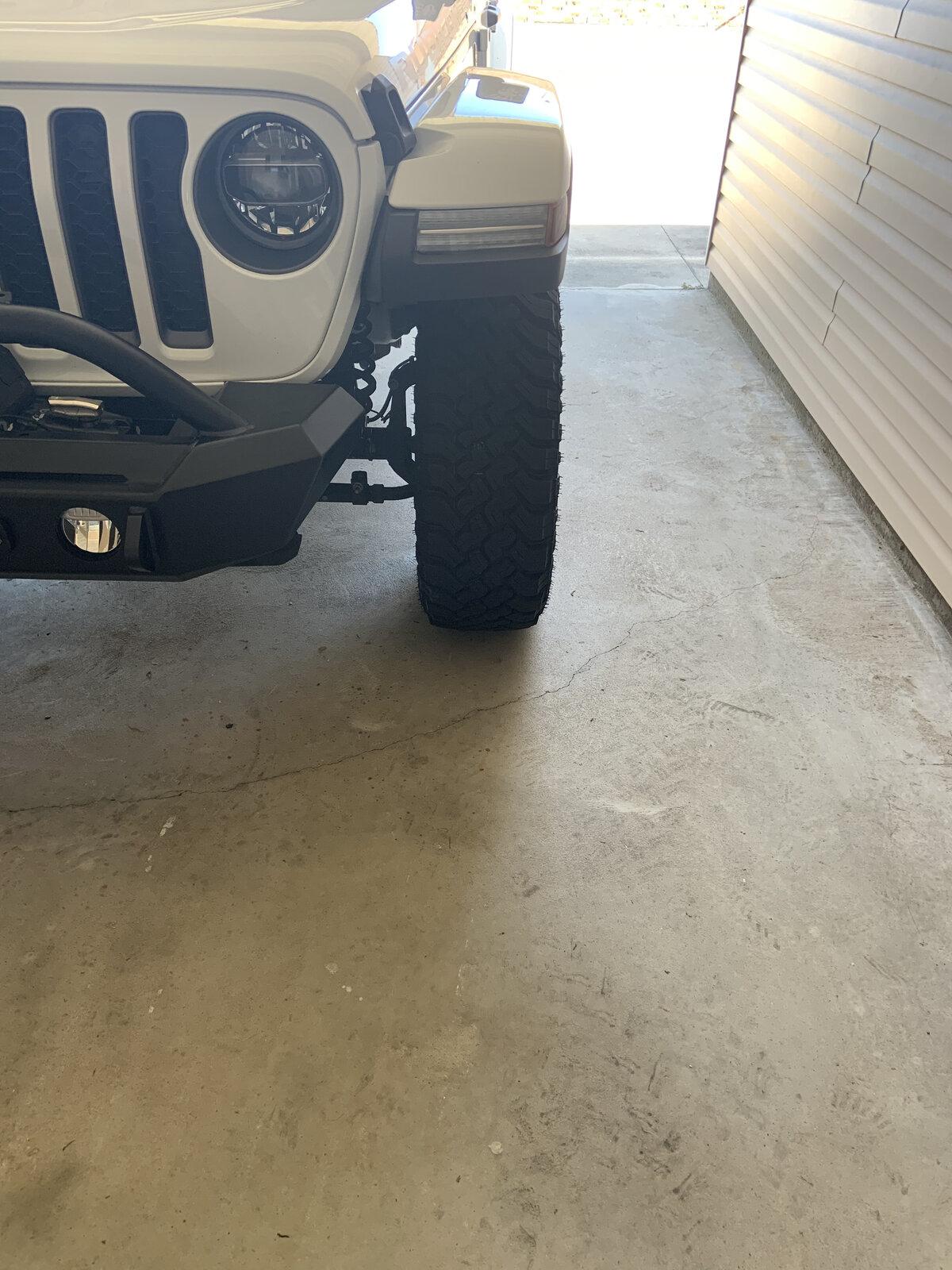

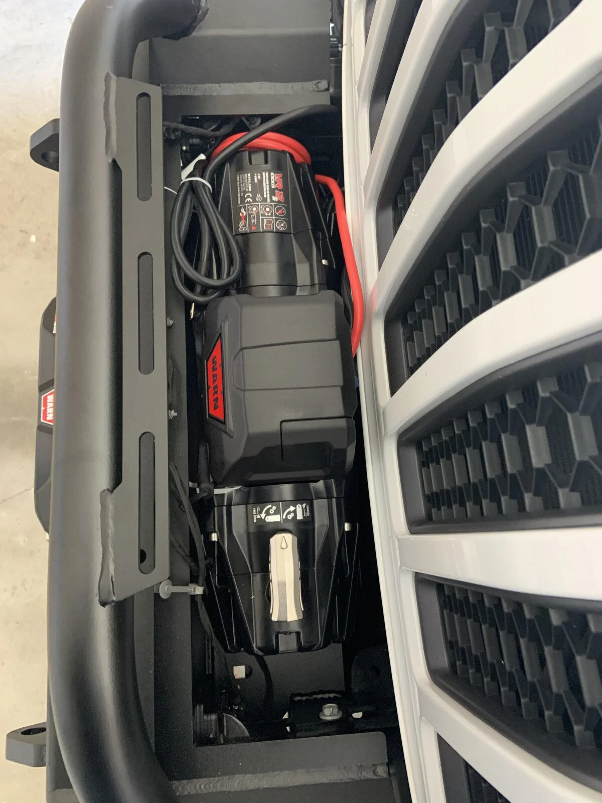

Finally bolted up my new bumper and winch. Really happy with the way it looks. The winch sits really low and barely blocks any of the grill. Its a tight fit between the grill and the back of the winch, but I think I can move the wires around to add some clearance.

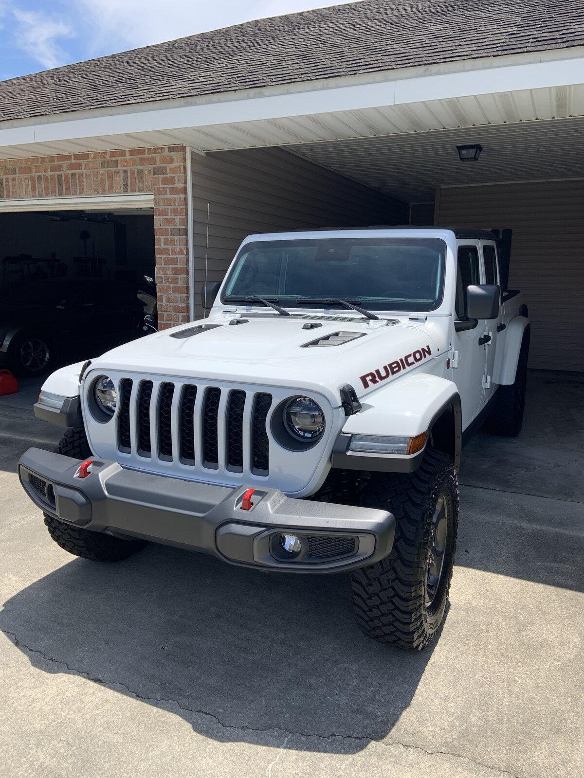

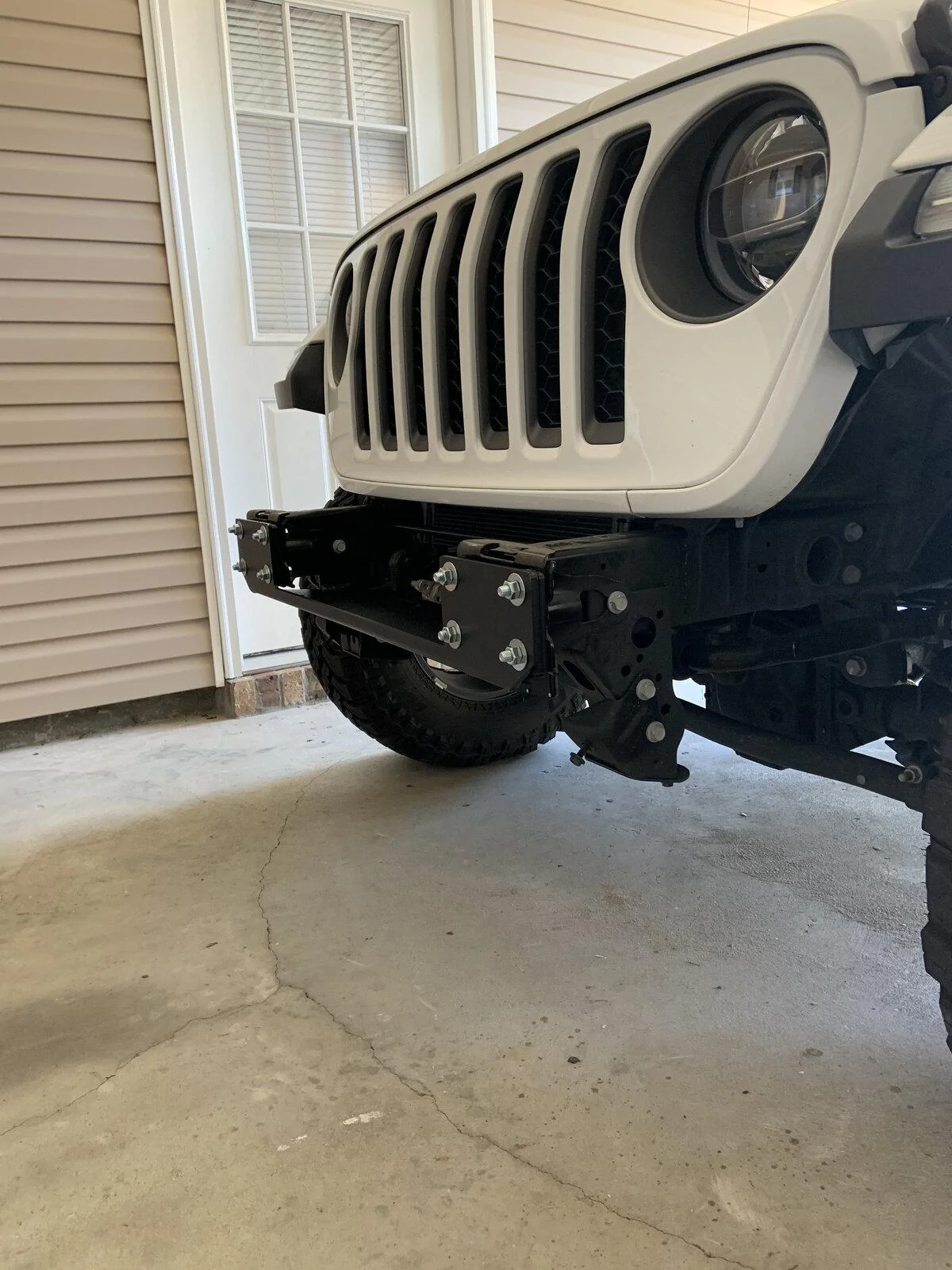

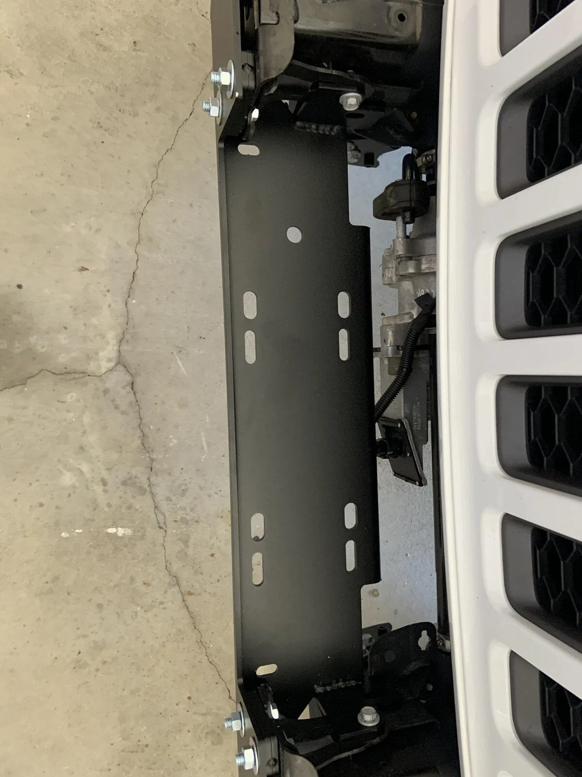

Install was pretty straight forward. Although tearing down the plastic bumper to get the fog lights was time consuming. Just a lot of small fasteners. The eight bolts holding the bumper to the frame are A PAIN to get started. An air or electric ratchet is must for the install, since there is no room to move regular wrenches. I used a pick up magnet to help position the washers and nuts. The Rubicon skid plate fits with no modifications too. Only thing I couldn't reuse were the red tow hooks.
Just need to finish the wiring for the winch and decide on some aux lights.
