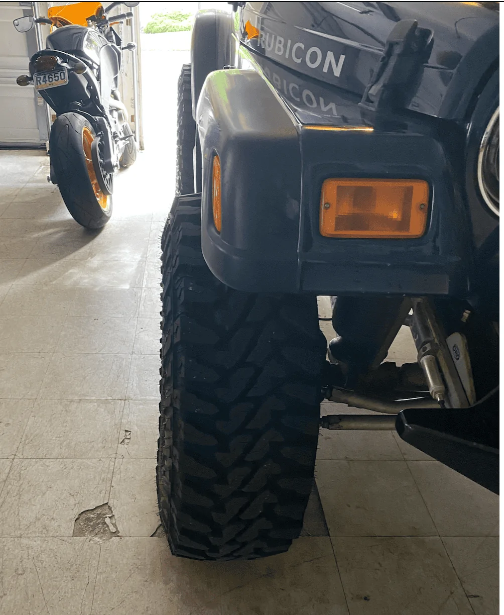

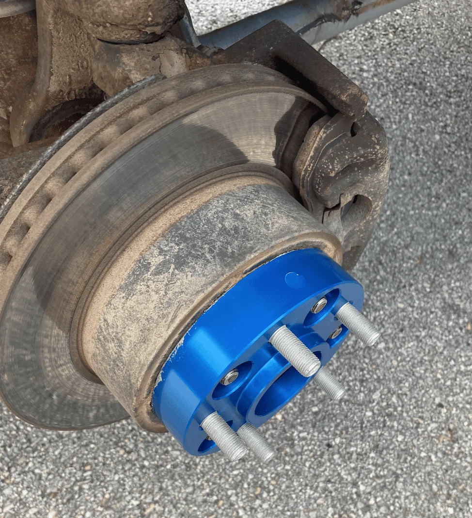

Not 2" but these are 1.25" Spidertrax spacers
Jeep Gladiator Looking at spacers 1643594333141
On a Rubicon

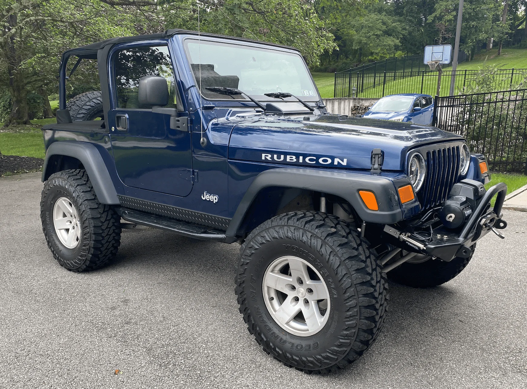

Jeep Gladiator Looking at spacers 1643594428724
with stock Rims
Jeep Gladiator Looking at spacers 1643594525437
But not a JT. :like:
