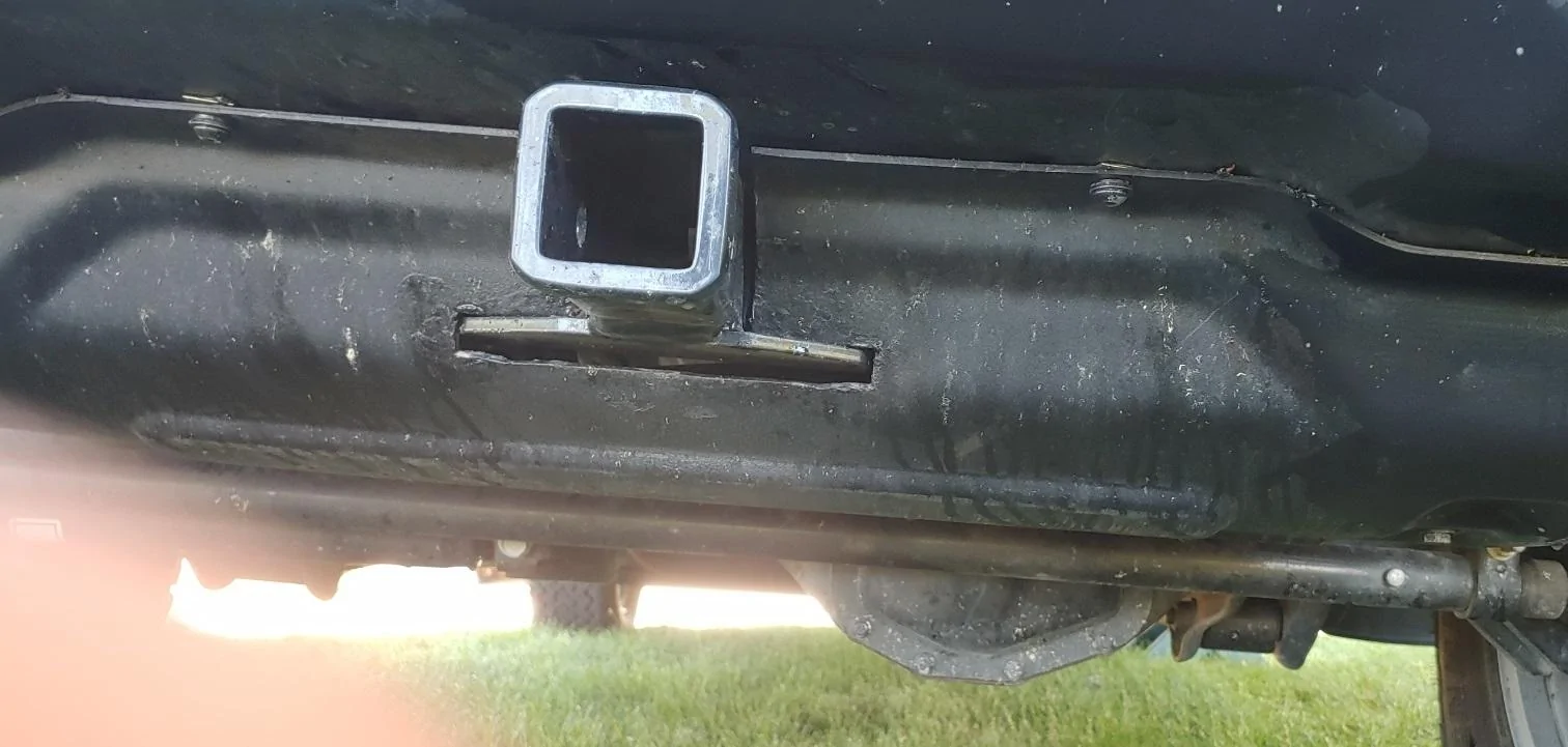

EXACTLY! Yes cut about like that , you lose a bolt but after painting the cut piece and putting it back on the hitch frame it rests against the hitch frame edge locking it in solid.....Jack

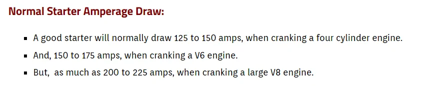

Here is one site's "estimate" or rough numbers on starters ->

So cranking a V6 might draw 150-175 amps and you exceed that with your winch pulling only 4,000 pounds.
Like I said - you'd better not be pulling twice as much when Jumping a 3.6 or similar or your starter is shot. I've got a smaller cable going to my 4.0 starter than I have on my winch.

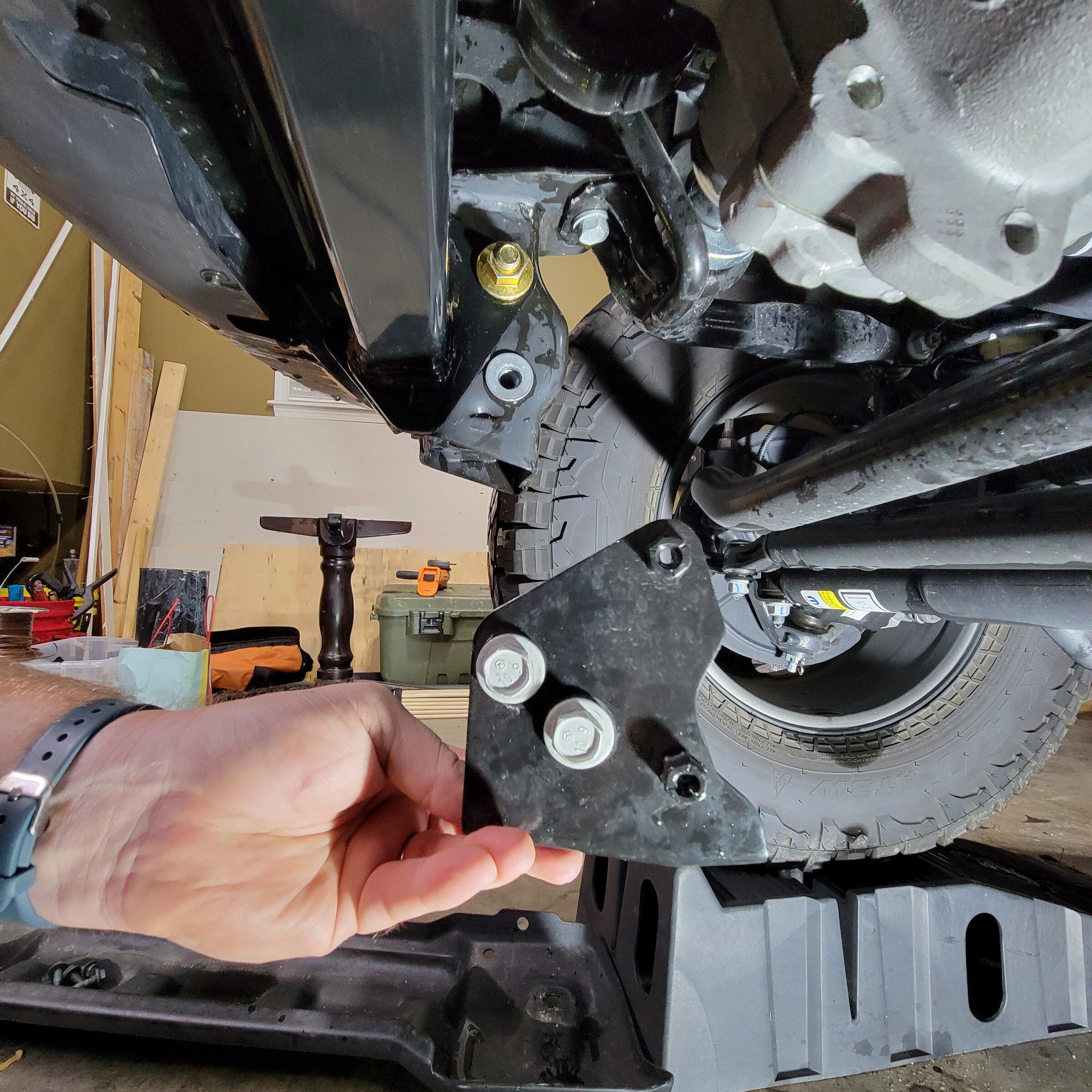

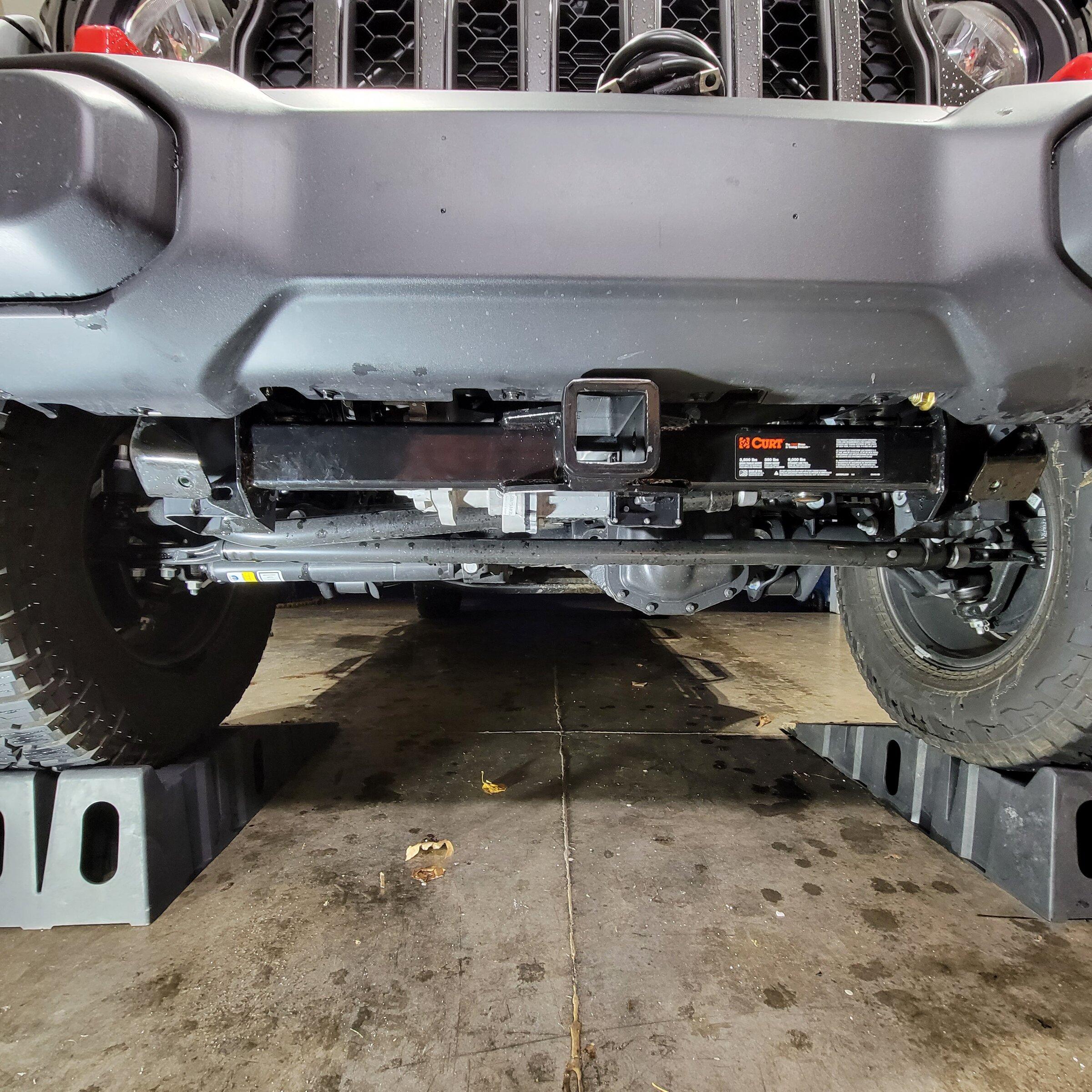

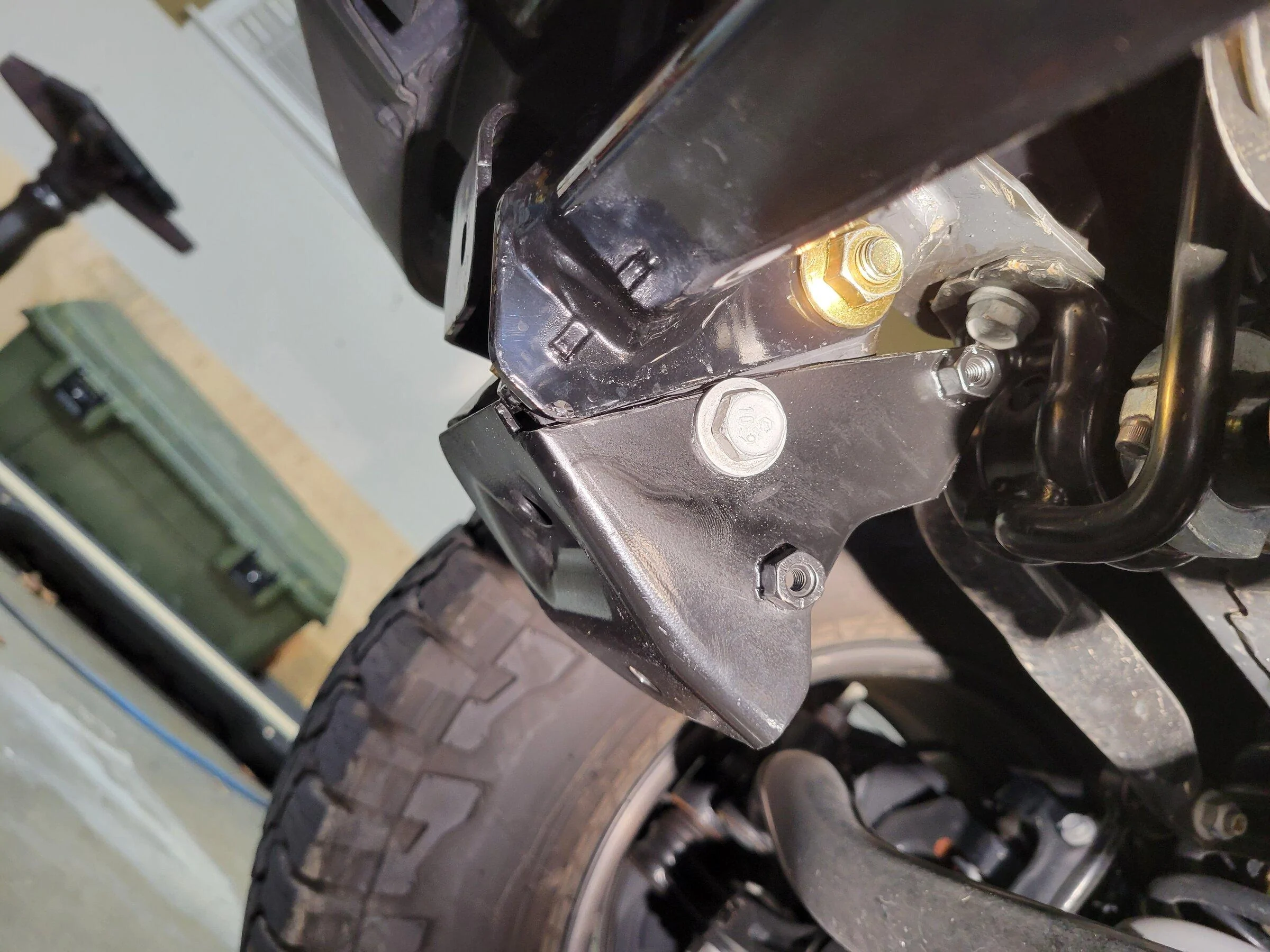

I'm installing the Curt on a Rubicon right now... (I am not a skilled mechanic) The receiver is in and not touching the sway bar disconnect (I need to test disconnecting), the bottom skid brackets are cut and look good, and working on cutting the skid plate, that sucker is thicker than I expected! (Cutting it is not looking great, but it will do). I'm still trying to decide what to do for wiring :)
Oh, heck. It's not even CLOSE to the disconnect. And it won't be as all it does is slide a sleeve inside to let each end rotate independently inside that case.
Yeah, you did similar to what I did on the skid plate brackets.
