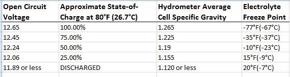

A full charge is 12.6 volts.
The system has to run higher charging voltages to "force" or push in a sense.
This chart is for more traditional batteries and not for AGM but it gives an idea if a person decides to buy a cheap battery and use it for a winch.
(this is from a GM factory training course I took when I worked as a tech)
Jeep Gladiator Looking for input on an idea for a front receiver hitch for a winch. battery-chart
Your chart just reminded me that dead batteries can freeze and crack. I had that happen once when I was a kid. I killed my battery trying to start a car that wouldn't fire and that night my battery froze. I can't remember if I was able to jump the car, but remember it eventually leaking and not taking a charge. ha.

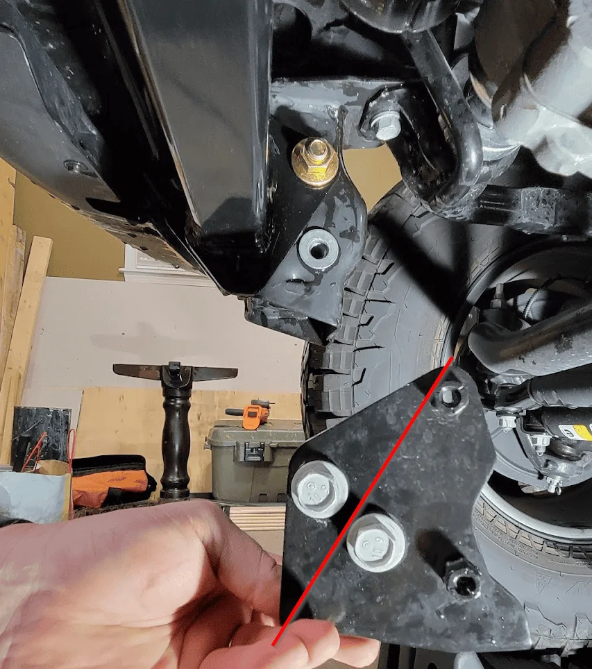

Had to cut an angle across remote shock res mount, as the Curt hitch used one of the holes but cutting the res.
So did you end up cutting it straight across like this, or something different?
Jeep Gladiator Looking for input on an idea for a front receiver hitch for a winch. 1641183387459

EXACTLY! Yes cut about like that , you lose a bolt but after painting the cut piece and putting it back on the hitch frame it rests against the hitch frame edge locking it in solid.....Jack
