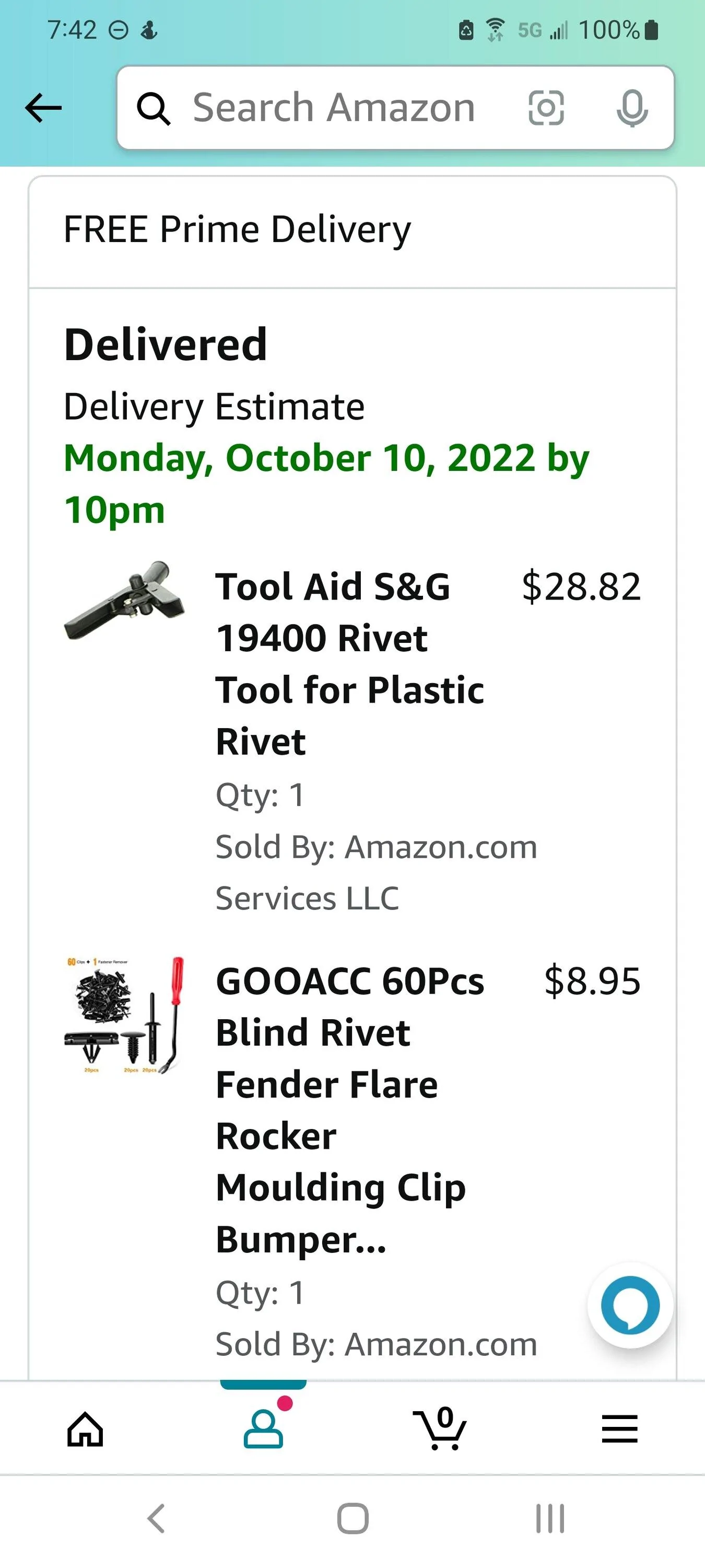

on a serious note! Picked up plastic rivets and a cheap tool at harbor freight to get a job done temporarily.
No joke- 75% of the rivets broke while installing, tool was equally as frustrating for such a simple tool…
Looking for some recommendations on a decent tool and where to buy decent rivets…. I could see buying these rivets in the 1-200 quantity….
Thanks in advance!

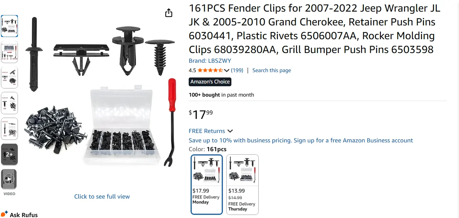

Amazon sells a kit filled with all the necessary Rivets and Fasteners for $14
I just use pliers to pull the rivets with a flatbar body tool to hold the rivet in place.
249
40,587
54,251

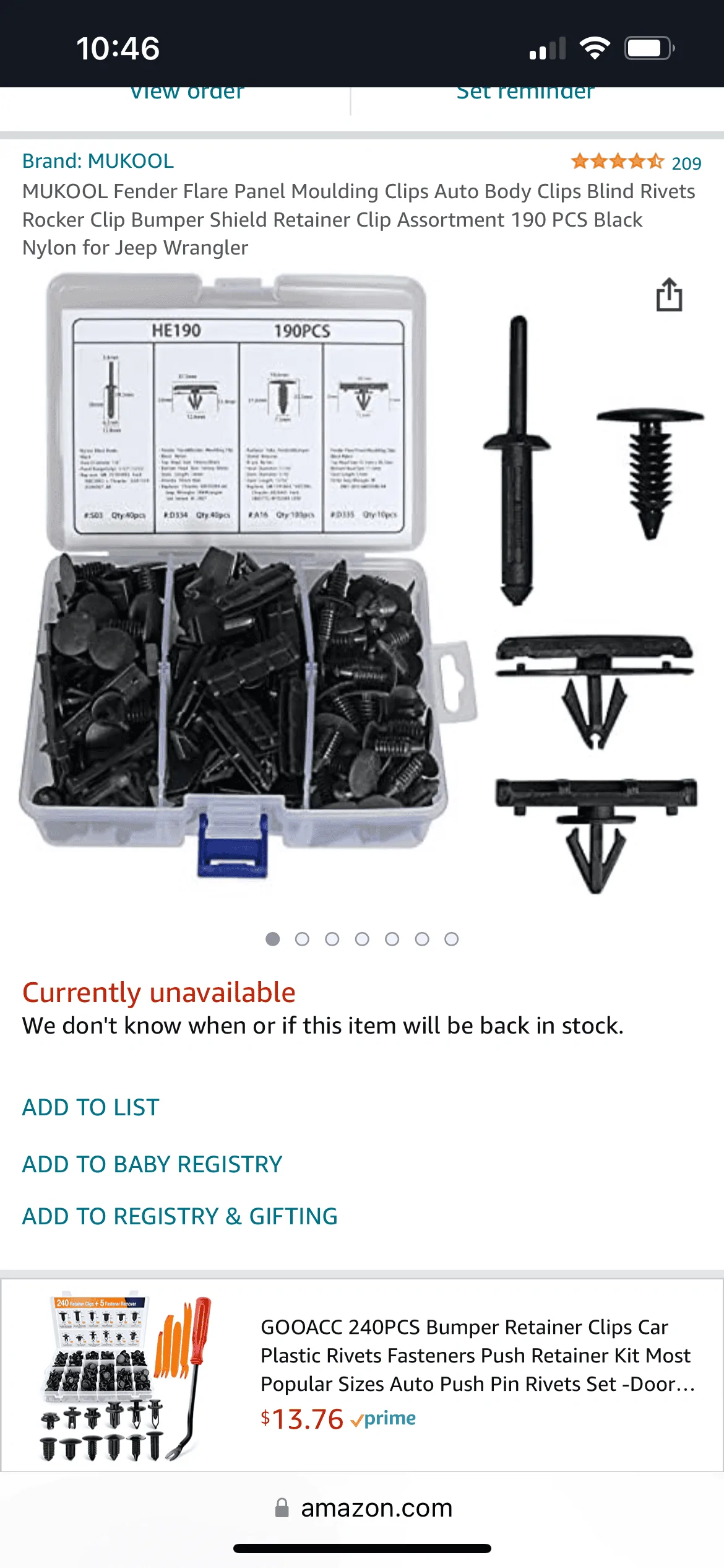

This one is out of stock but look for something like it. This one was $14.99
That's what I was thinking about - that has all of the clips used to hold the fender liner and the fender itself in place. And the POM rivets used in the fender liner and other spots (like the steel bumper)
Perfect.
IMO, anyone who does even "some" of their own work on their Jeeps should have those parts.
I have most of that stuff just because I've worked on cars for decades, and do restorations and such. The only things I was lacking were the specifics - the POM rivets in Jeep sizes and the clips that hold the fender to the body. Those can be removed and re-used. You can reach up under behind and squeeze the fingers together and they'll pull right out except the one to the rear.
The flat top christmas tree type I had already as they've been used for decades on interior panels of cars. I have a small plastic drawer of them.
Anyway, that's the exact thing every Wrangler and Gladiator owner should have.

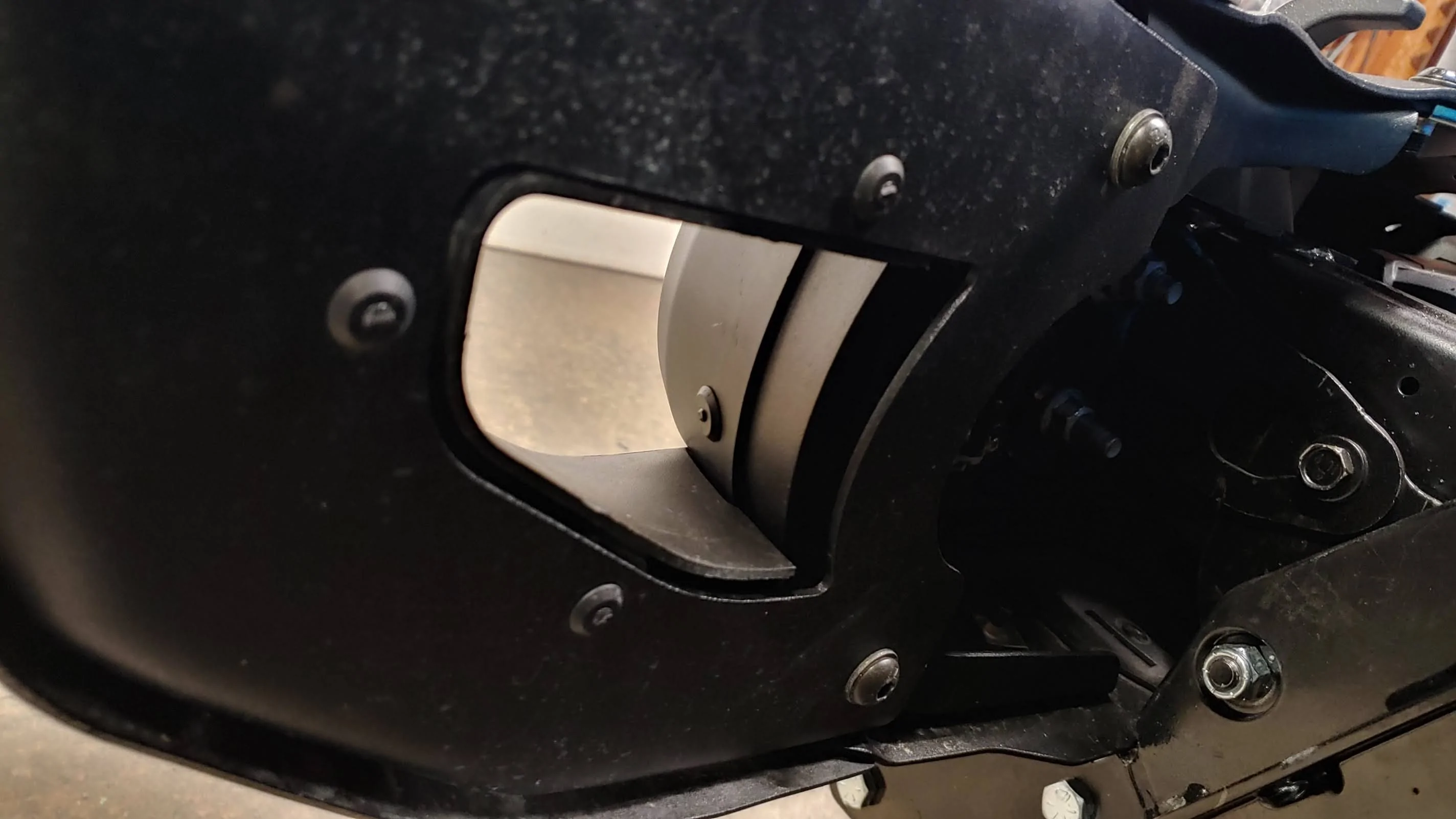

The HF gun works, but I got my rivets from Amazon after trouble with a few of the HF rivets. Plus, HF is a bit of a drive for me. The heads of the Amazon rivets are a tiny bit smaller but they work great. I used them to install my splash guards and replace one of the rivets holding the fender liner in.
https://www.amazon.com/gp/product/B07D6JXC4Q
Agreed. I recently removed and reinstalled (not replaced) the right front splash shield. I used the (plastic) POM rivets provided with the hand riveter from Harbor Freight. Other brands might have a POM rivet that matches the (expensive) OEM replacement POM rivet, but, in terms of appearance, the provided POM rivets are either a perfect match or look good enough for the difference not to be noticed.

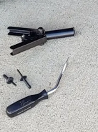

This is mine from 2020, and I have an assortment of door panel tools from the 70s and later that work great for the christmas tree clips - the one in this pic slips under the head and lets you pry it right up. I didn't even have to buy tools for the jeep clips - already had the door panel and other trim tools.
For 20 bucks, no more often than most people need such things, it's a cheaper alternative and works just fine.
