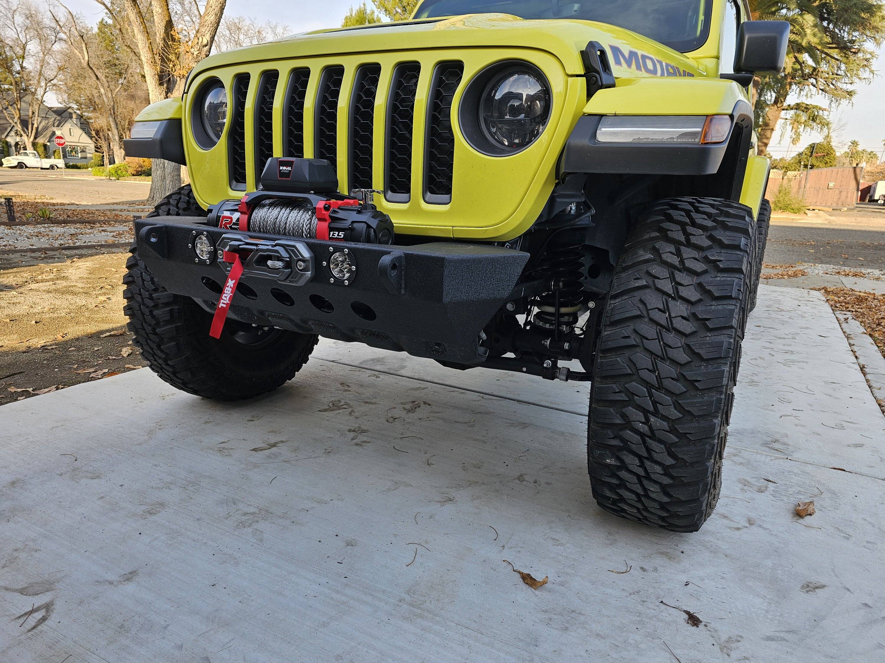

Damn that's ugly. Why do I want 2 sets of tow hooks right next to each other? My entire bumper was only $100 more than that, looks infinitely better, mounts the winch lower, is way stronger than the plastic garbage, has better approach angle, and proper d-ring mounts that are far safer than the open hook style recovery points.
