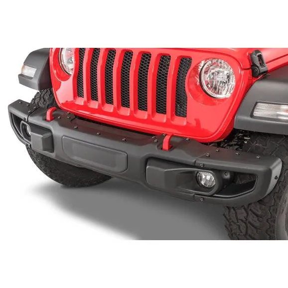

Here's a breakdown:
Rubicon: gets steel rear bumper standard, front is a standard plastic bumper but can be ordered with the optional steel front bumper. If it's steel it'll have a bunch of bolt heads sticking out of it and the left right side wings are removable.
All other trims get plastic front and rear bumpers EXCEPT the sport/sport s freedom edition that gets the steel front and rear bumpers.
OEM steel bumper shown in pic, note the bolt heads.

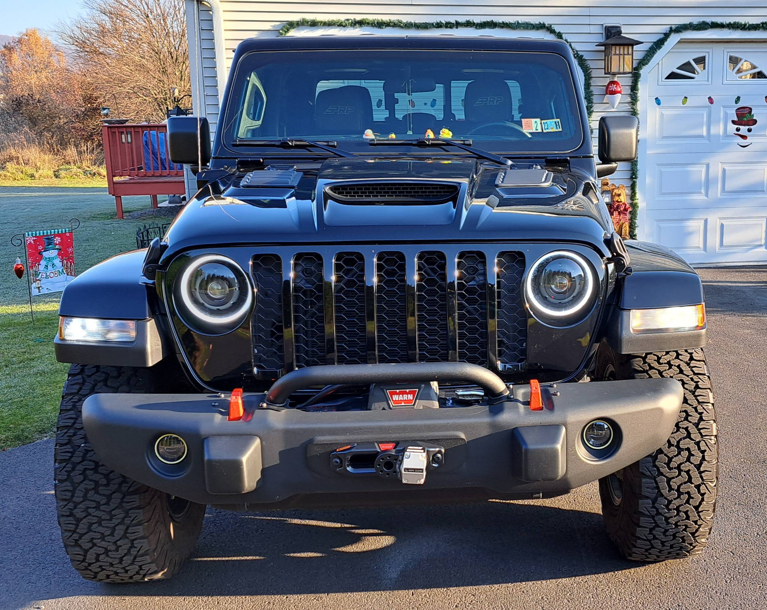

Replaced my plastic bumpers with steel.
The front is Mopar's off road bumper and the rear is Rubicon steel.
I really like that Mopar Performance front bumper , looks more finished then the bolt together version and is narrower then the steel or plastic bumpers, if you don’t take off the ends. Plus front shackle mounts are nice.
Your Jeep looks great!…..Jack👍🏻
Thanks
The sucker is heavy plus it comes with Mopar's 10 year corrosion warranty.
