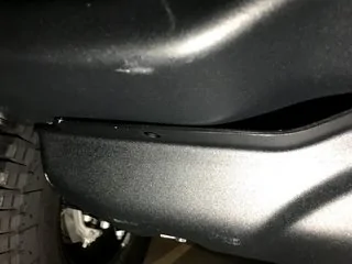

The skid plates are different. You need to get the one for the steel bumper. The brush guard tube is 2".This is a great post and I'm about to order my parts.
Two Question though.

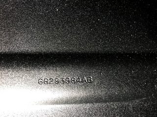

#1 - My Rubicon came with the Plastic Bumper w/ LEDs and a metal Skid Plate. Do I need to get the Skid Plate you show as part number 68293984AB or can I just use the one I have? Looking at your photos it looks like your new Skid Plate has fasteners holding it to the bottom of the bumper whereas my existing steel Skid Plate does not have such holes.
#2 - I want to order KC Spot Lamps to mount on my Brush Guard. The adapters are sized to the diameter of the bar they are mounting on. Can someone please confirm the diameter of the Brush Guard Bar?
Thank you,
The skip plate I'm using is part number #68293984AB. It's almost as this oem steel bumper is completely different
