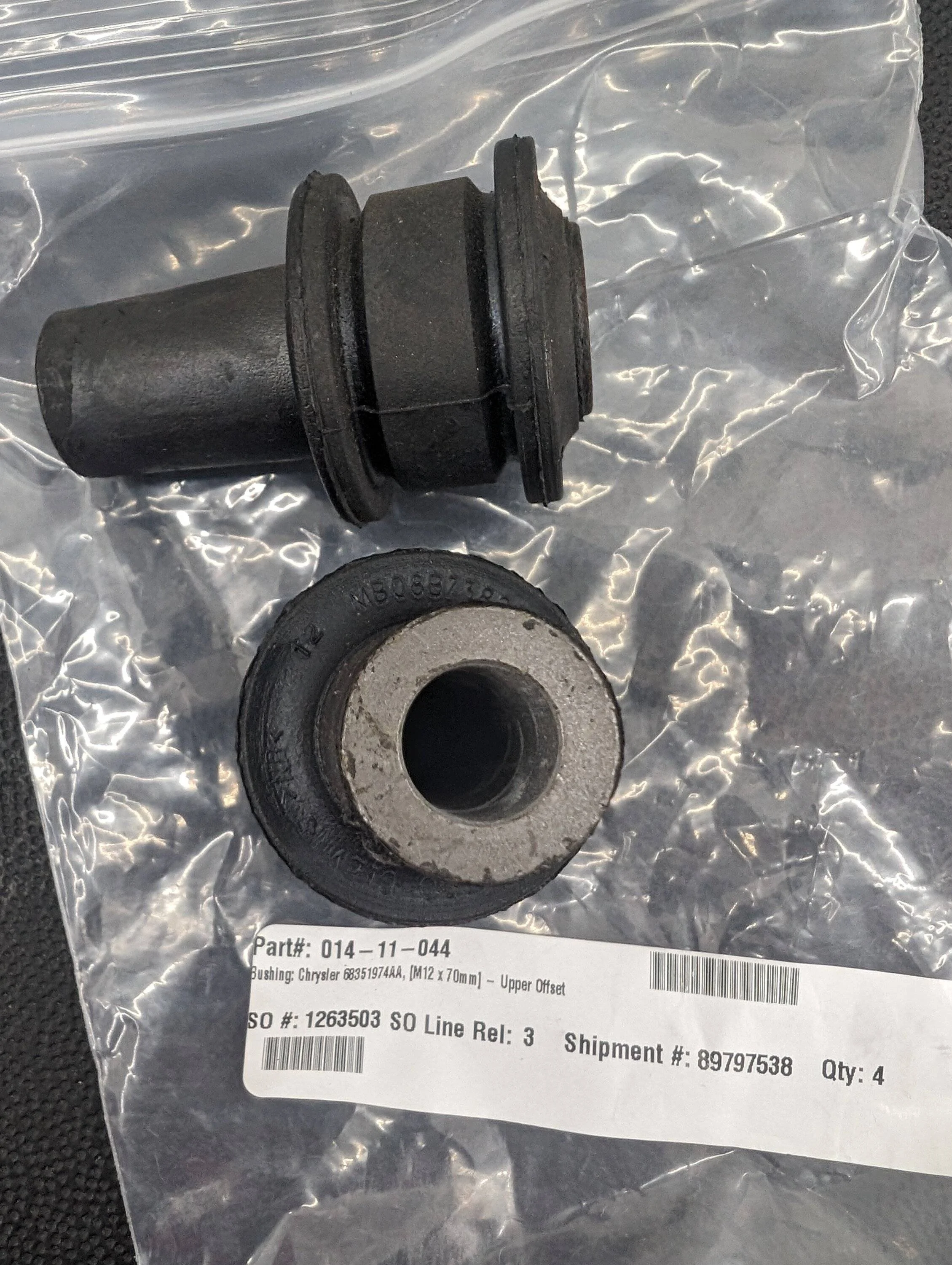

For anyone wanting to put Mojave shocks in your Sport or Rubicon.. Fox sells the Top Front Bushing for the shocks (about $8 each if I remember correctly) Part Number 014-11-044. For the bottom of the front shock open the hole up to 14mm on the axle mount.
These bushings are a PIA to press in. If anyone gets them in without chewing them up let me know .. I had a hell of a time getting them in. I put my Mojave shocks in my wife's JLU.
Other people have noted those are impossible to press out/in. The sleeves are easier and can revert to stock later :whew:

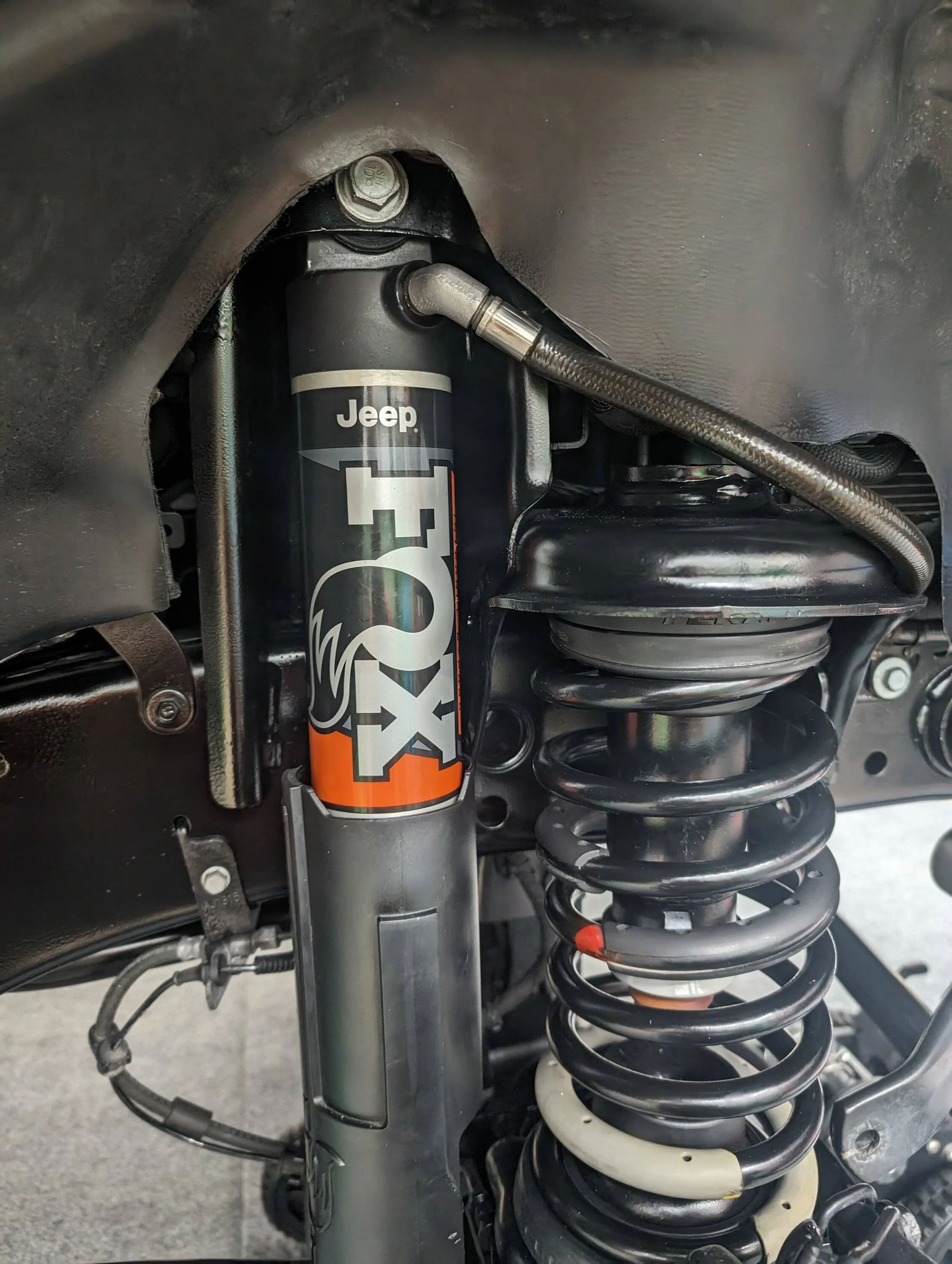

I have done it, just a pain in the ass... Here is a picture of the Mojave shock with the new bushing in my wife's JLU. People can use make shift sleeves if they like, but I prefer to use the correct bushing.

For someone reading through this and swapping Mojave shocks, this is a good thread to go through:
https://www.jeepgladiatorforum.com/...taining-the-factory-shocks.42815/post-1086235
The hydraulic bump stops do not raise the jeep at all. They will however decrease the amount of uptravel until the bumpstops hit. I'm not familiar with the Fox ones so I'm not sure by how much (something to check), just like if you did the cheaper Teraflex foam/spring ones.
I used similar to these 12x14x20mm sleeves over the bolts so I didn't have to drill anything.
https://a.co/d/cSO1RKZ
Thank you so much for posting this link! I hated the idea of making my own sheet metal sleeves while in the middle of this suspension swap. These will make the swap so much faster and easier!
