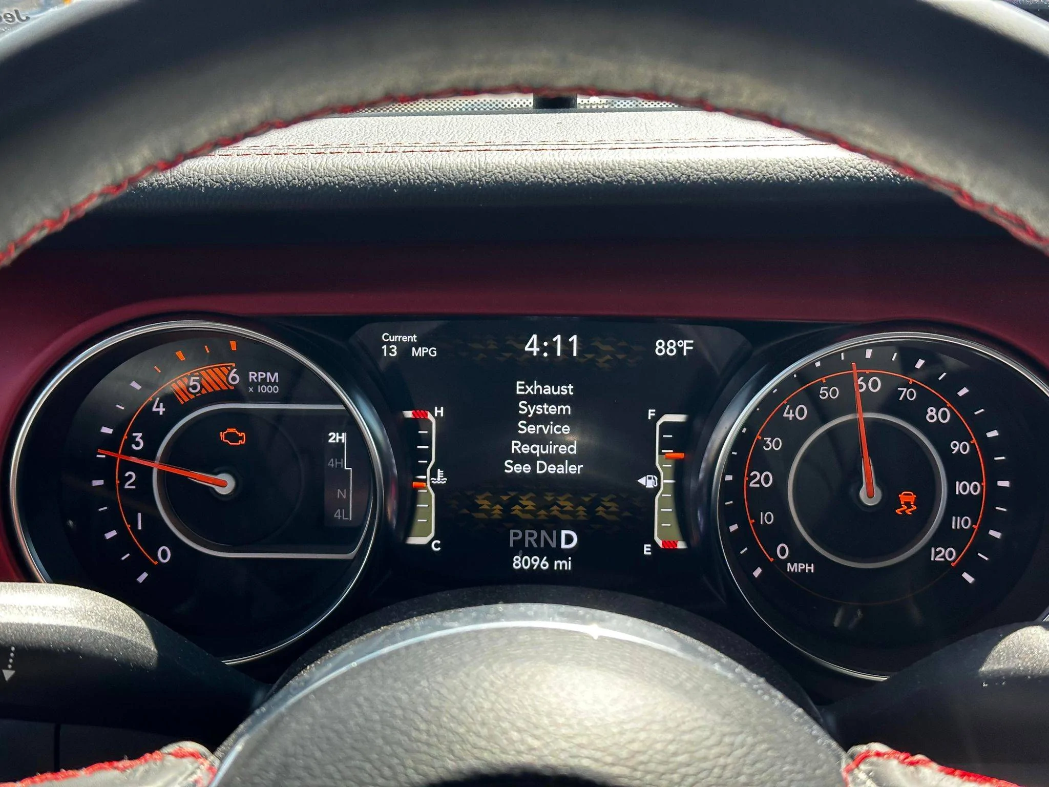

I dealt with service electronic throttle and service exhaust system messages last year during my cross country trip while towing my camper. For me it turned out to be a cracked DPF. From what I saw, the service electronic throttle is basically limp mode.
