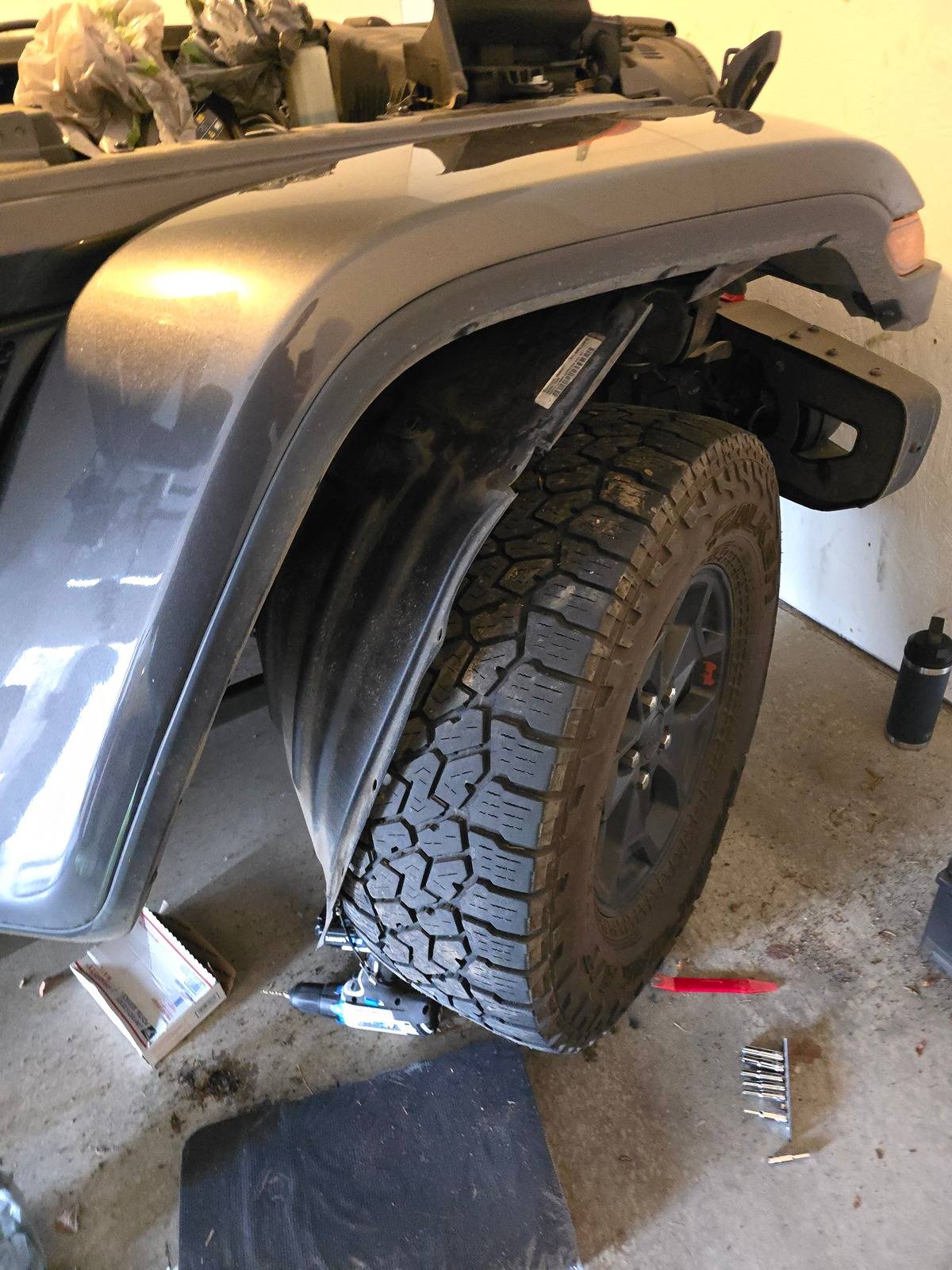

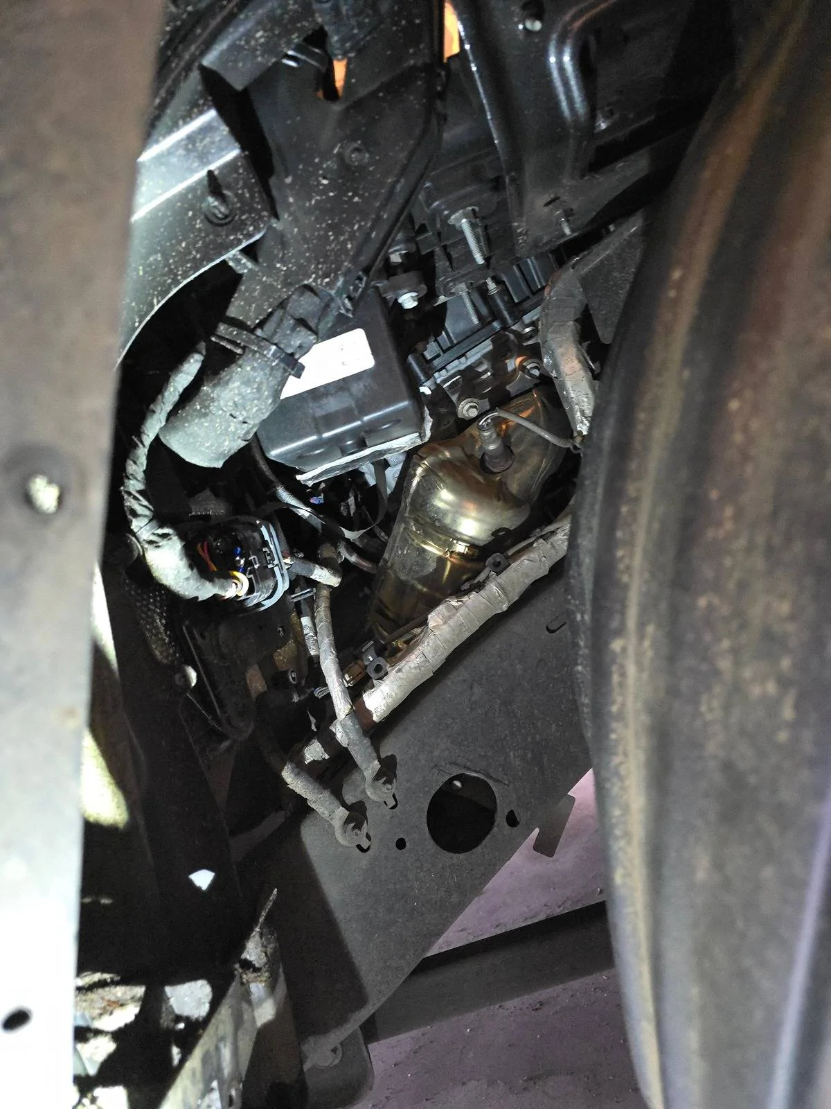

Hello everyone, I replaced my main and aux battery today and thought I would post my experience and any tips i might have.
To start, my ESS has not worked for about a year. The dash always says "ESS not ready battery charging". Recently I started getting a message on engine start saying "Aux switches unavailable battery charging". So I knew my batteries were on the way to the grave. My truck is about 4 1/2 years old now (with 60k miles) so the batteries did last a good while.
I decided that going through the wheel well would be the easiest method for me. I only had to remove 1x10mm bolt, 4 push pins on the fender liner and 3 plastic rivets. I did not remove the whole fender liner, I just removed enough attachments so i could access the aux battery. For this process i just had the wheels turned as far to the left as possible.
It was super awkward to get to however was doable, id probably just recommend taking the wheel off if you have a jack and stand.
For the plastic rivets i just used a tool from harbor freight that included the right size plastic rivets. 6.3mm. Link to tool
The rivets you will either have to drill or kind of push out in the center. I also had to buy some of the push pins for the fender liner as they really weren't useable after removal, Oreillys had them in stock. You will need a 4 inch extension to get to some of the 10mm bolts so keep that in mind.
As for the batteries them selves I got both of mine from Oreillys. The super start platinum aux14 battery and 94r size battery for the main. After hooking both batteries up it started first try. Some of the infotainment settings did get reset but that only took a minute to re adjust to my liking. The back and front cameras don't currently work (I just get a blue screen) but I believe after a few cycles and some time they will come back online. Overall it wasn't too bad of a job, def worth doing yourself to save a few hundred dollars.

Remember to tape off and insulate each of the two battery grounds during this process.
What do you mean? Like cover them during the change so you don't short something out?
You just need to make sure none of the battery cable ends touch against each other or against anything metal in the engine bay while changing the batteries.
When I changed the Aux battery in my sister's Compass last week, I used some plastic bottles and cups to put over the end of each cable as I disconnected them.
Yeah I didn't mention it in my post but I just put some thick grocery bags over each one, you can see it in one of the photos
