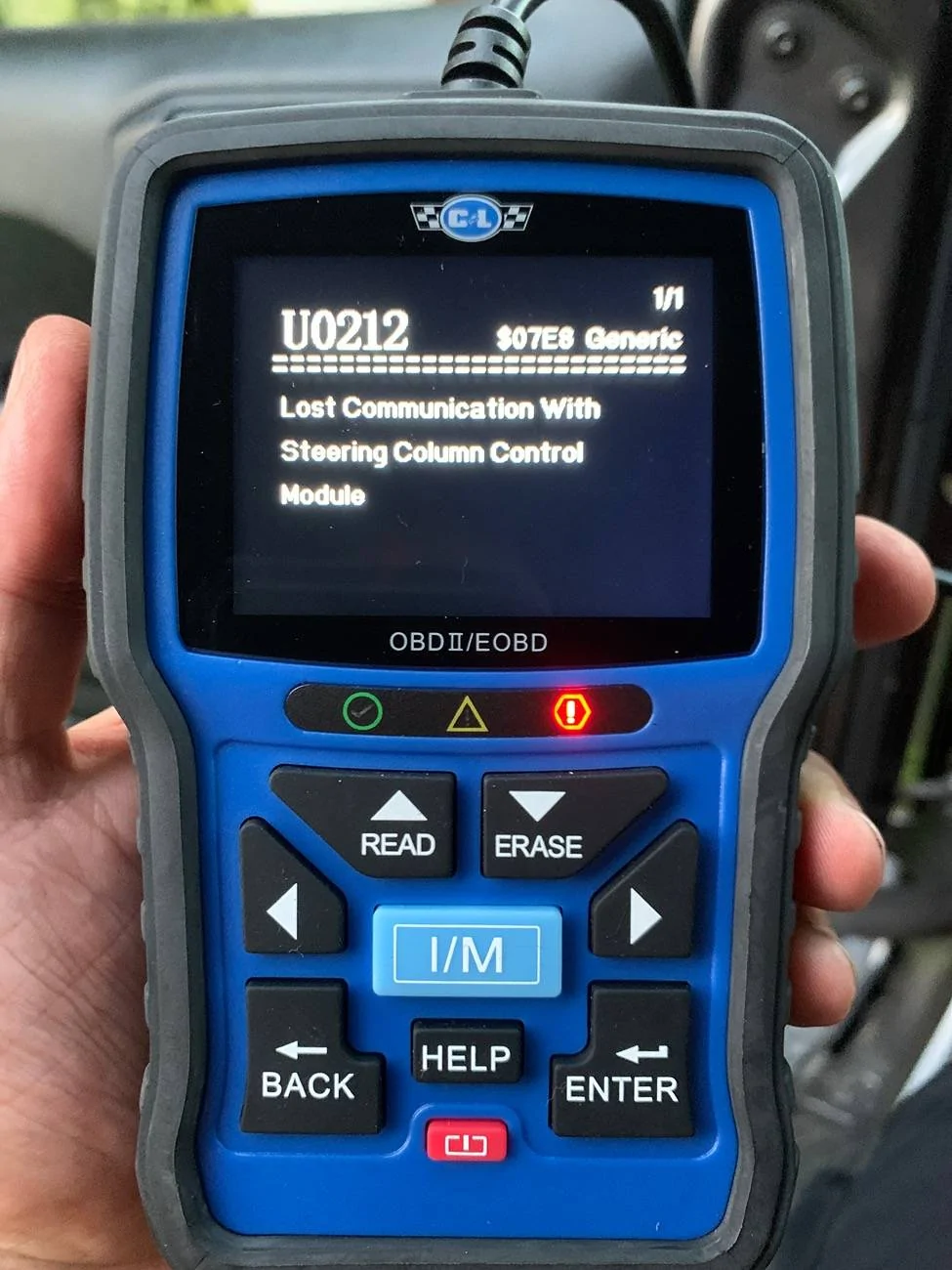

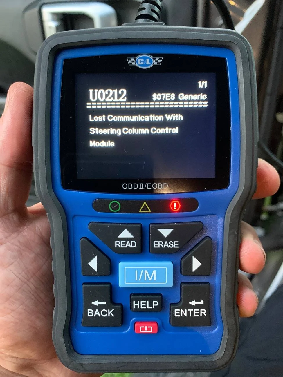

Still no luck… so I bought a code reader and it came up U0212
LOST COMMUNICATION WITH STEERING COLUMN CONTROL MODULE
Only one code. Going to look into it. Anyone else had this issue?

I got the same code U0212 Steering Column Lock module. Dealership replaced module. Light set again. All started after I replaced my drivers front fender regular/clear 7443 bulb the one filament was burnt out. Could be a coincidence. Could be a ground related between the two don't know yet. Gotta dig through wiring schematics to know.

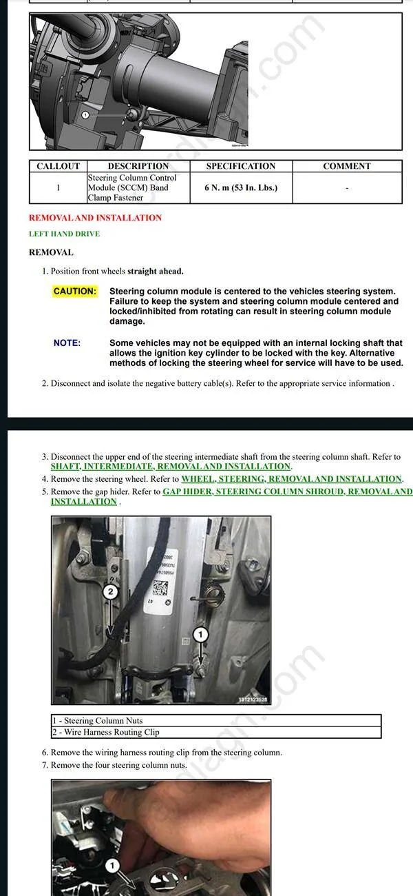

So dealer still hasn't really looked at this properly on mine. They keep clearing the code and kicking it. There are two harness' one inside the steering wheel itself and one that goes down the column. Column is a known pinch point in every vehicle. harness in steering wheel can be depending on routing.
Other possibility is improper installation or assuming vehicle is centered. Seems like the sccm is a clock spring + module in one.
