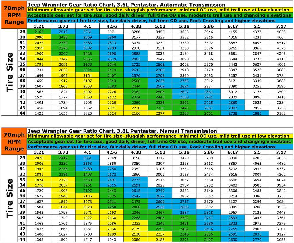

This chart may be helpful (top is Auto, bottom is Manual) on performance expectations regarding tire size, gear ratio, and intended usage.
I think those charts are for the JK. The JL has a .64 overdrive in 8th and the numbers are completely different.

I'd use 5.13 for 37s. RPM will be about 2,300 at 70 MPH which is perfect.
Definitely not 4.56.

Yep that chart is definitely not for the JT, on 37's and stock Rubi gears I'm running 1750 rpms @ 70 mph, can't wait for gear day!
This chart is helpful… it’s for wranglers so thinking I’m in a gladiator (which is bigger than the wrangler) automatic it seems the sweet spot (based on my driving habits) is 4.88. Thank you for this!
