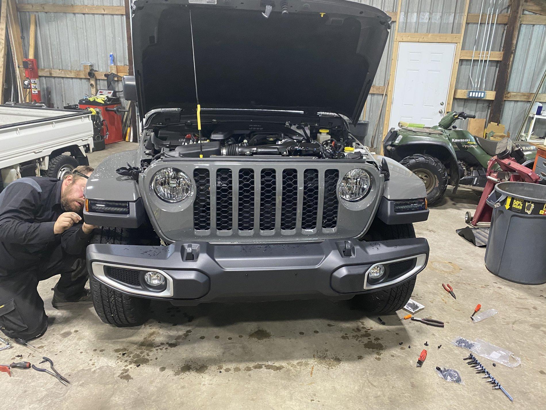

I just got these today for my 2021 Gladiator Sport S with Max tow. Replacing the stock halogens. Are these truly plug and play? They appear to be- has separate connections for DRL and turn signal. Anything to be aware of during install? No need to completely remove fenders?

I did mine almost a year ago...If I recall, they are direct plug and play. The hardest part was the double sided tape holding the top of the stock light to the fender. It is definitely easier to remove the fenders, but you don't have too. I was able to do one with the fender attached, but the second one, the fender sort of came off while trying to get the stock light out (too much force I guess).

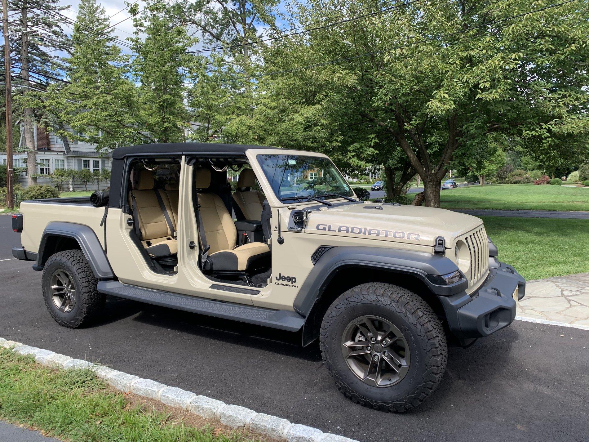

Can you post a picture of your truck from the side so I can get a better look at the wheels? What do you have for wheels, tires, and lift?
No lift, Quadratec 41 bronze wheels and BF Goodrich AT tires

install went great. Took fender off for 1st one then once we saw how it came apart second one was easy with fender on.
