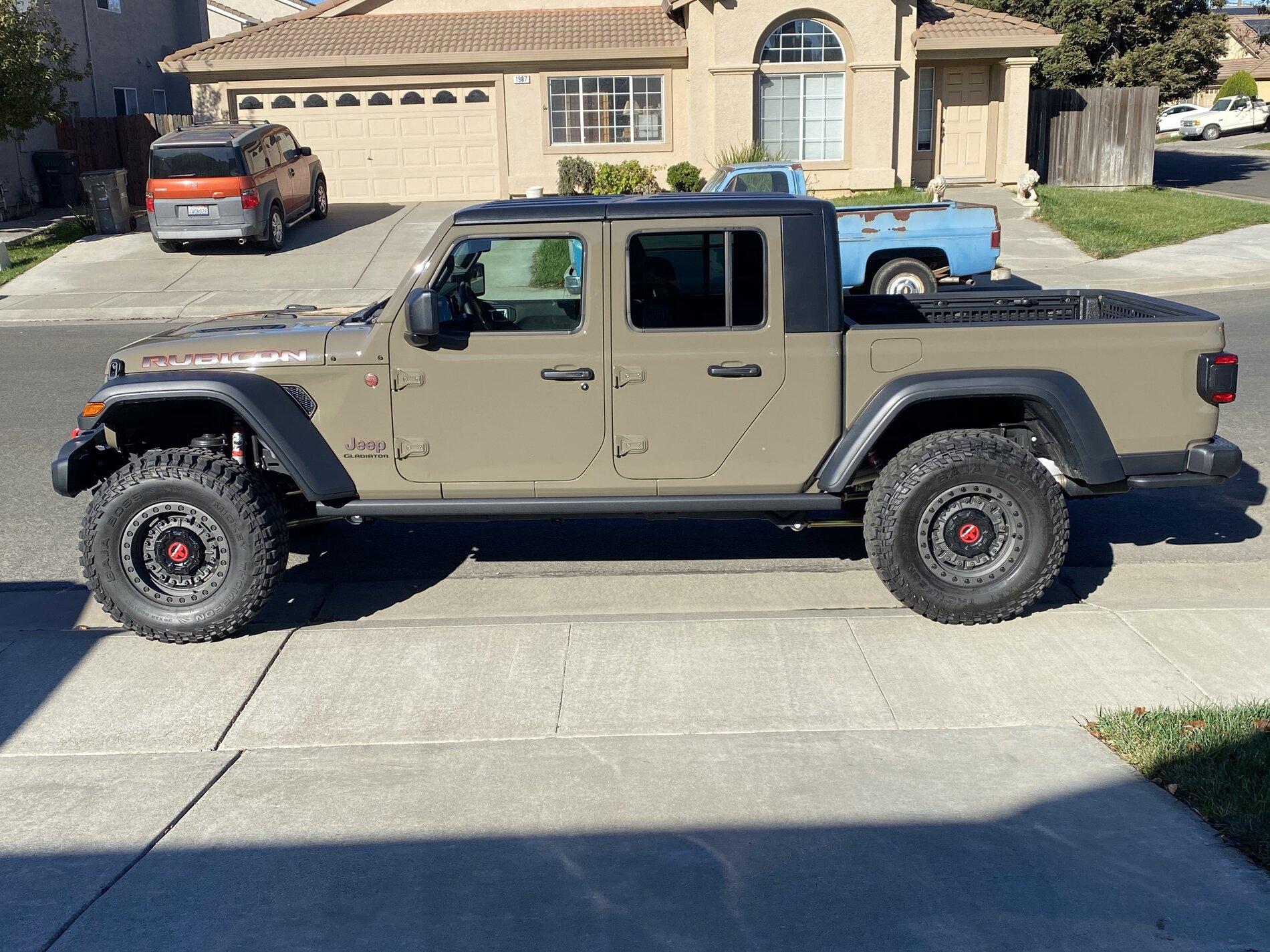

Metal Cloak 2.5” leveling kit. I chose to replace driveline just to get it done. If you aren’t going to wheel to severe and disconnect the sway bar you should be fine. With disconnected sway bar would take the chance.
Jeep Gladiator Metal cloak 2.5 "leveling kit" FBB52F41-F567-4968-89BA-308D567C0DEA

Looks good, those 35s your running? Anything done to the rear?

Yes, Baja Boss 35’s. No lift in rear.
