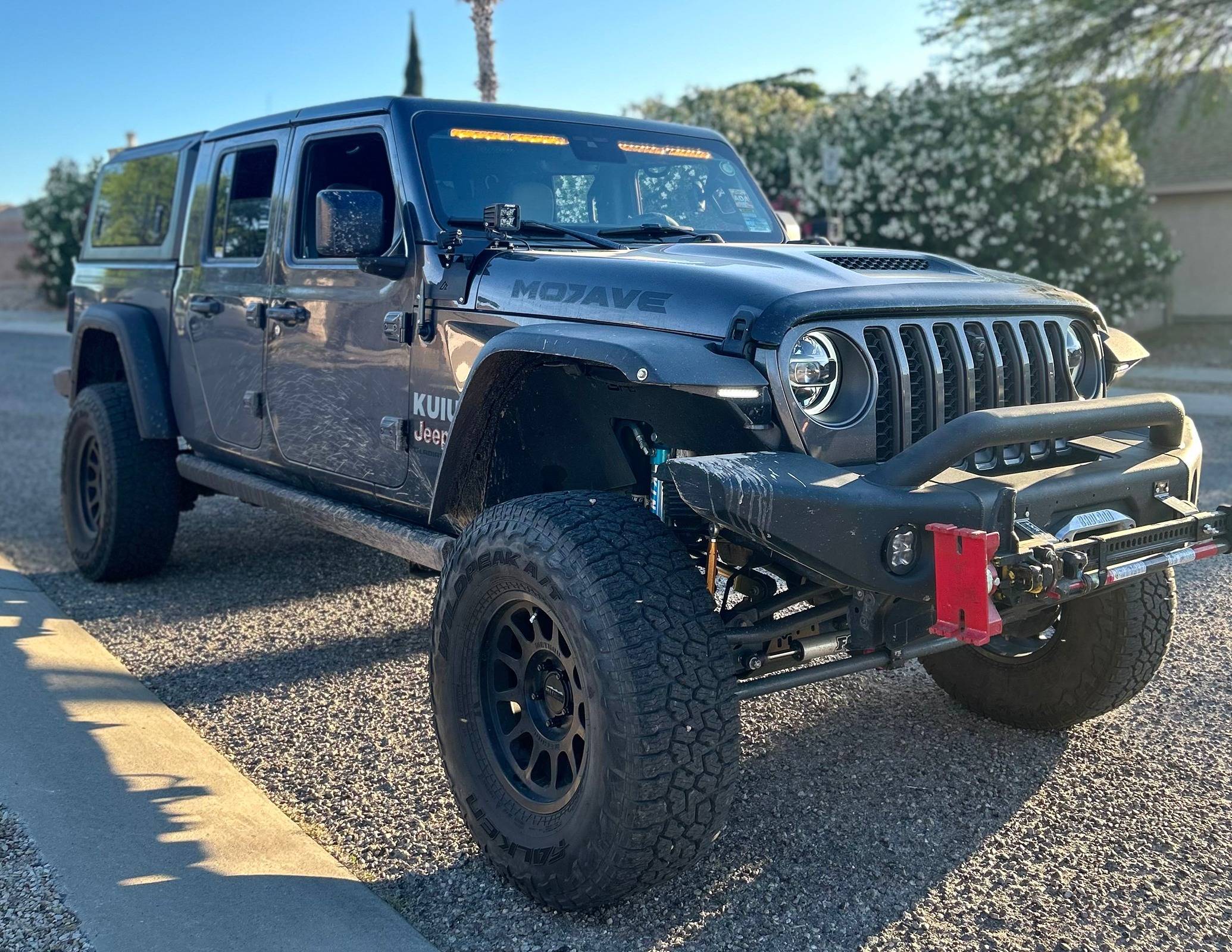

Looks like Trail 42. You must have been volunteering? I ran it on opening day. I’m so happy with the work they did so I joined TRAL.
Yes, volunteered multiple times with TRAL in the St. Clair area. Plenty of fun trails, but 42 is the best.

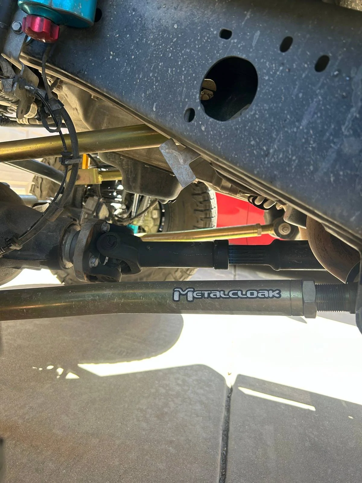

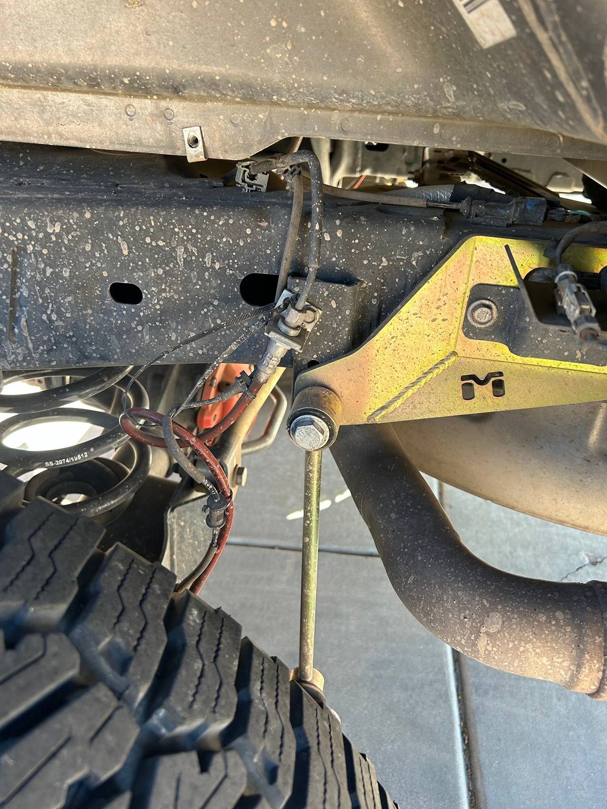

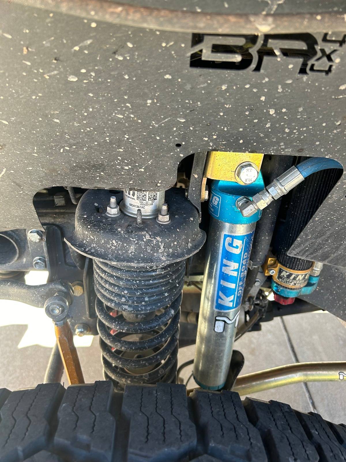

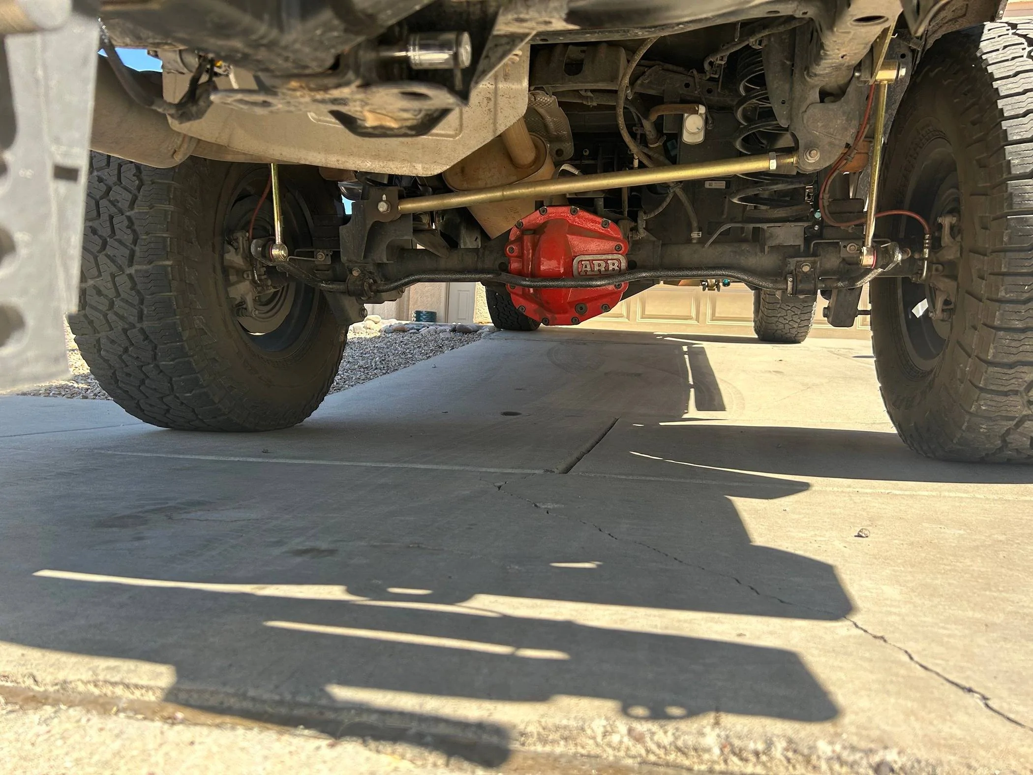

love the rig! I am looking to do the same thing MC lift with my Mojave. The fox shocks have run their course. What all did you need with install and everything. I’m all over the place not sure exactly what will be required to achieve the same, any info would be greatly appreciated. Thank you.
Here's what I'm running;
- MC Gamechanger 3.5 + Extended brake lines
- Synergy MFG Sector Shaft Brace
- Synergy MFG (i think 2 ton or 1 ton steering HD system)
- Synergy MFG HD Front Track
- Tom Woody Drive Shaft
- Evo Front Sway Bar Links & MC Rear Sway Bar Links
- Hellwig Rear Adjustable Trackbar
- 35/12.50/17 (Falkens / Methods beadgrips) + Powerstop Extreme Z36 HD Brakes
- Tazed the Jeep for the right tire size.
- Banks Pedal Monster installed to eliminate lag. Just city mode, nothing to serious.
I think that's all at the moment that I can think of. Oh yeah, I don't recommend the shock extensions with the fox shocks. When I first had the lift installed with those shocks, it rode like a dump truck. I purchased the Kings Evo Spec for the 3-4 lift, and adjusted to 8 clicks in the front, 9 clicks in the rear, and it rides like a charm. I should probably build a journal on here soon.

how do the Kings ride/dampen in comparison to stock Mojave Fox shocks when it comes to bumps/desert running/etc?
Thanks for the reply, Aleph!
The Kings ride pretty darn good going on washboard roads and over the speed bumps. If I were to reduce them one more click, you could be the shocks absorbing the bumps. I feel like that 8-9 clicks is just a smooch stiff perfect for those times of bumps and desert running.
Going out hunting on some rough roads in Northern AZ, I must admit, the shocks were a little bit too stiff, and it was somewhat of a rough ride. I never adjusted them for that hunting trip.
With the crappy AZ potholes / roads, these do perform top tier, for realsie. ?
