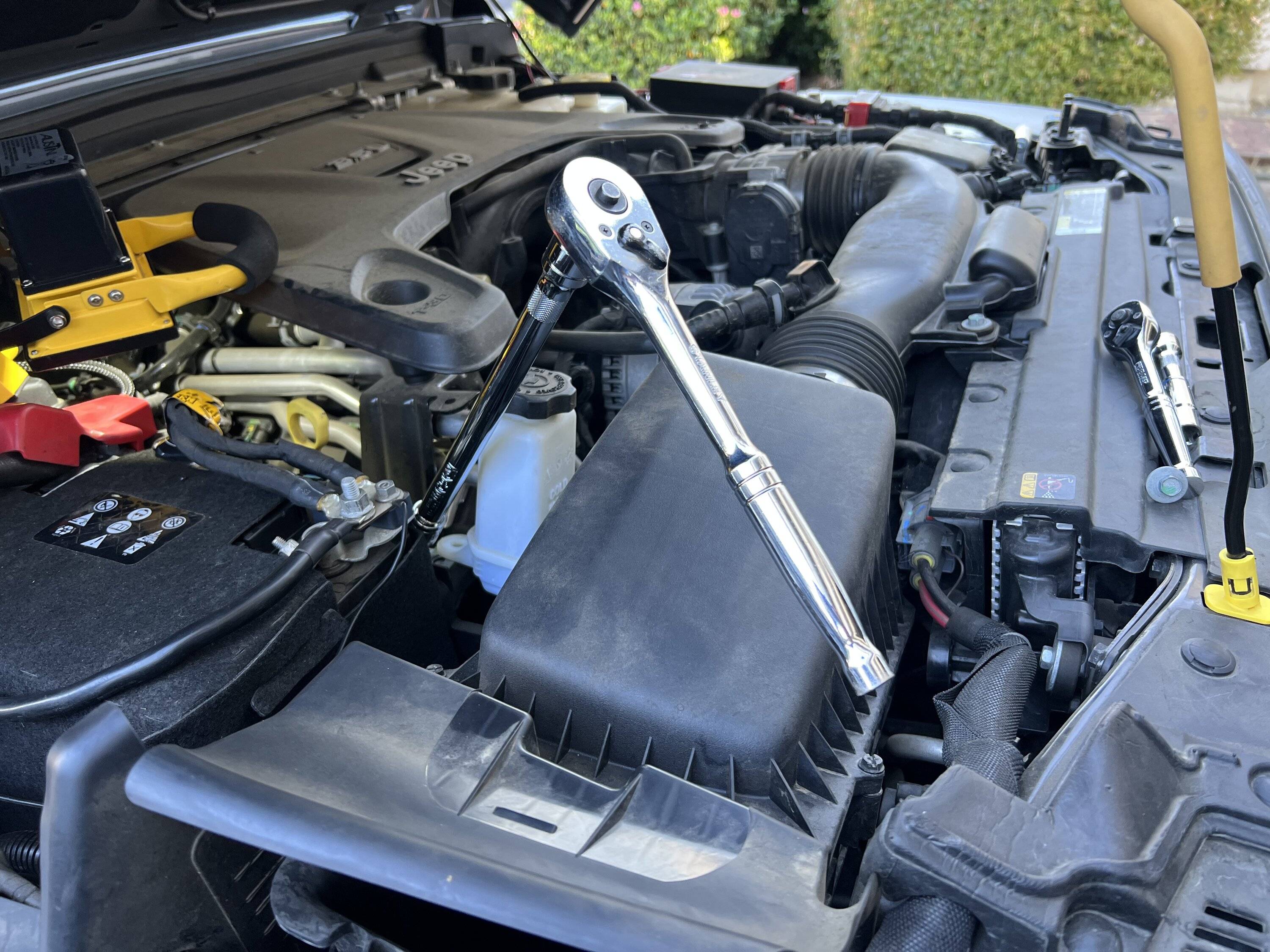

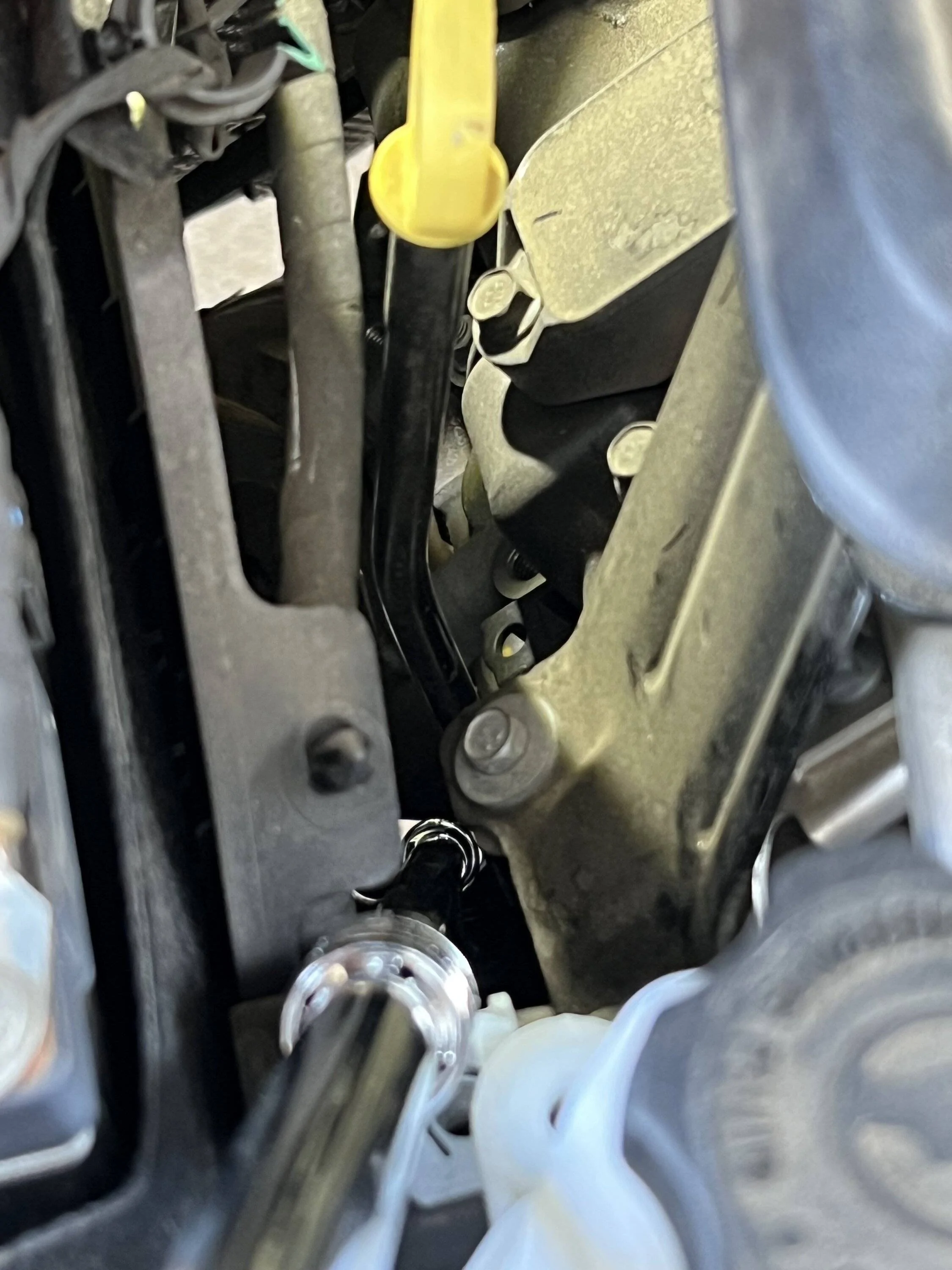

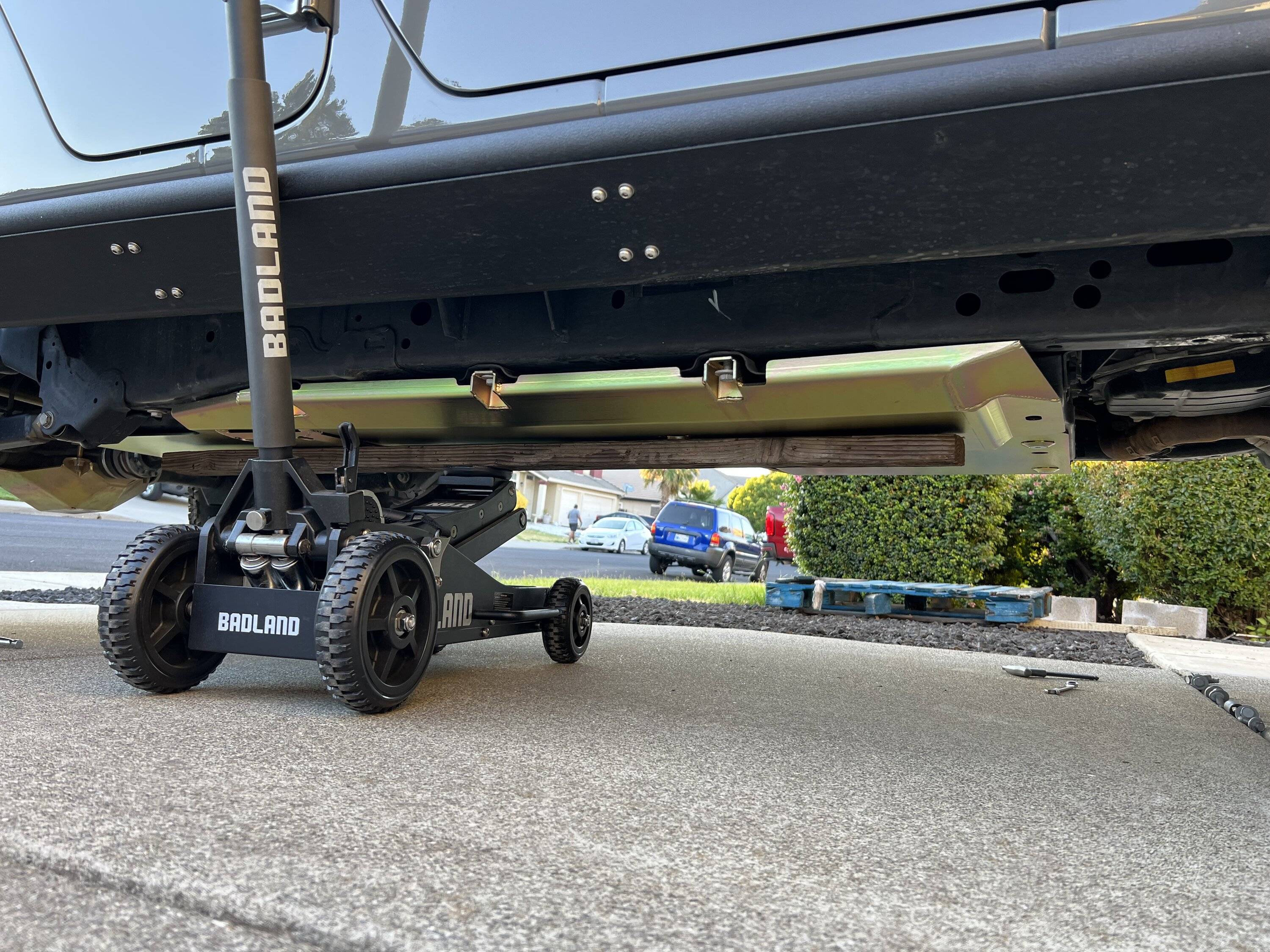

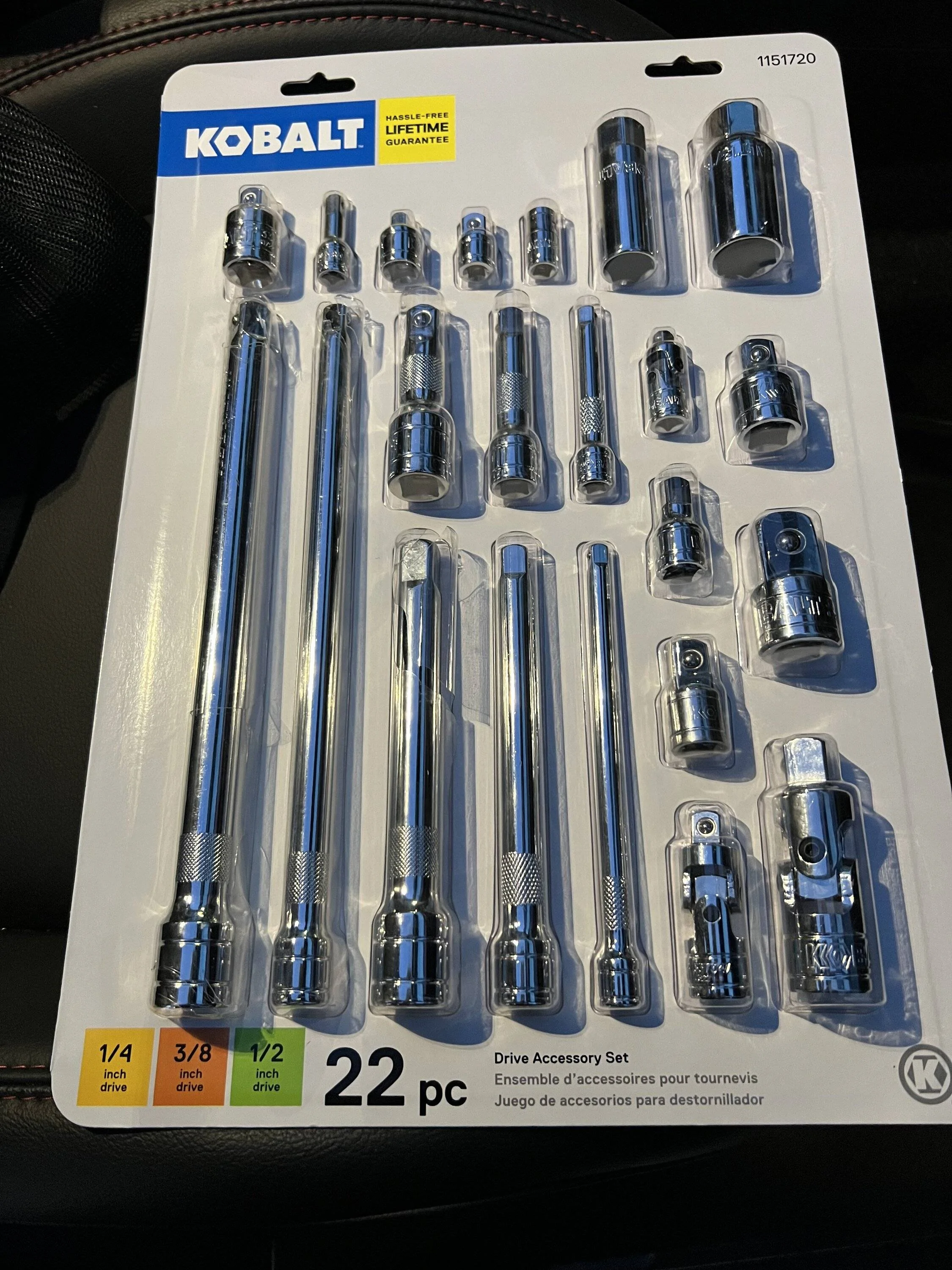

Installing the @Metalcloak skids. I didn’t have to drill the frame as mentioned in the instructions for the driver’s side. But I’m running Nemesis inner front liners so I’m having to wrestle at the motor mount bolts for the oil pan skid plate. I needed more extensions lol so I decided to just proceed on with the rear and getting most of the bolts secured but not tight. Went to Lowe’s and got a whole set of extensions for only $22 dollars!!!

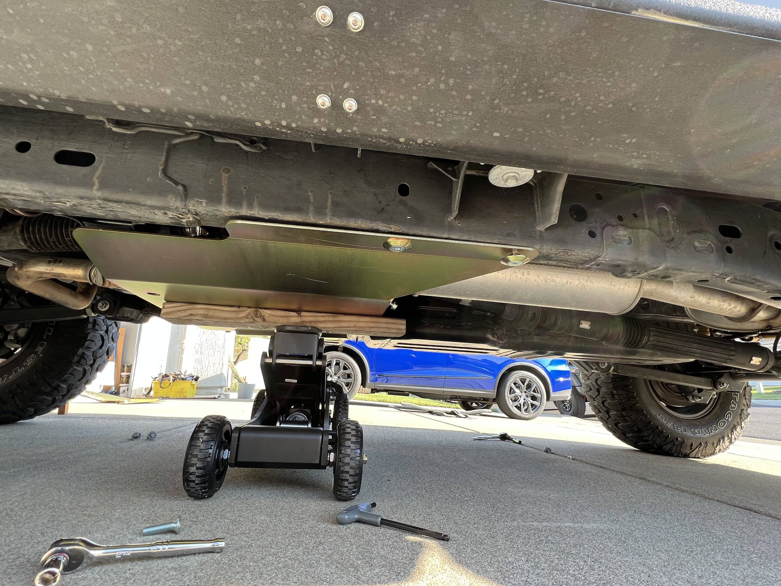

My suggestion is just use some 2x4 wood and a jack to lift and line up the plates. There’s no sense in trying to balance the plates above you with your knees and elbows. It’s so easy to lift slowly and adjust then all the bolts go in with ease. Why do people post videos struggling to say “I did it myself without a jack. Could’ve used an extra hand”
But anyways I’ll continue in the morning.

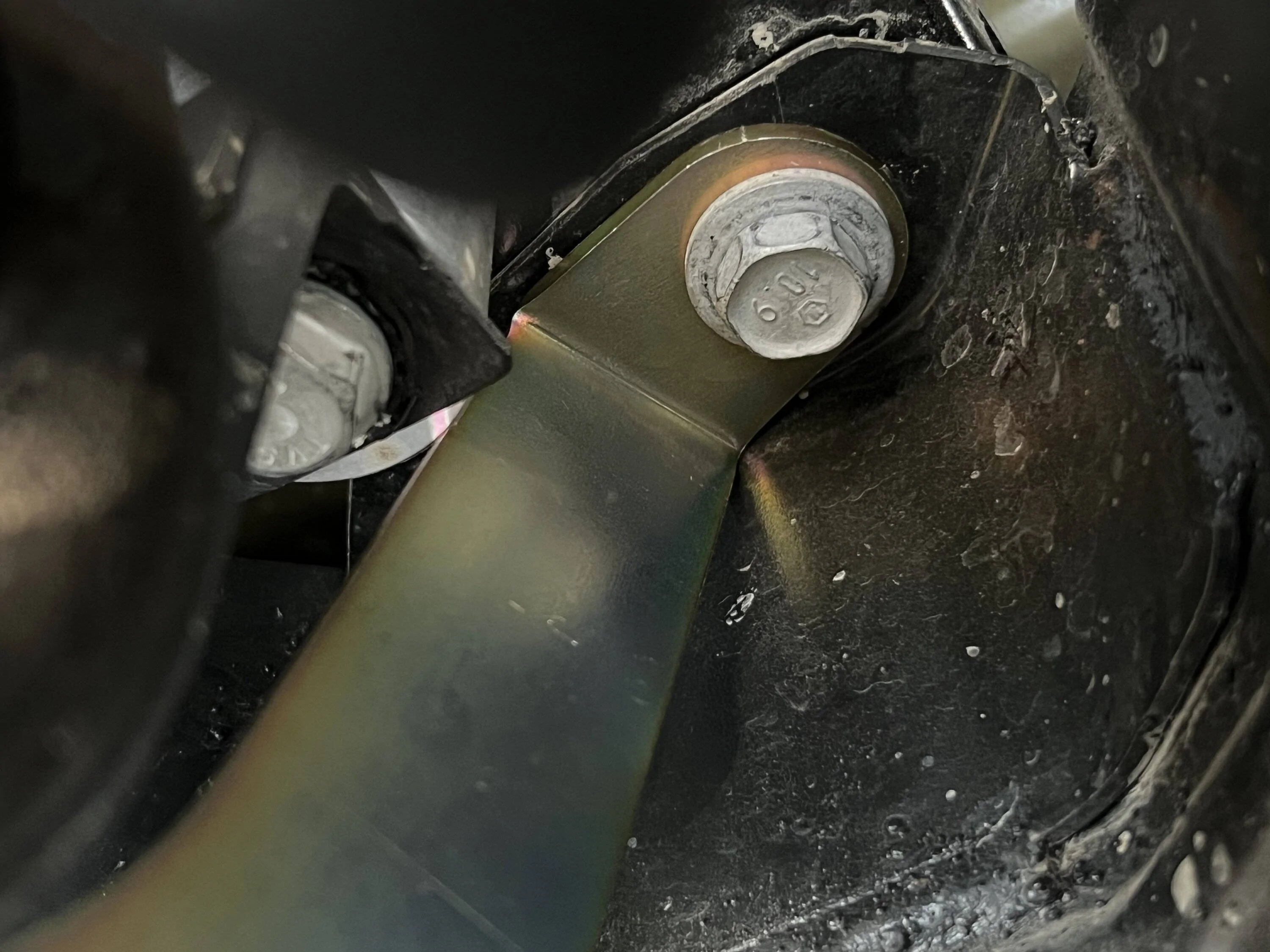

If I had plastic liners it would’ve gone so much faster that’s for sure! If any one is remotely thinking of liners in the future, spend $5.00 and get the longer bolts now. If you ever have your liners off you’ll be ready for just about any brand of skids.

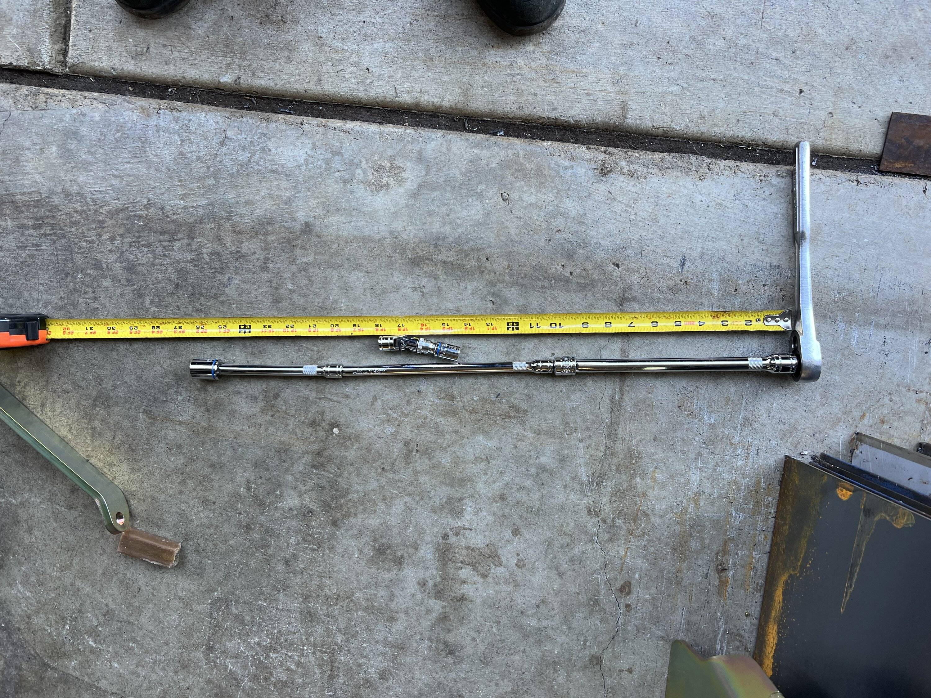

26” of extensions. And couple swivels for the passenger side. I finished the driver’s, lots of clearance from the top. Passenger side tricky, one more bolt to go but swivels joints have that one section that’s binds by nature and it causes the assembly to jump off. This is where a another hand under holding the socket will come in

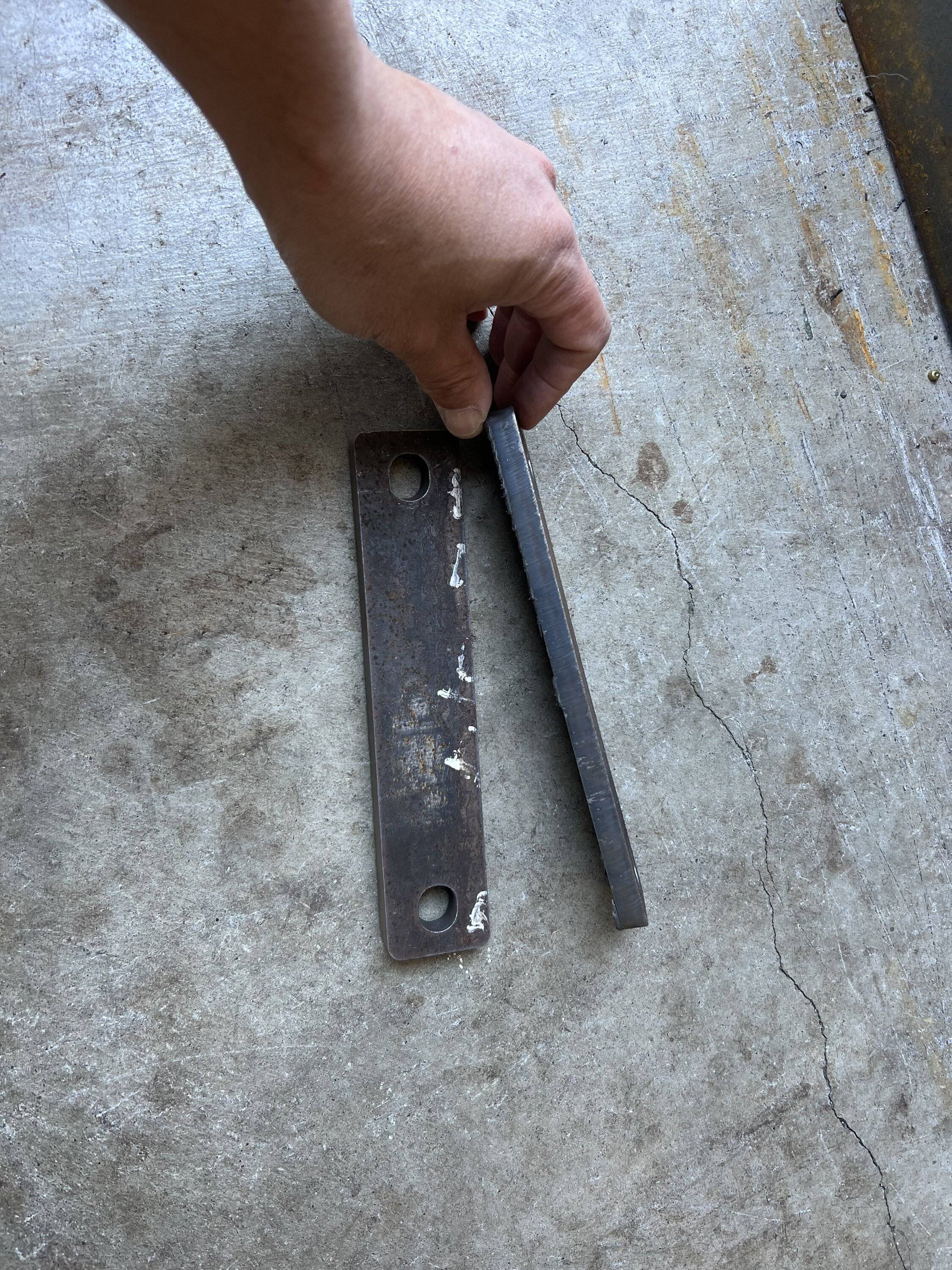

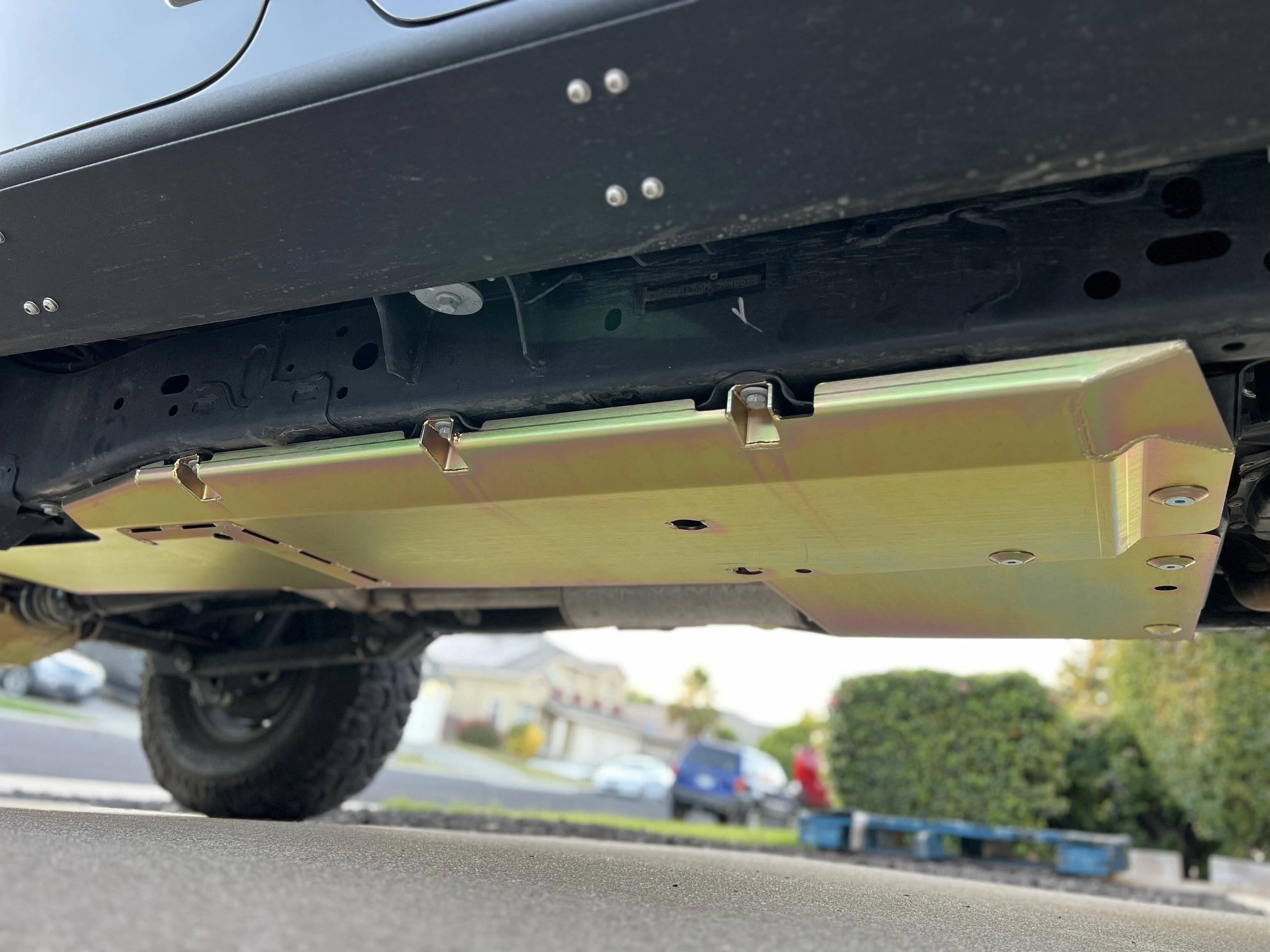

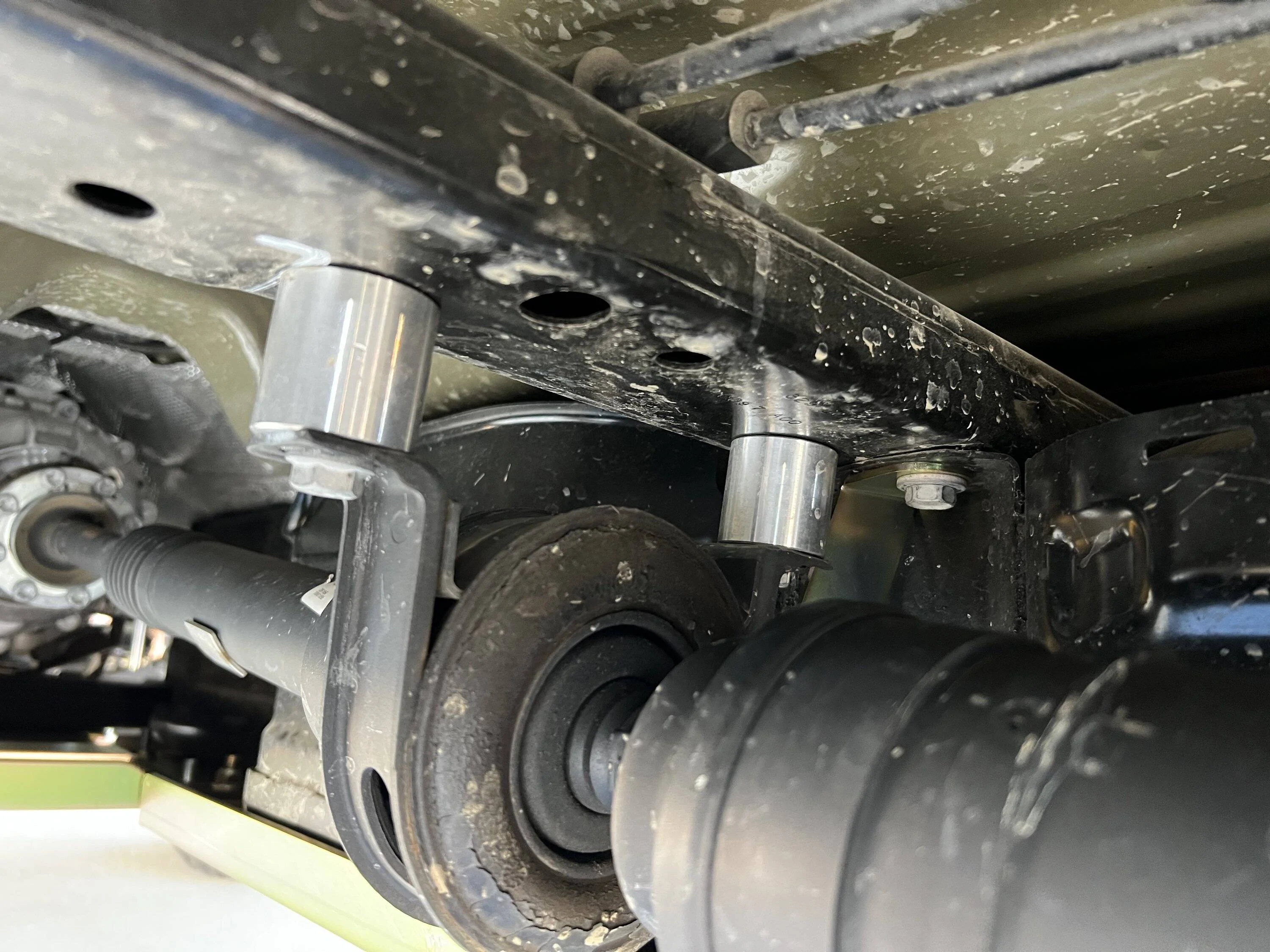

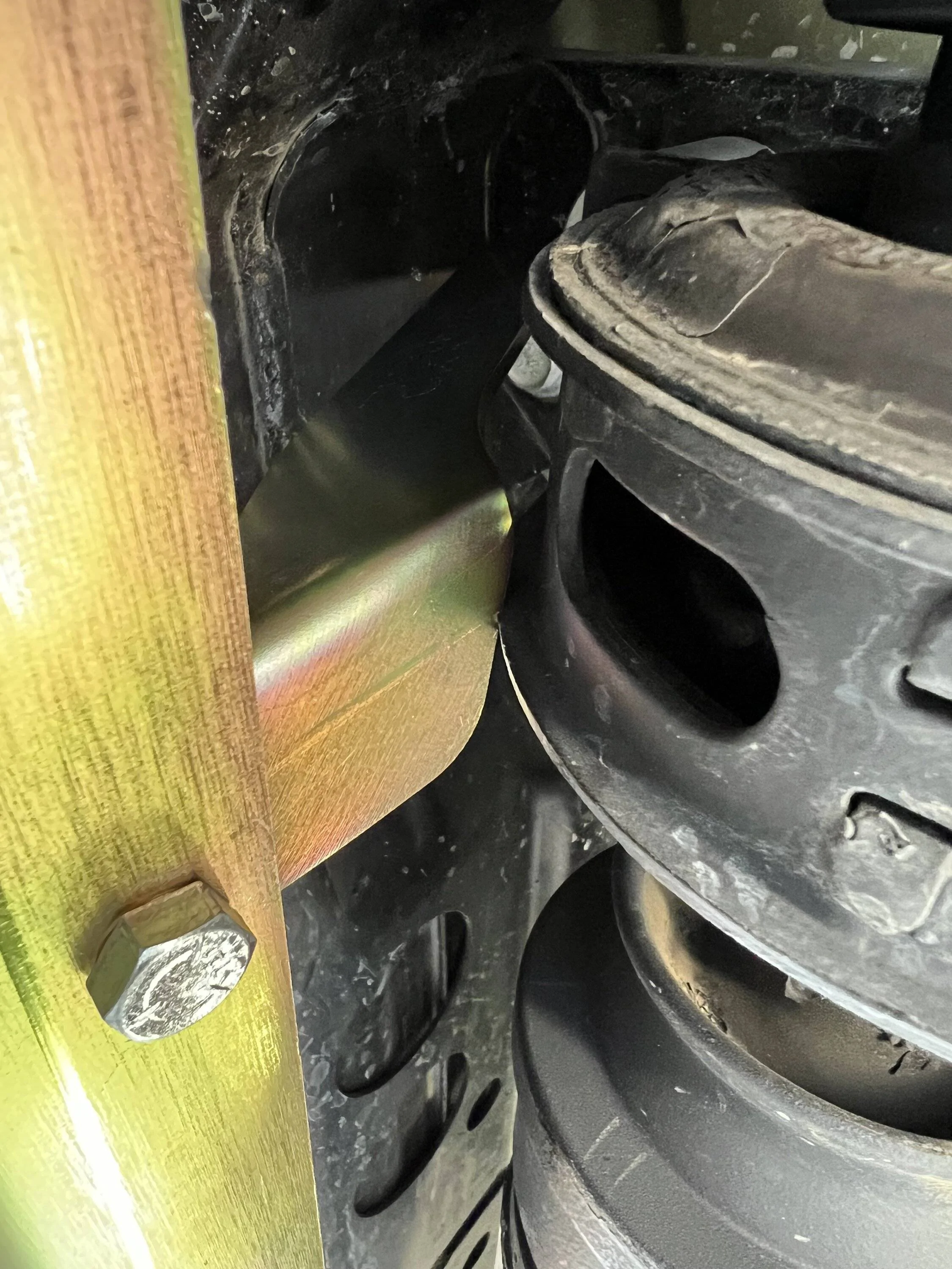

All done. Another self inflicted wound…. I’m running teraflex center bearing driveshaft spacers and the gas tank bracket hits the spacer and the bearing bracket also hits. I made my own spacers before as I was worried about how low the driveshaft dropped. I will drive and monitor the contact if I have to I will swap out the spacers for more clearance.

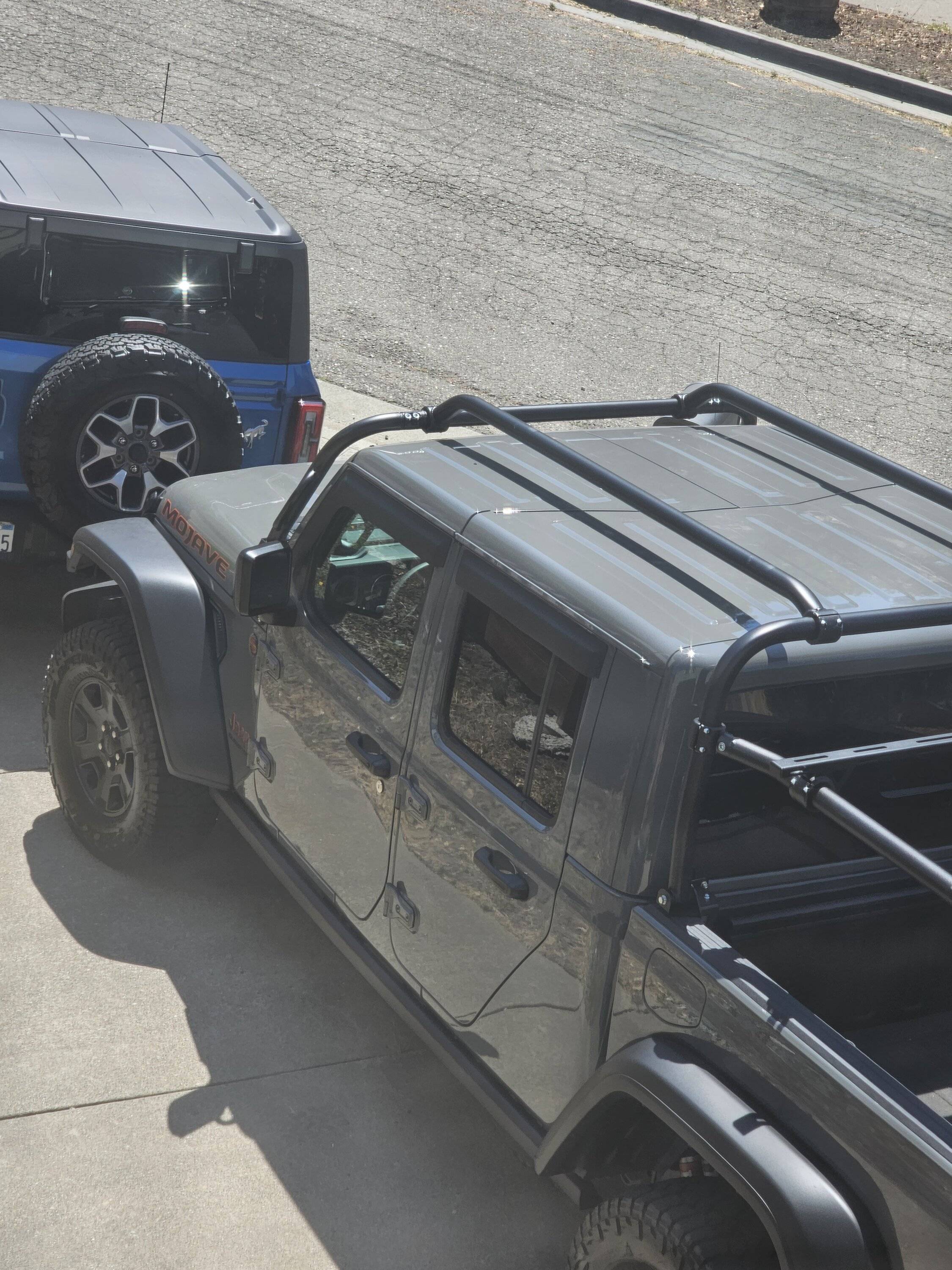

I recently installed the Adventure Rack Systems overcab rack from Metal Cloak and was STRUGGLING to drill larger mounting holes for the reinforced steel under the cowls. It has made me a little gun shy for another large project.

What kind of drill bits did you use. Step bits work great, but also when drilling into thick steel, slow it down heat kills the bits and it’ll make it take longer.
But no issues really it’s just the fact that I have aftermarket liners and they got in the way of reaching motor mount bolts. Everything lined up without issues too. Where they said tighten I left snug until the very end. I won’t hesitate to order another set, and I will for my JL.
