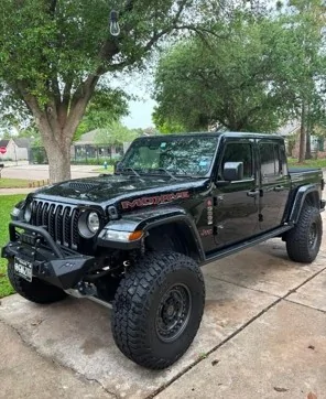

As the title states, I have Mickey Thompson 37" Baja Boss, 20K miles on them. All of the sudden at 50-60mph only, I've developed a shimmy in my steering wheel. I wouldn't call it death wobble by any means. Crazy thing is that doesn't happen all the time, when I'm in that range. It shows itself, whenever it wants too. I take the same route to work every day, one day Jeep rides perfect, next day, same route, the shimmy in the steering is back.
I've have had 2 different 4x4 shops go thru my suspension/lift with a fine-tooth comb, as they say, all is good. They both believe it's the tires. I've had them balanced, rotated...still same issue. Not sure if they are covered under Mickey Thompson warranty or if Discount Tire would warranty them?
Tires have plenty of tread, in fact one is practically brand new covered under Discount Tire road hazard warranty. The new tire has been moved front to back. I don't think it being mismatched with the older tire is an issue. Maybe get a second new tire and pair it with the other new and put up front? Baffled.
If it's time for me to move on from Mickey Thompson....what is your go to 37". I'm looking either TOYO or BFGs.

Thanks for the input. Up until now, they have been great. I checked the MT website and their warranty statement sounds legit. Yes, I'm going back to Discount Tire and see what they can do for me.

One more note, I should have mentioned........the 37s were fine with my 2" AEV lift & RPM steering & Clayton track bars.....we just swapped the 2" for a full Clayton 3.5" lift (arms, coils, Falcon adj shocks, etc), that's when it started. Everything is torqued and retorqued to spec, aligned, etc.....

Just spoke to Discount......getting a $1000 credit for trading in my MTs toward TOYOS or BFGs.......I want to eliminate the tires out of the issue. 20K miles on the Mickeys.

I’m actually sitting in Discount Tire now. They gave me 75% credit towards new BFGs. OMG, night and day difference. Jeep is riding amazing, no more steering wheel shimmering!!!
