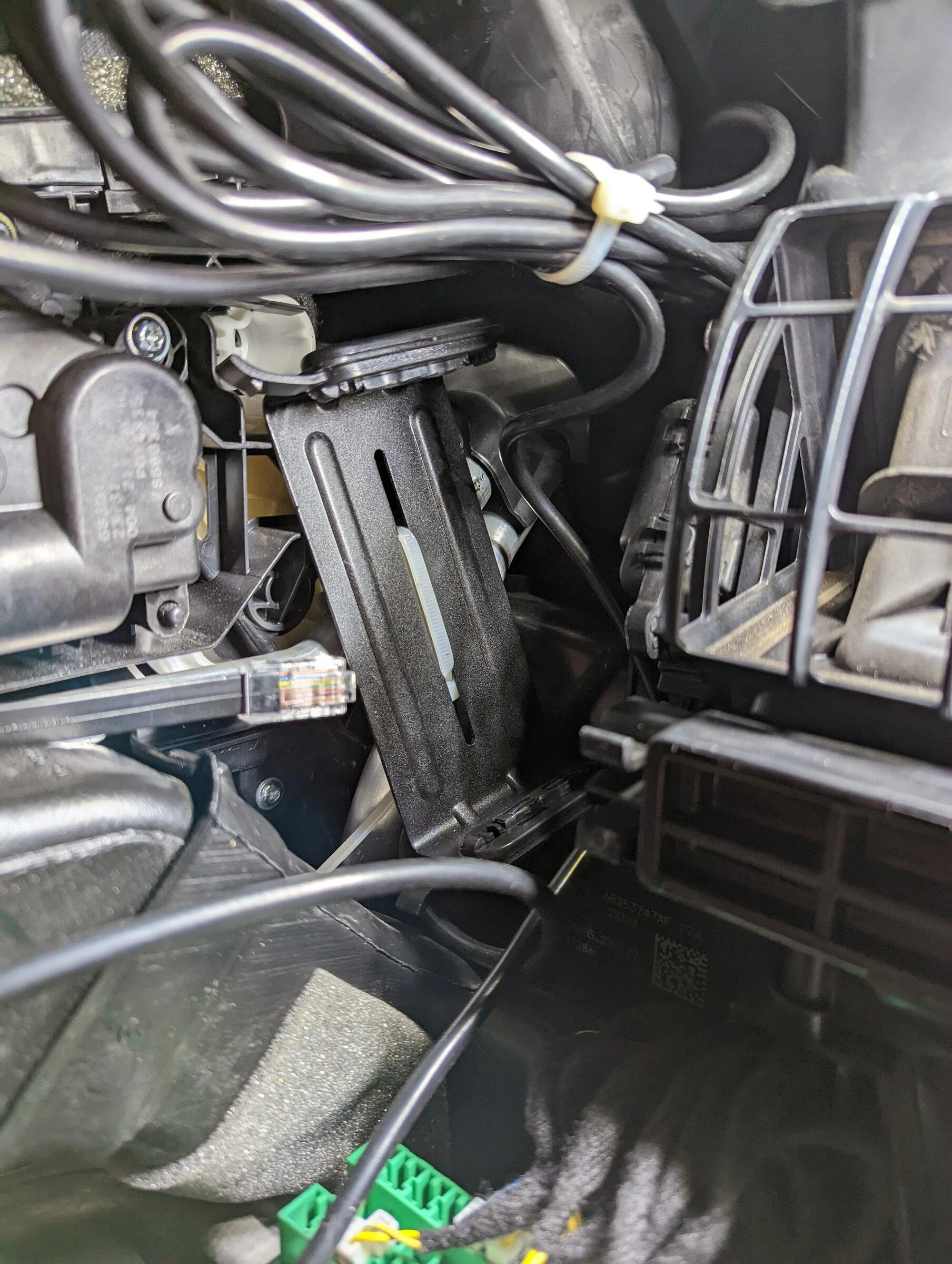

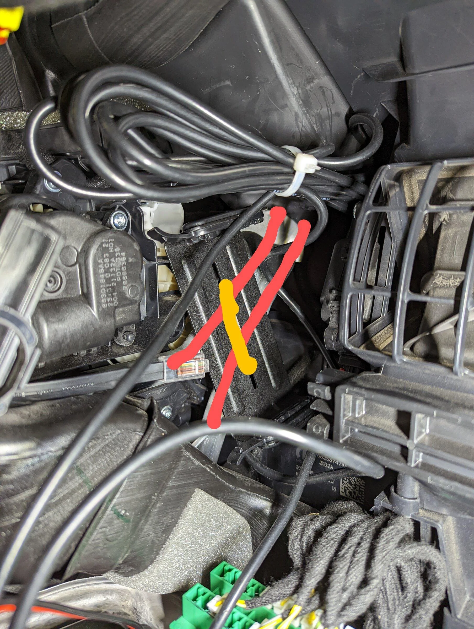

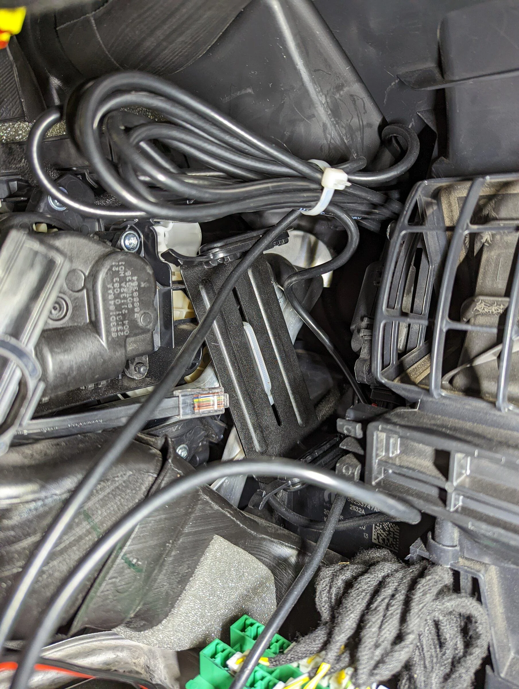

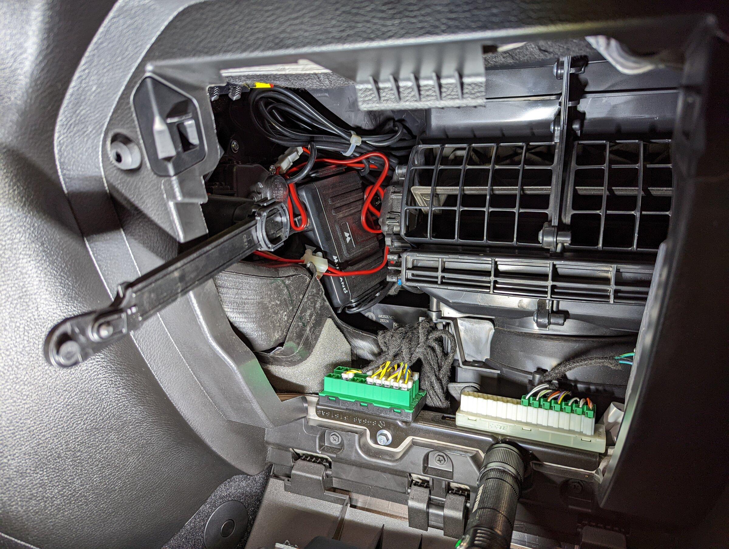

It's attached to two aluminum tubes going towards the top of the firewall with a zip tie. Not 100% sure what they are lol. Red is the two tubes, yellow is the zip tie. The zip tie was a huge bitch to put on and tighten. I would recommend 3M VHB tape instead.

Is that the Quadratec 12volt pigtail plug you used for ignition switched power?
Yes it is. Brown is ground and red is 12v. I was not able to find that written anywhere, including the included instructions.
Dude, you weren't kidding. That's 2 sweaty hours in the garage I'll never get back. Back to the drawing board.

If I had to do it again, my first try would be to line the tubes on one side with this tape.
Ordered that and some velcro options. The main reason I attempted passenger side was to make use of the USB C outlet to power my magnetic phone charging mount. Ordered an extension cable for that so I may explore mounting it somewhere on the drivers side. How does the speaker on the unit sounds when tucked under the passenger side?

Not sure on the sound. I only ever use the speaker on the handset itself. I can't imagine that you would get a good sound through the unit back there.

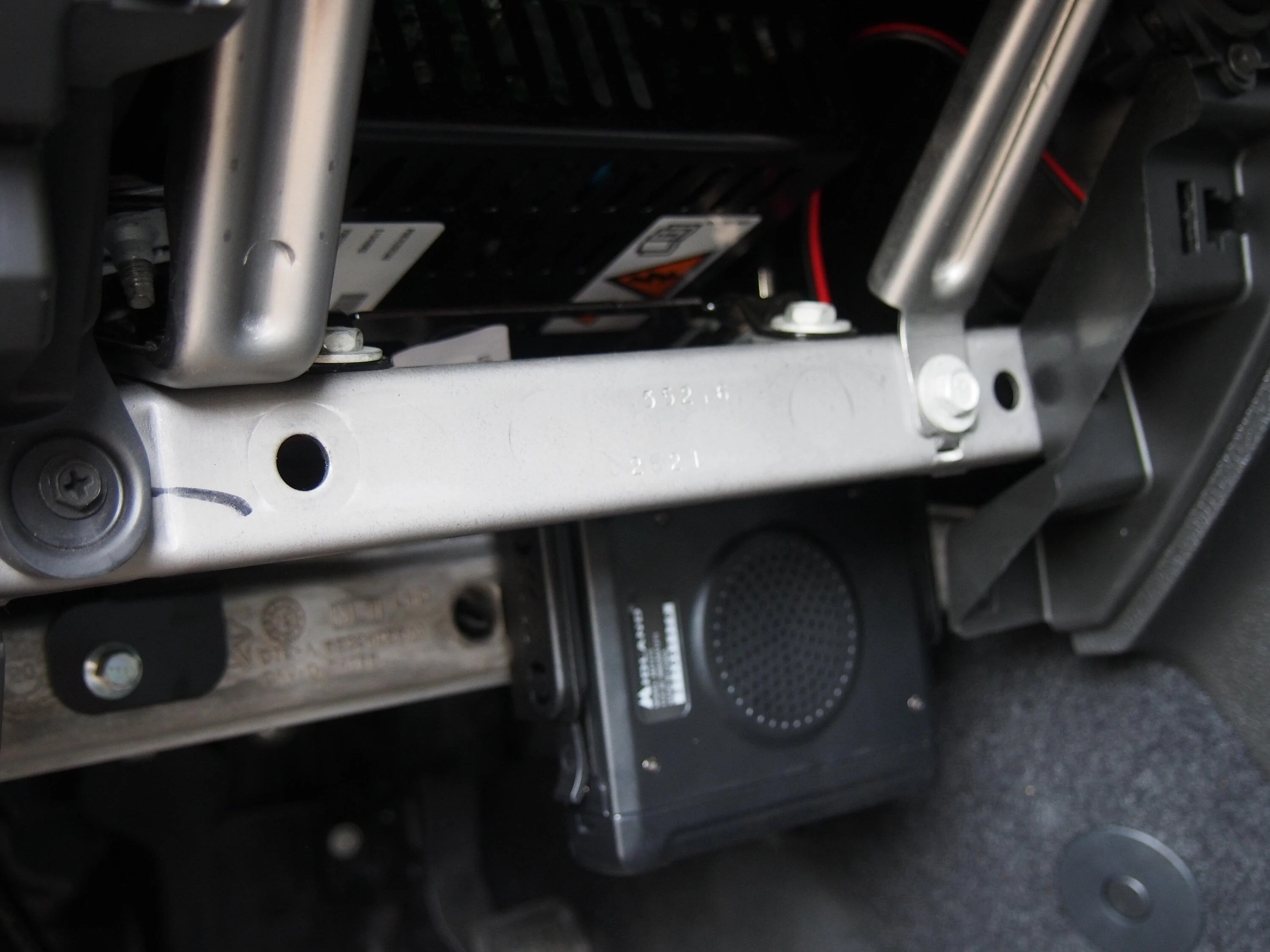

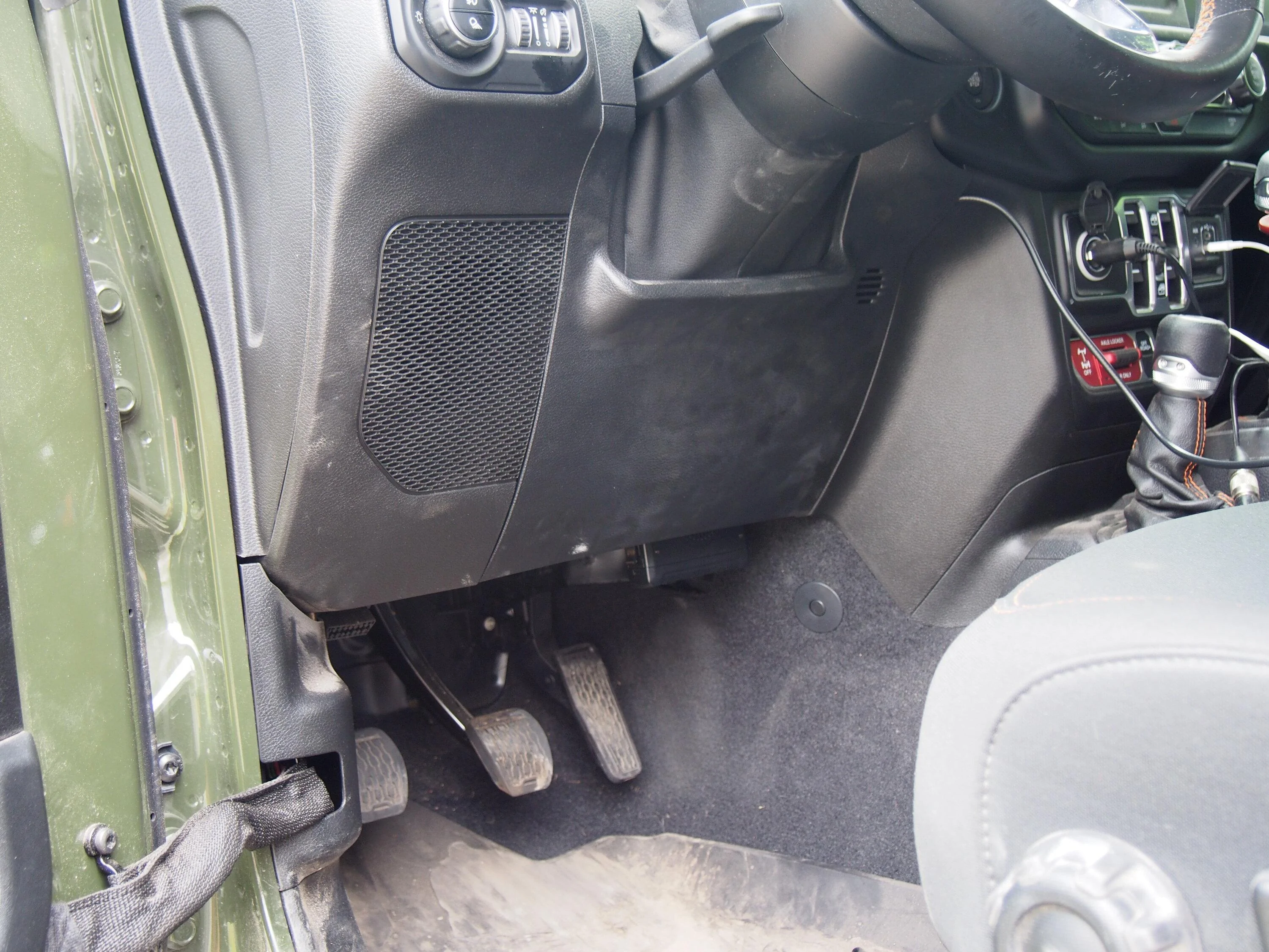

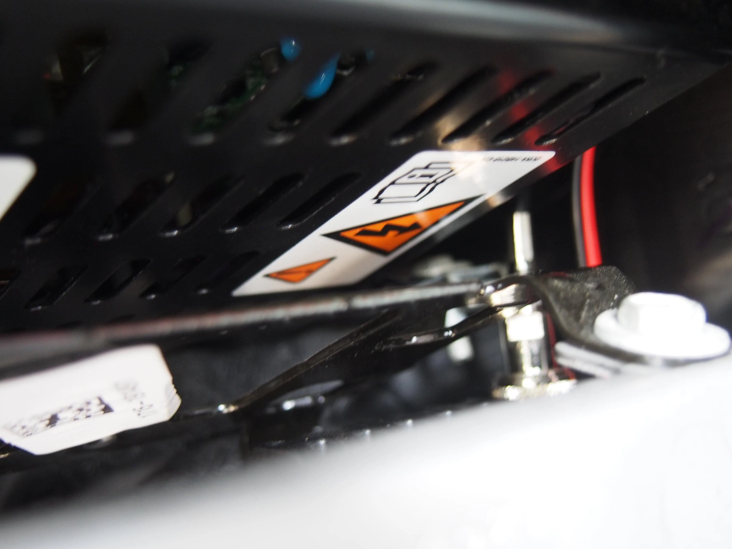

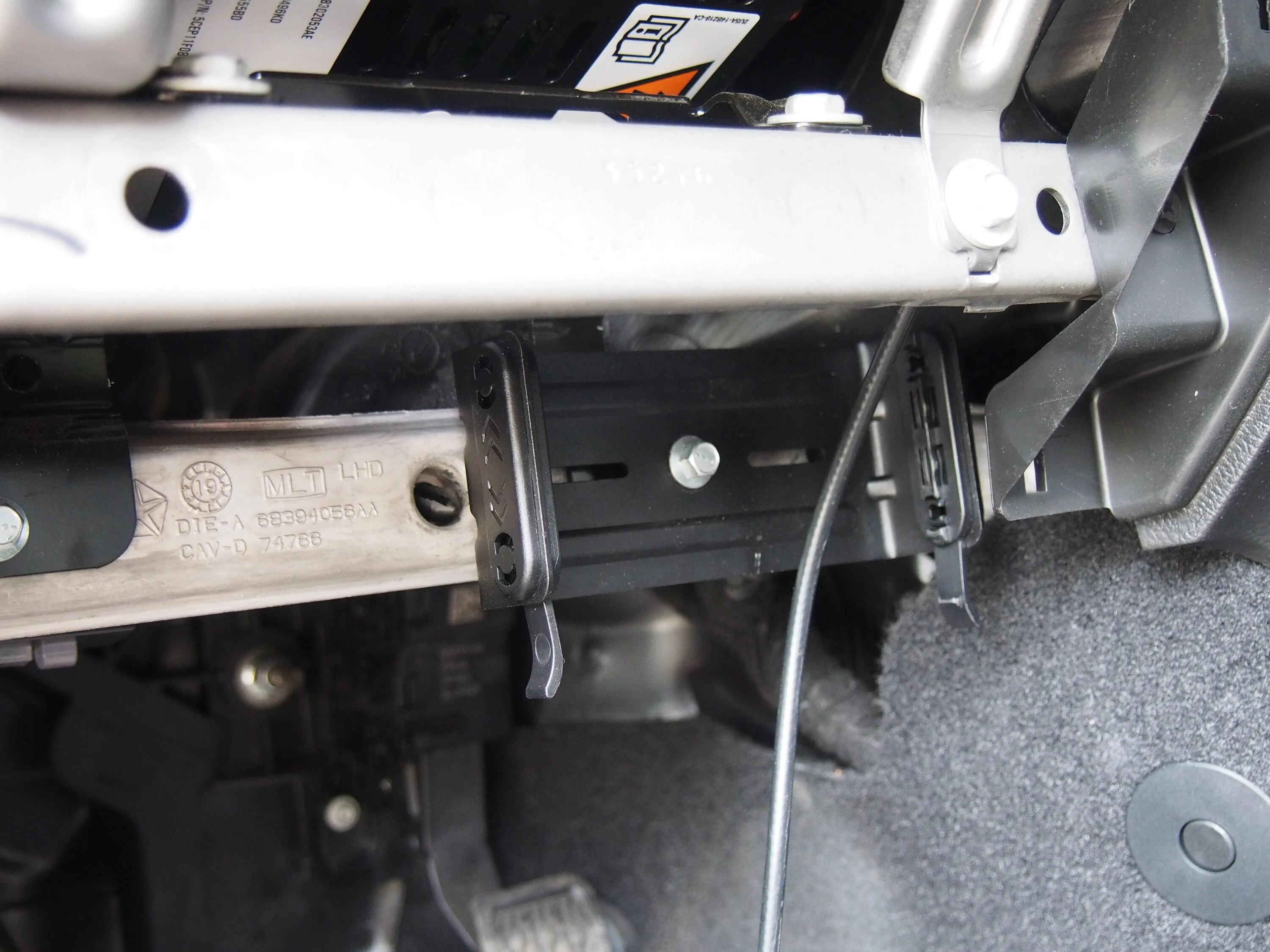

I just installed my MXT275 to the bar below the steering wheel. I used a 1/4" spacer to move the antenna away from a fastener, and I ran an RJ45 wire to the cubby next to the axle lock. The sound is very loud and clear in this location.

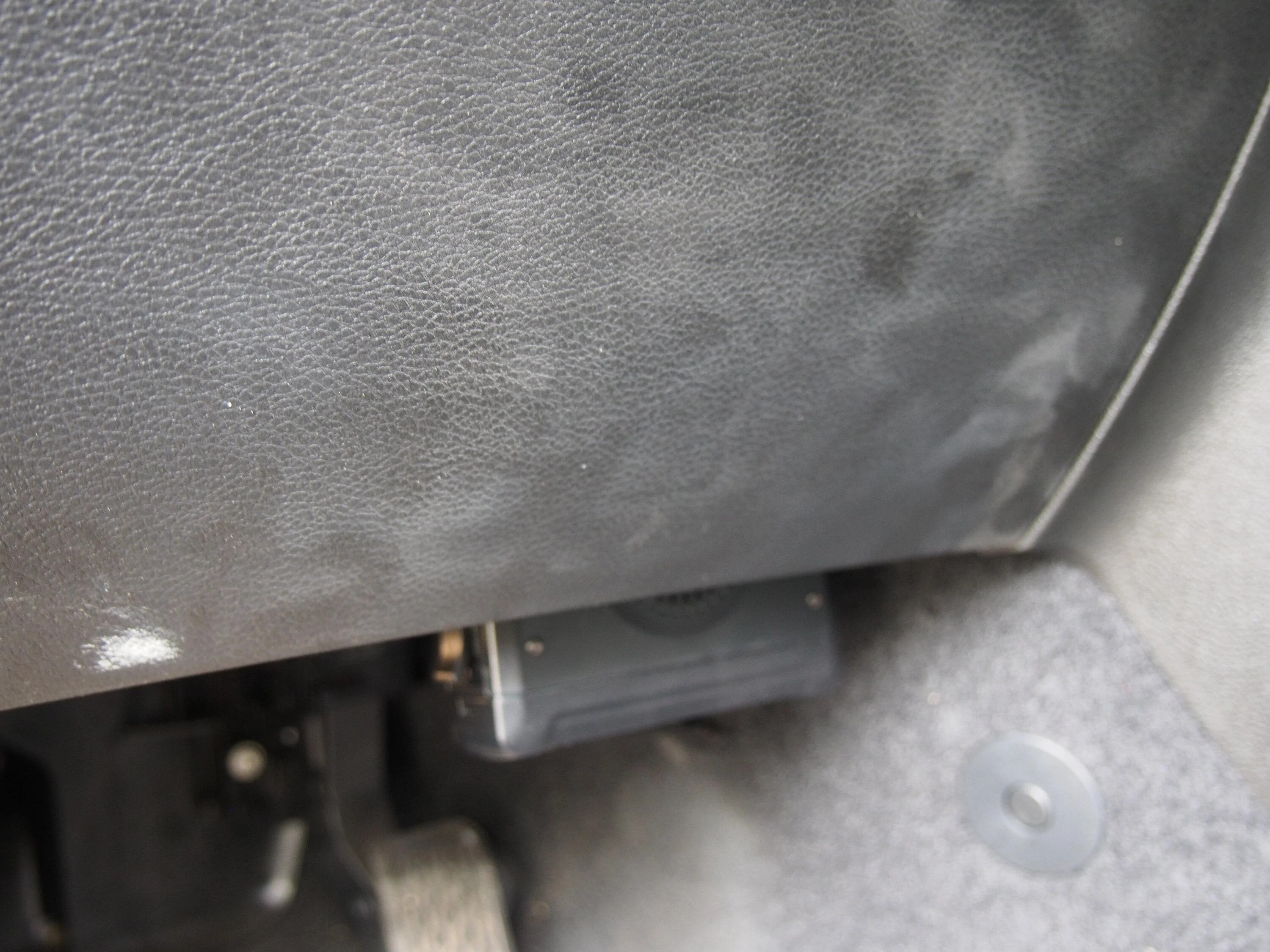

I still haven't decided whether it will go in the glove box or center console
My only advice about he glove box install. The volume is muted by all the plactic. I ended up moving mine under the steering column for this reason. Now I can hear it fine.
Noted! Thanks

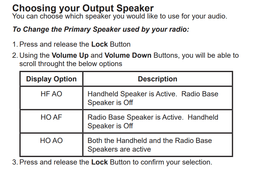

Just change the speaker to the hand held. press the lock button quickly and follow these directions.
Thanks for that. didn't know it was an option.
