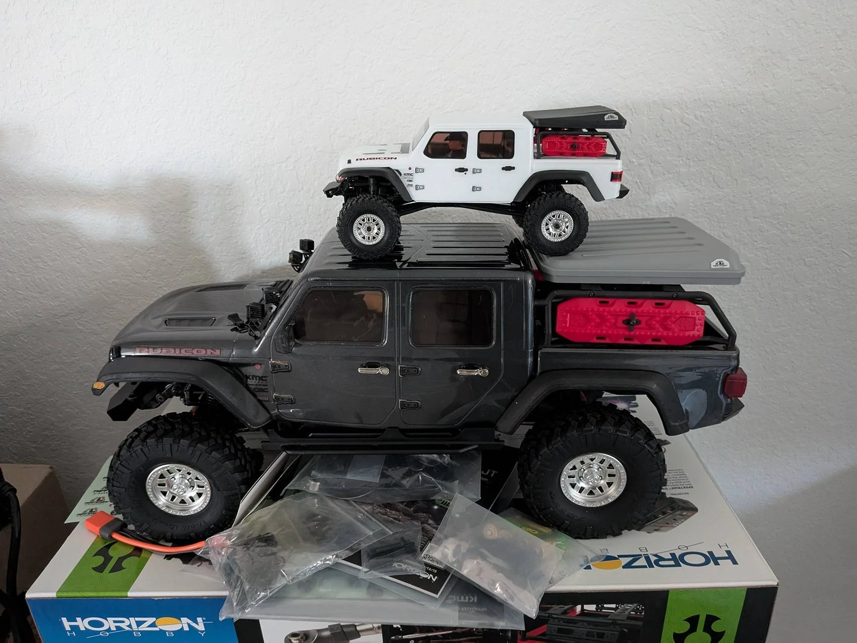

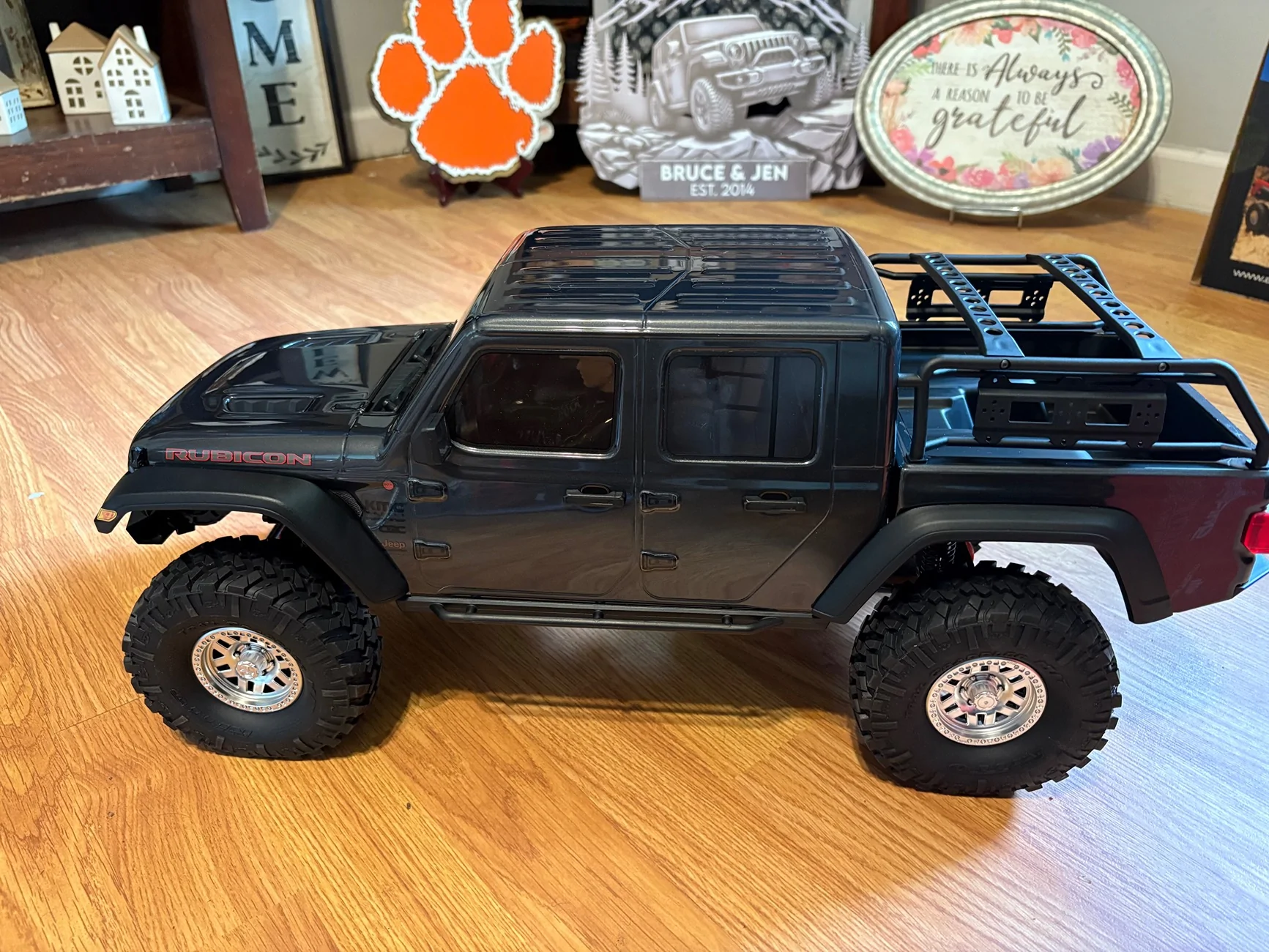

Got this yesterday. Axial scx10 gladiator rtr. ran it in the house a little but haven’t had time to get it outside.

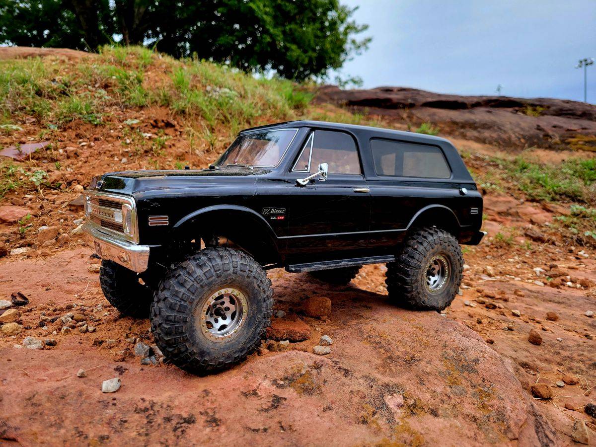

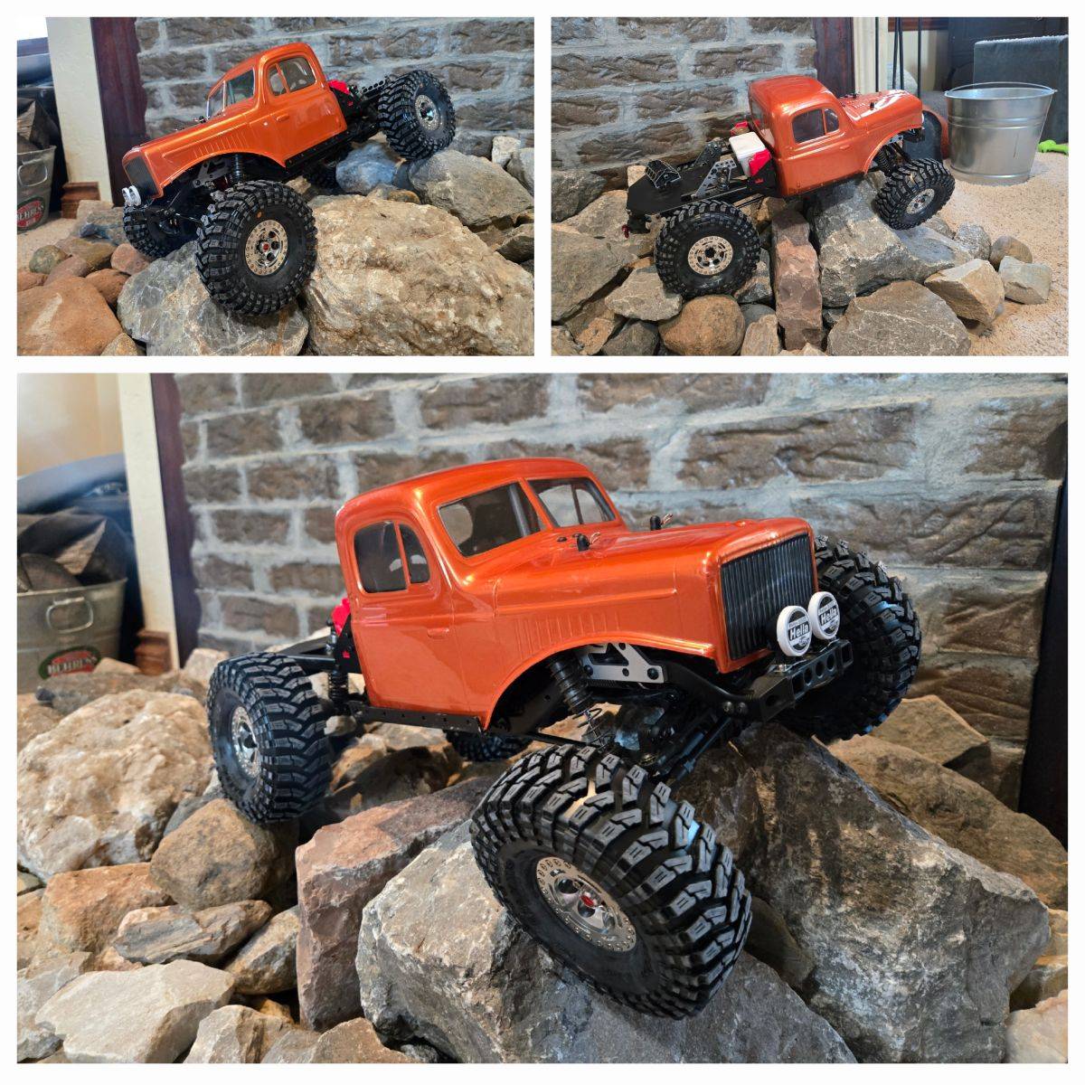

Here's a couple of my more favorite rigs:
TRX4 Sport

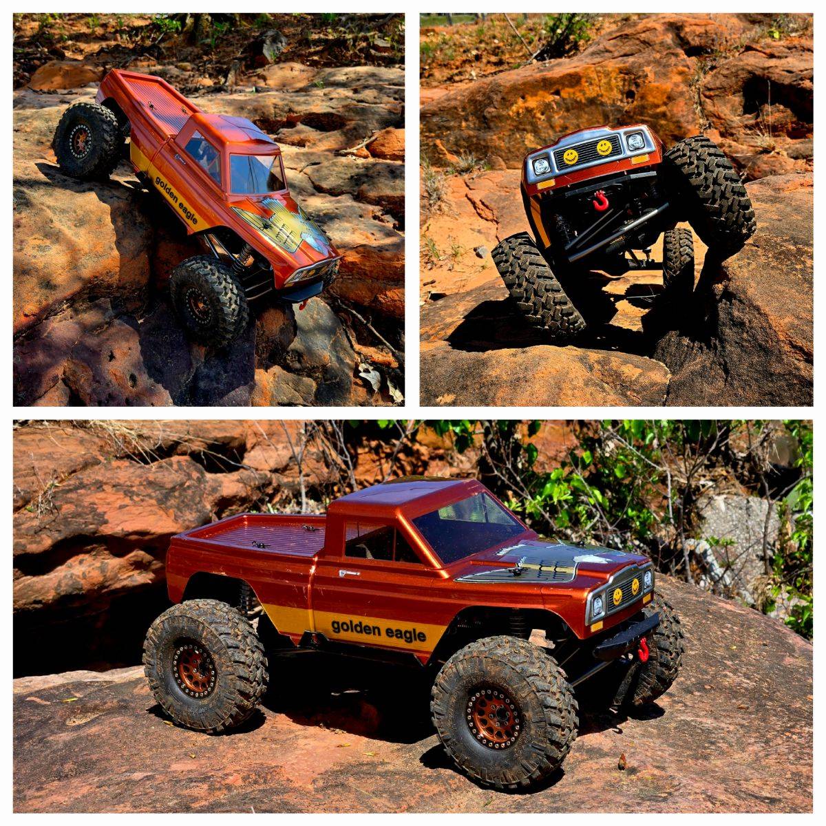

Vanquish VS410 that is a J10 Golden Eagle tribute:
TRX4
They are all great looking rigs! Tell me more. I'm looking to build a good crawler and would like some details on the Power Wagon and J10. Looks like an aftermarket chassis on the Wagon? And is that the Pro-Line body? Any other details you can give me on either one?
I'll get some detailed pics up later to show the chassis with the bodies off.
PowerWagon: It's a Traxxas TRX4 Sport, still on the stock chassis, but with some Rock Pirates shock mounts. It has a Hobbywing Fusion Pro brushless motor/esc, with a FlySky GT5 radio/receiver setup. The flatbed and sliders are from IERC Scaler. The steering servo is a direct power unit from Reef's. It's stout. I modified a micro winch mount from a Vanquish VRD to fit on the front of the frame. It has brass hubs and portal boxes from Treal. It has some 13% underdrive gears in the rear axle.
Yes, the body is Proline. It has a full rollcage interior that I got off Etsy. The driver/passenger are skeletons off Etsy as well. The stuff on the bed (jerry cans, YETI cooler) was from Etsy. The Jack Daniel's barrel was a keychain. The engine block was a keychain as well. It's a small block Chevy btw, only because they didn't have any big block Mopar's. Lol I've since added some real, working LED lights on the front from Mues, to replace the fake ones. The local Facebook group does night trail runs sometimes, which is fun. The tires are Proline Trepador's, on some rims/beadlock rings I got off Amazon. The fake lockout hubs are from RC4WD.
J10: It's a Vanquish VS410 straight axle (no portals) chassis kit that originally had sort of a Toyota FJ body to start with. J-Concepts came out with a J10 body (called the Warlord), so that HAD to happen. The Golden Eagle decals are from Axial. It also is running a Hobbywing Fusion Pro brushless motor/esc with a FlySky GT5 radio/receiver and a Reef's steering servo & winch servo. The VS410 transmission has a selectable dig unit, which is really handy, but most crawl competitions don't allow you to use it in Class 2 Comps. It also has selectable overdrive to the front axle; 15% and 45%. The tires are Nitto Trail Grappler copies that came off an Axial Capra. The wheels are Injora brand.

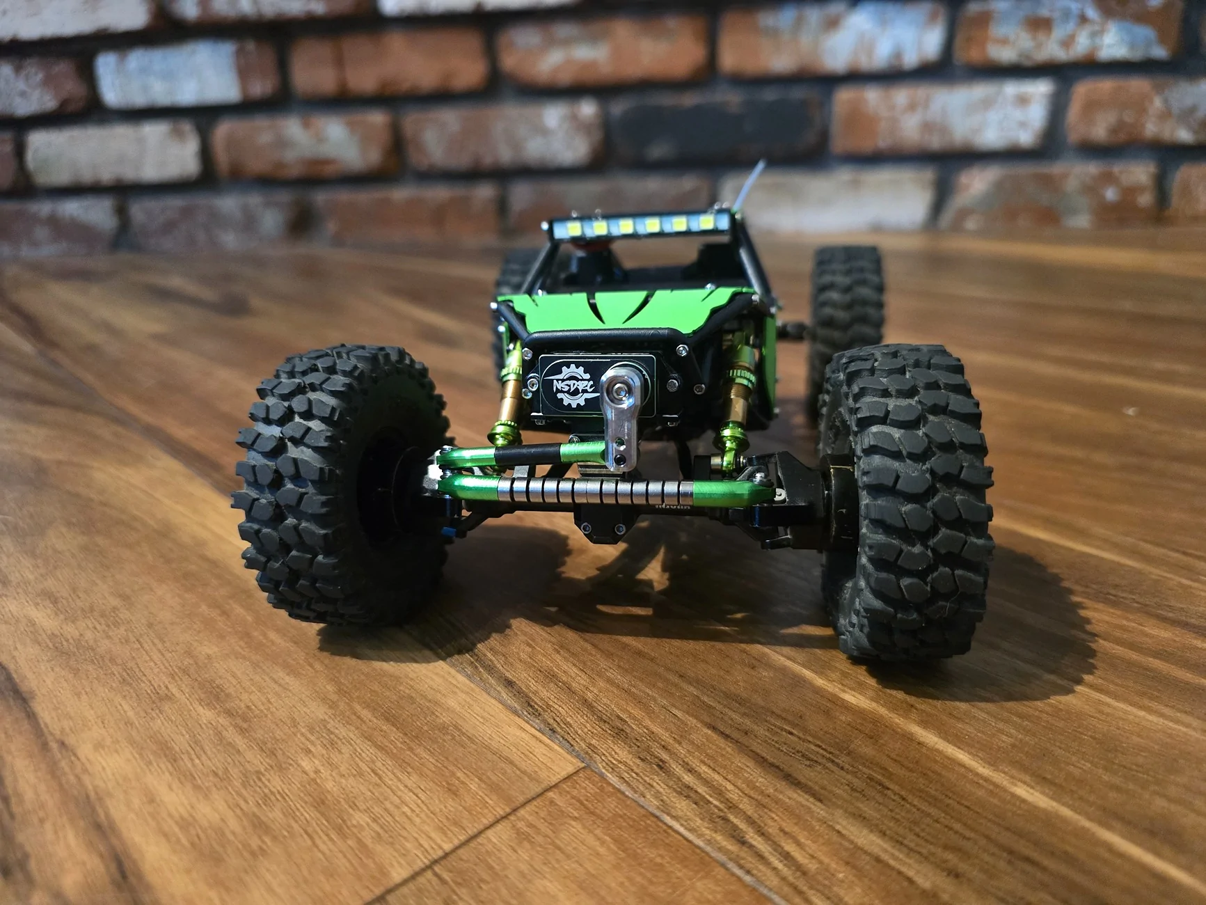

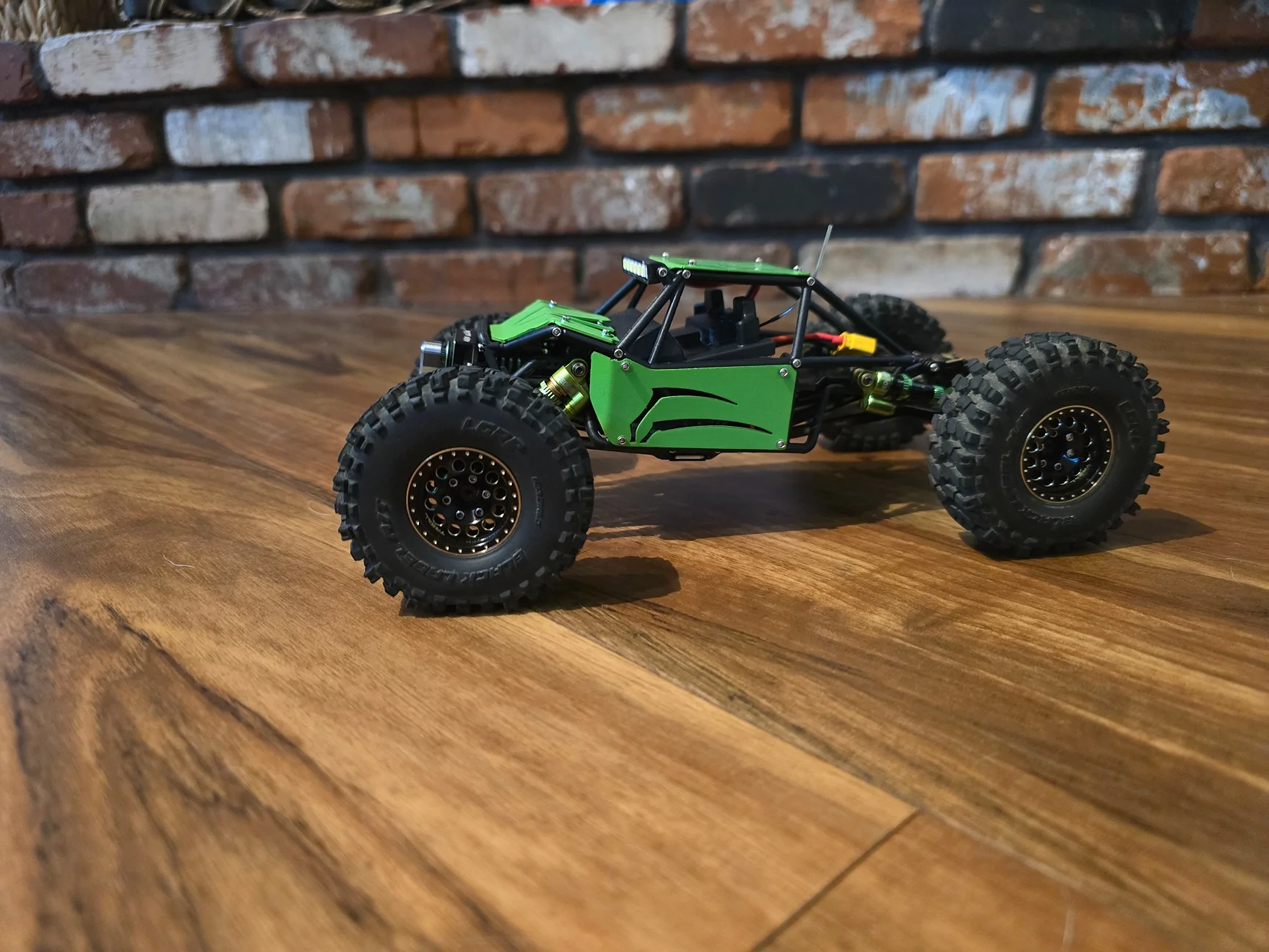

Yep its funny how the multiply. Just finished this 1/24 and have two 1/10 in the brainstorm phase.

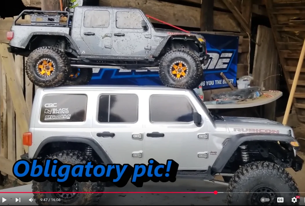

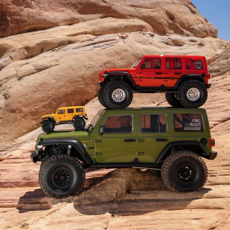

I was perfectly fine with my 1/24 scale and then I found out they made a 1/10 scale and found one FB marketplace for cheap and now I found out they make a 1/6 scale. Although the 1/6 isn't a Gladiator it is a Wrangler it is still a Jeep so it will work. It never ends with these things. Now I am on a hunt for a 1/6 scale.
for comparison the SCX24 & SCX10iii
Jeep Gladiator Mini Gladiator Run at RC Crawler Event PXL_20250724_175041961 (2)
SCX10iii & SCX6
Jeep Gladiator Mini Gladiator Run at RC Crawler Event 1755177081980-kh
Although 3 together
Jeep Gladiator Mini Gladiator Run at RC Crawler Event 1755177173019-4f
