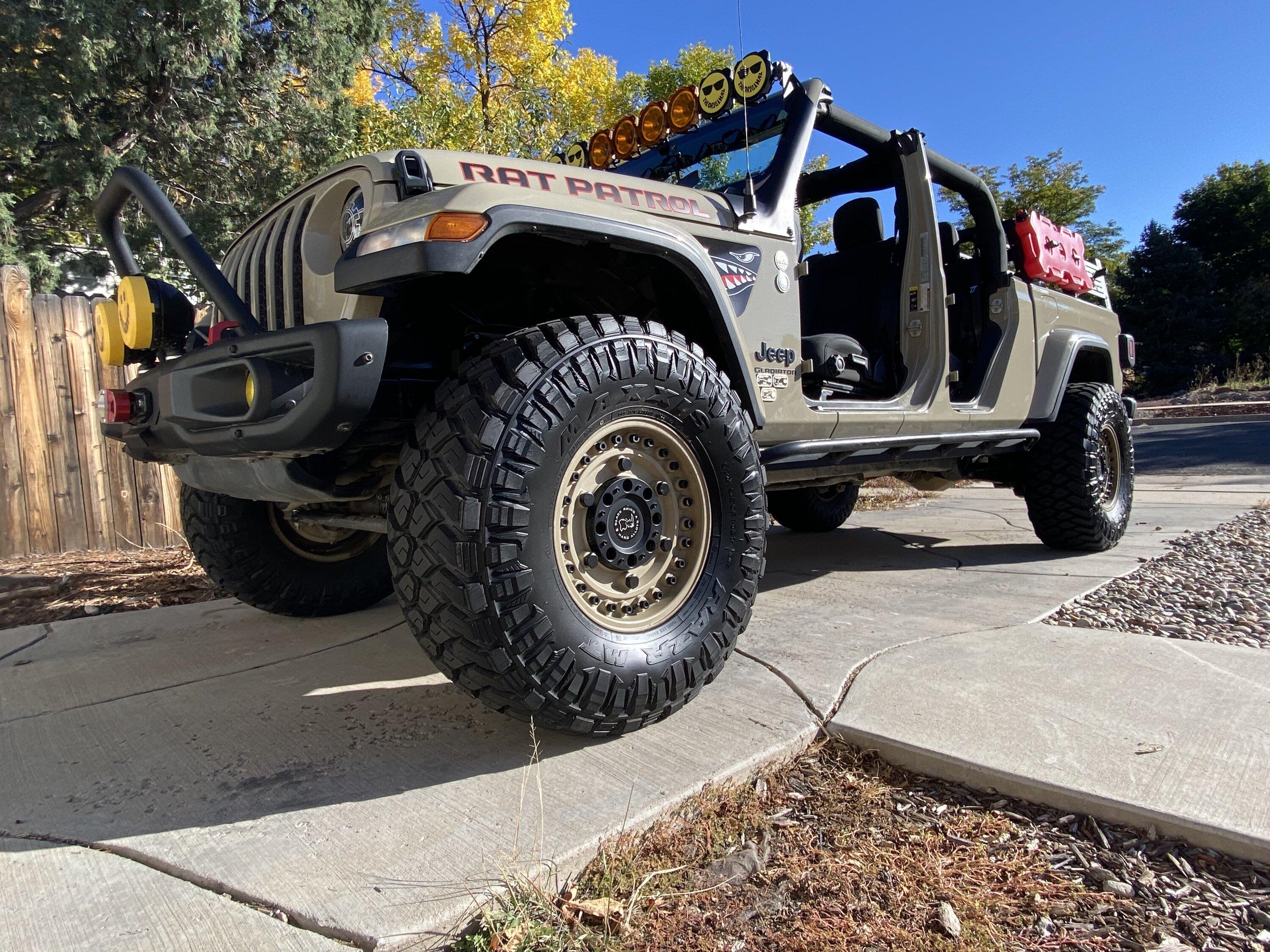

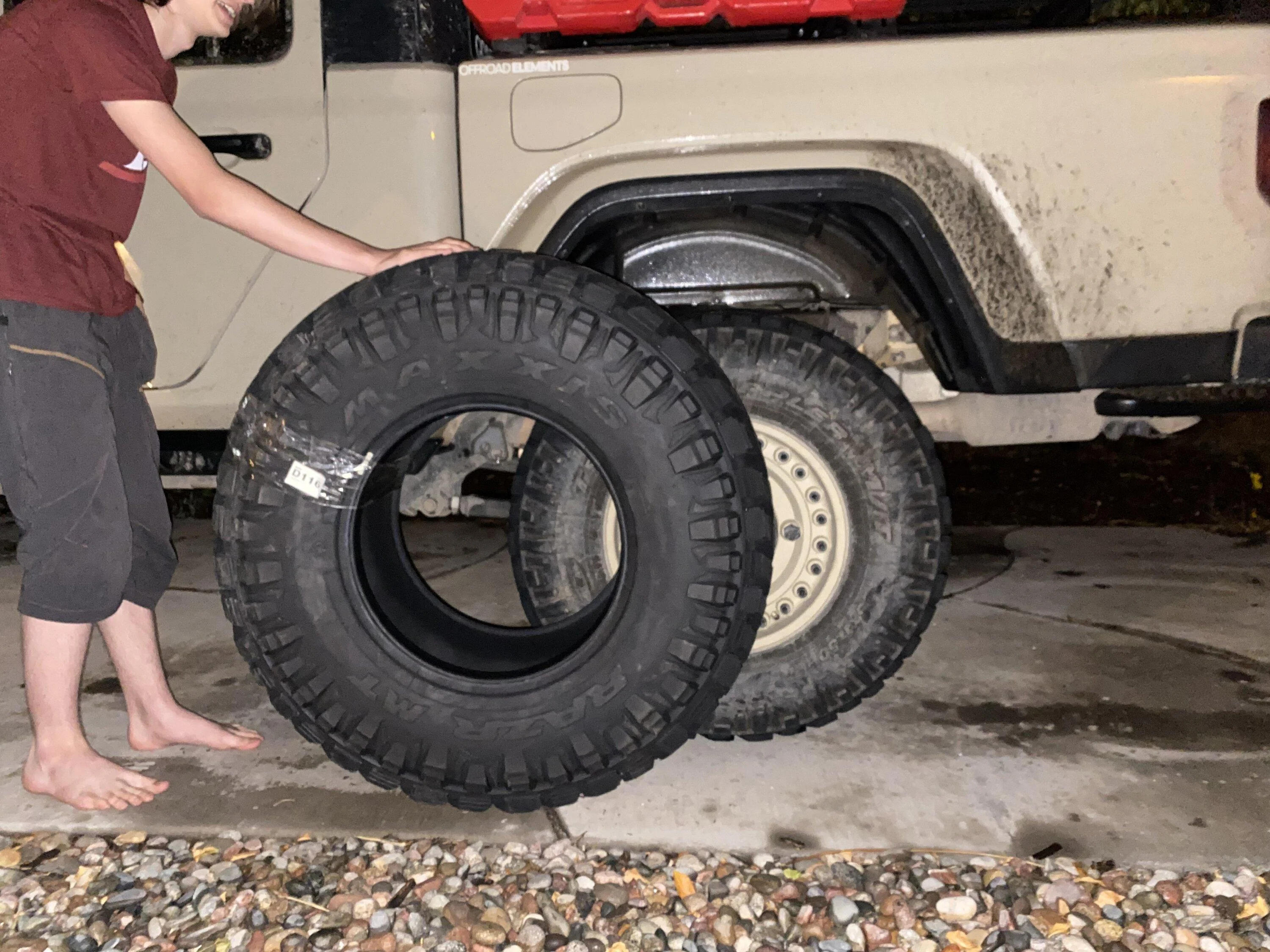

I went to 4.88 with 35s. did not last 1 week on 35s at 3.73.
Now I have 37s. If you are in the springs or close you may totally drive mine.
Size difference from 35-37 in last photo.
I'm also on Reid Knuckles and @TeraFlex HD ball joints.
