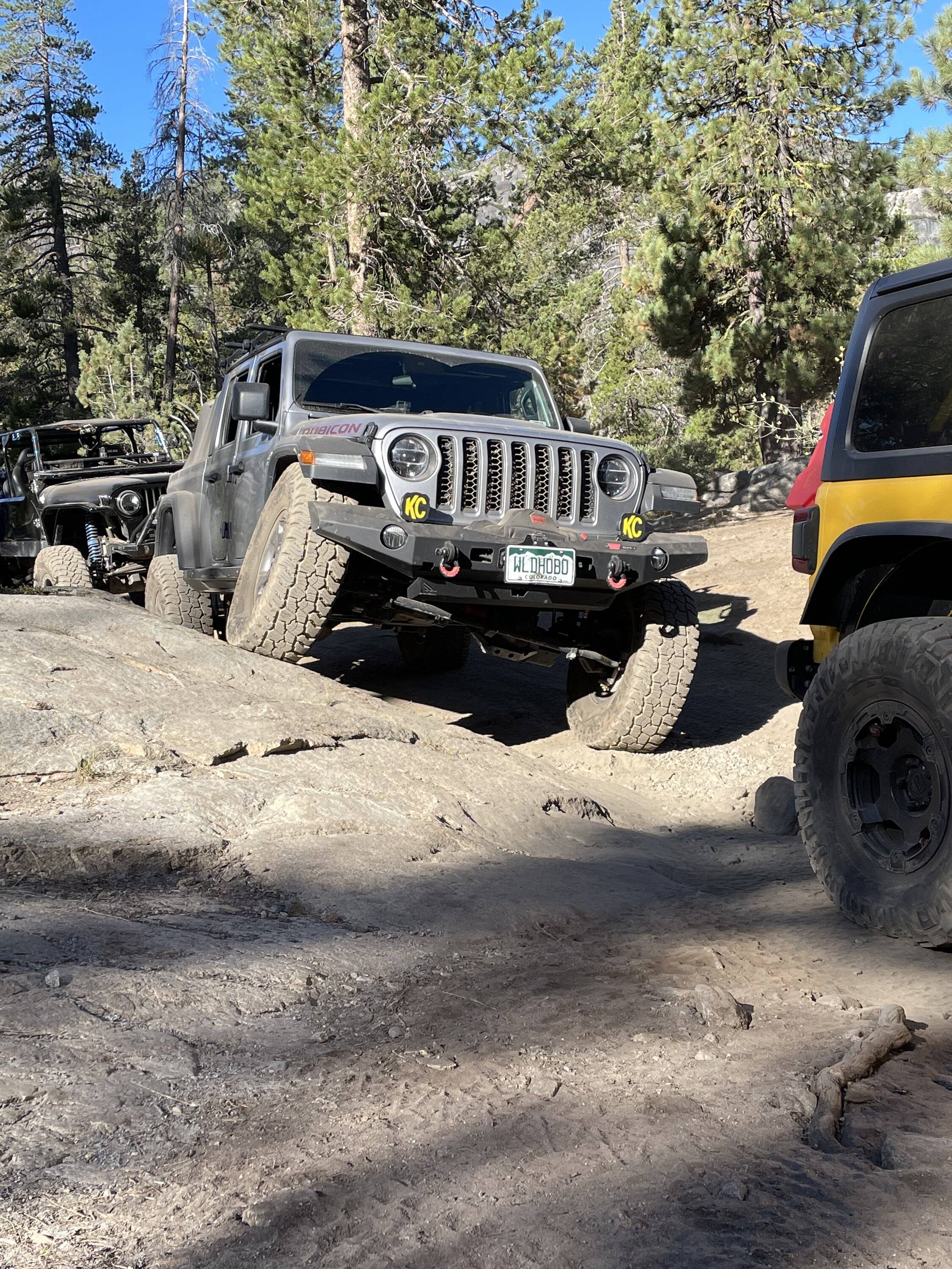

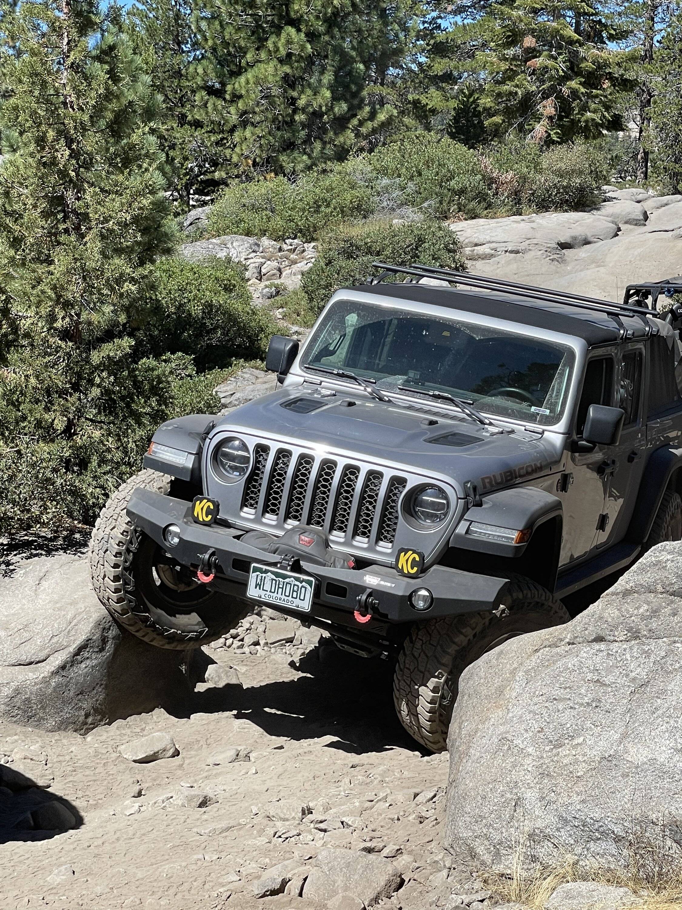

Does the rubicon trail count? :) it does amazing. It’s not geared for road use, but is geared for those that want a well-mannered daily driver that can also conquer some of the toughest trails out there. I’ve had it in Moab 5 or six times since the lift and it crawls over things with ease. But then it still tows our trailer safely at 75mph on the way home. It’s a nice lift.
