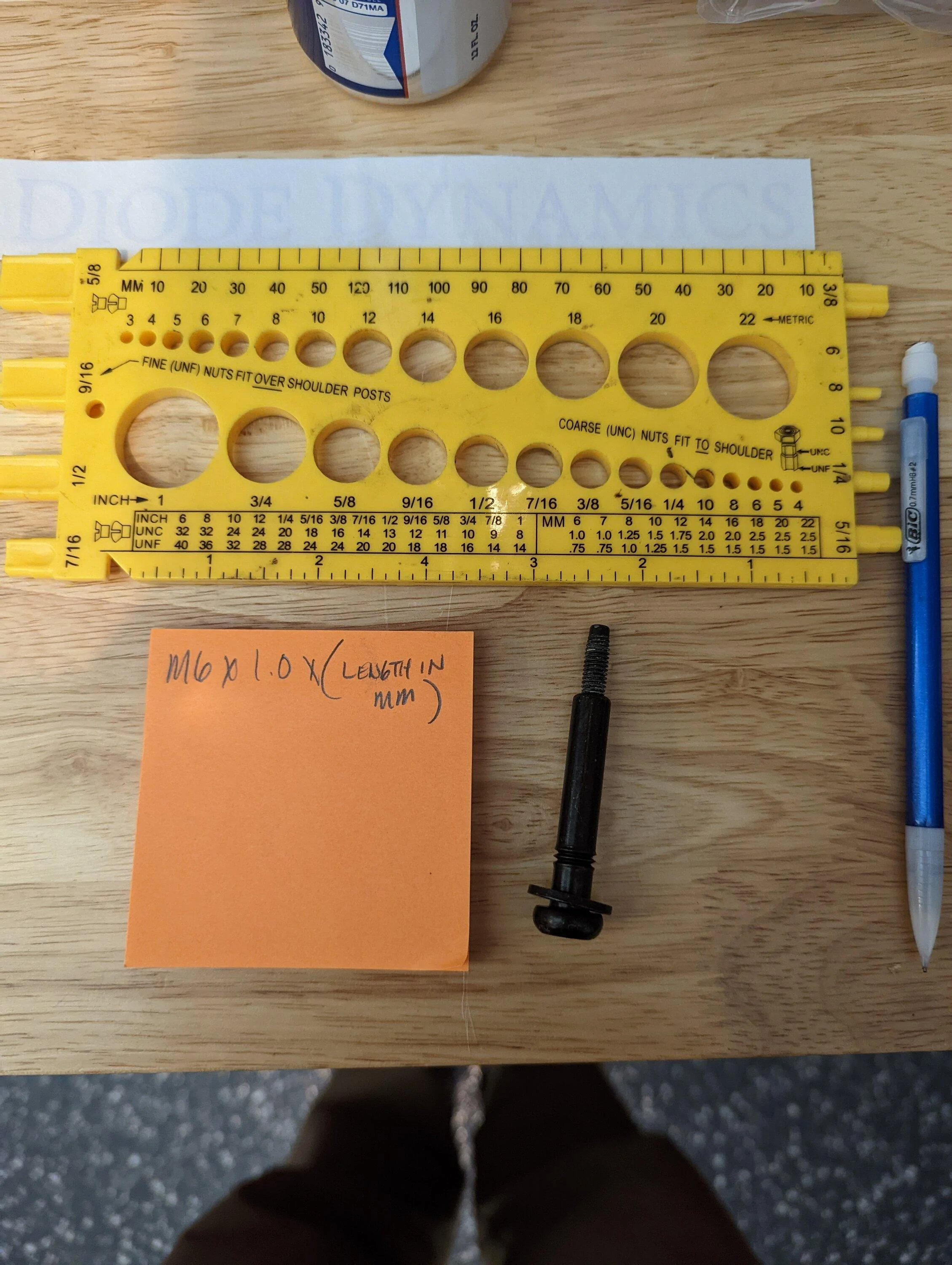

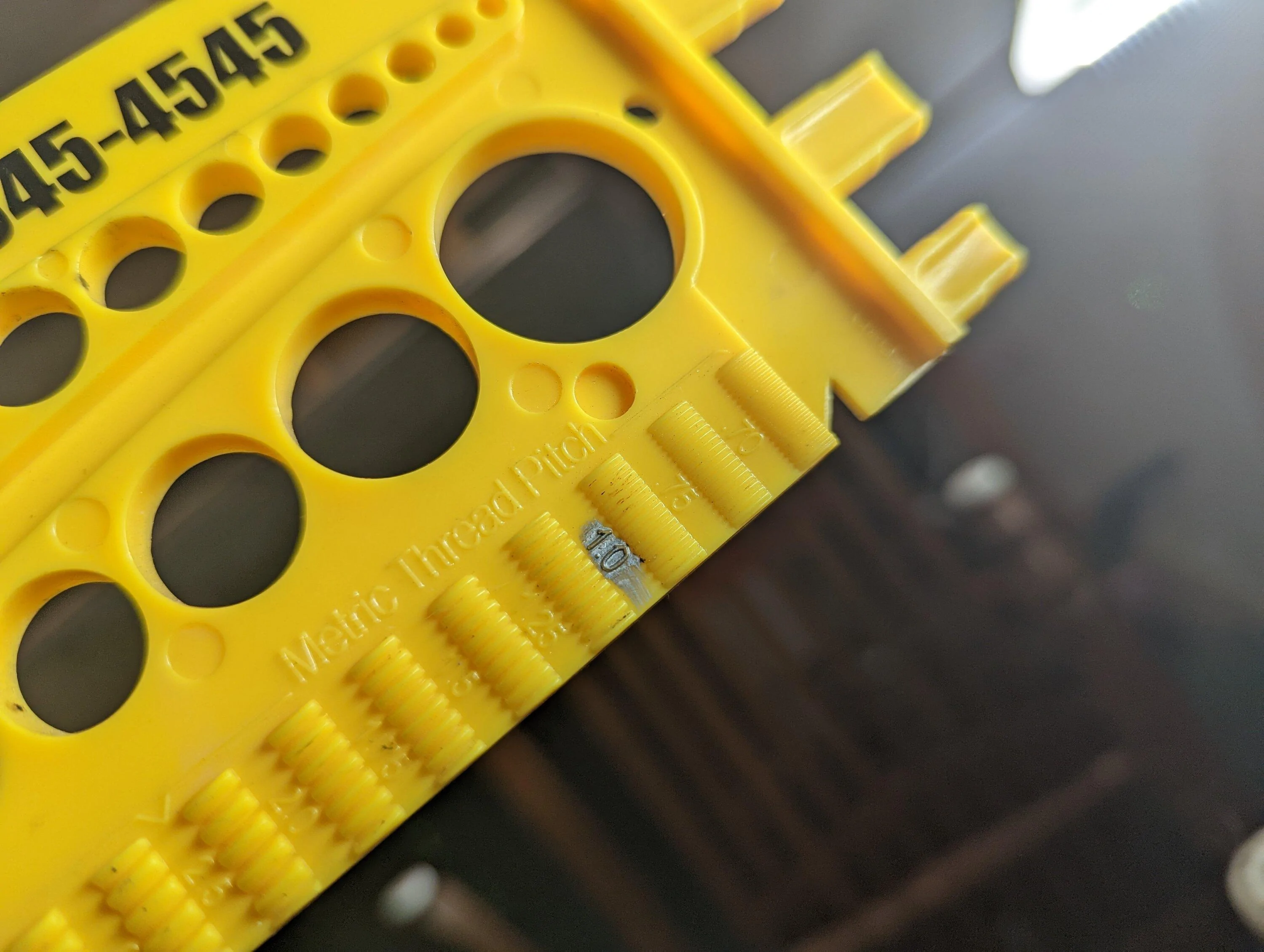

Ok so here it is. See attached pictures.
If you're going to wrench on vehicles........you need this handy dandy tool.
Buy SS hardware and add a thin coat of anti seize or die electric grease to prevent dissimilar corrosion. Plus it will keep cheap hardware from rusting and staining you paint
I'm kinda glad you didn't see where I had already posted the exact bolt size. That's an awesome tool and a beautiful effort! ?

Thanks this was extremely helpful - will be grabbing one of those for sure. Yes intended to throw some anti seize on there just to avoid problems later especially given the different dimensions on the new hardware vs. those removed.
Still doesn’t explain why these guys aren’t working out: https://www.homedepot.com/p/Everbil...17840bd88a9c9c8ba350850f0e0882e12e90b0f59c216
2 threads and they’re feeling gummed up.
Were they in labeled bags or loose stock in the bins?
People mix that stuff up all the time in HD and Lowes.

And if HD is still open grab a nut or two and see if it'll clean up the threads on the bolt.
Some of their bolts are rough.
