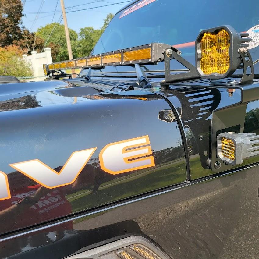

Jeep Gladiator mojave cowl light mount IMG_20210816_215548_501

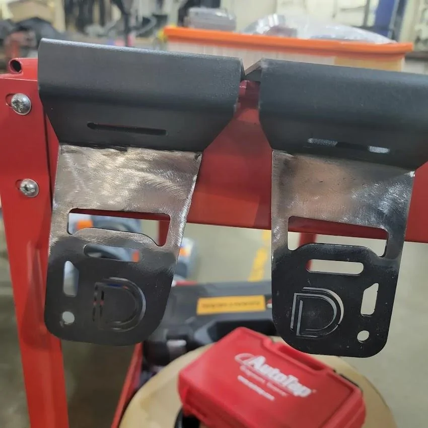

Had one of the guys at work extend the brackets by 1" to fit the Mojave...

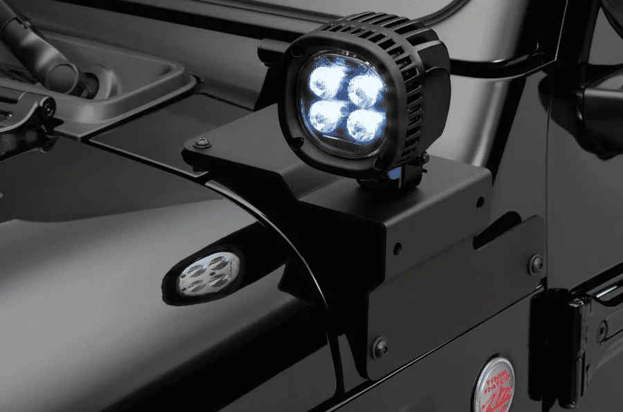

The correct MOPAR part no. for Mojave and Diesel is 8221 6213AA-001.

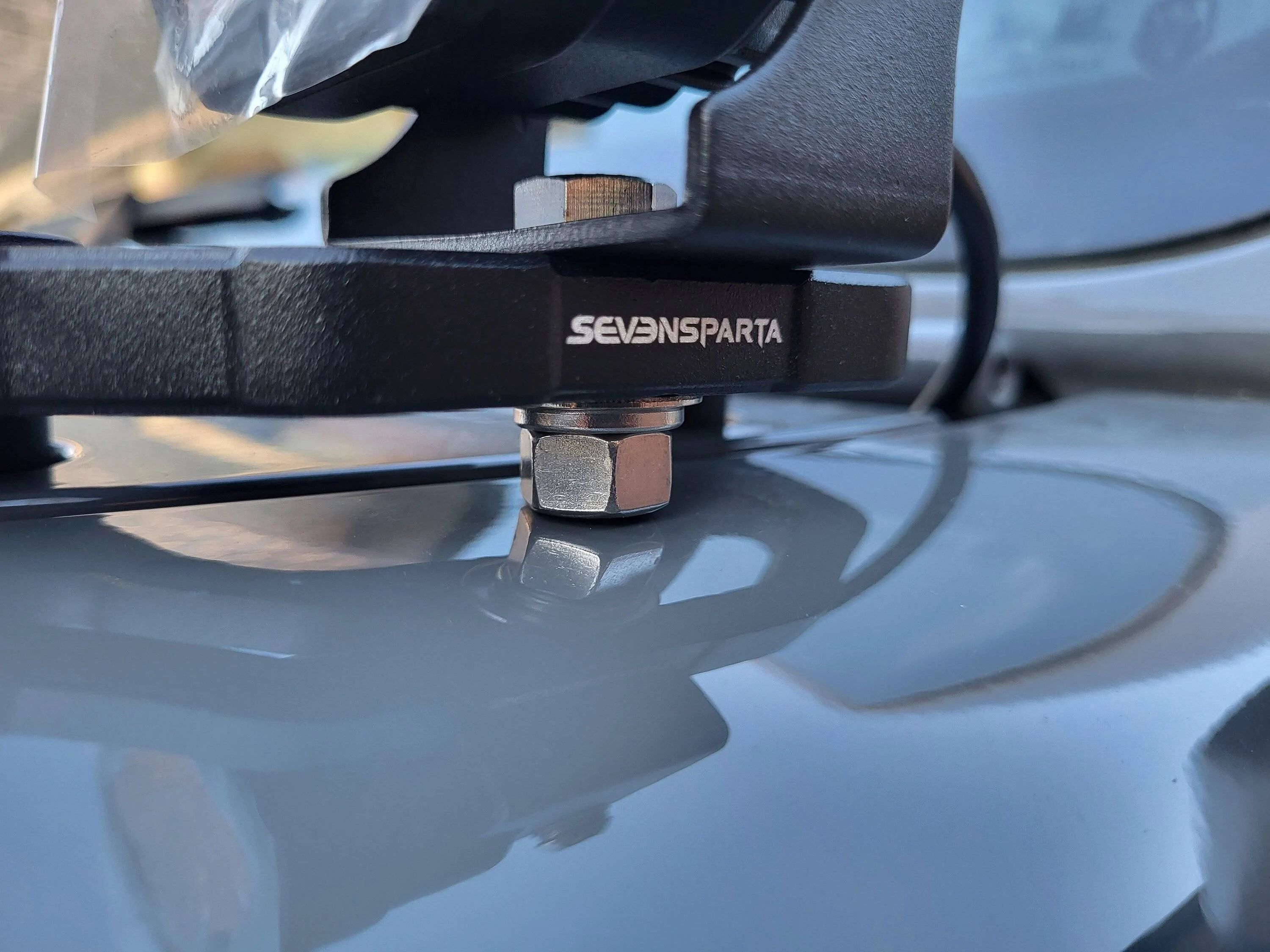

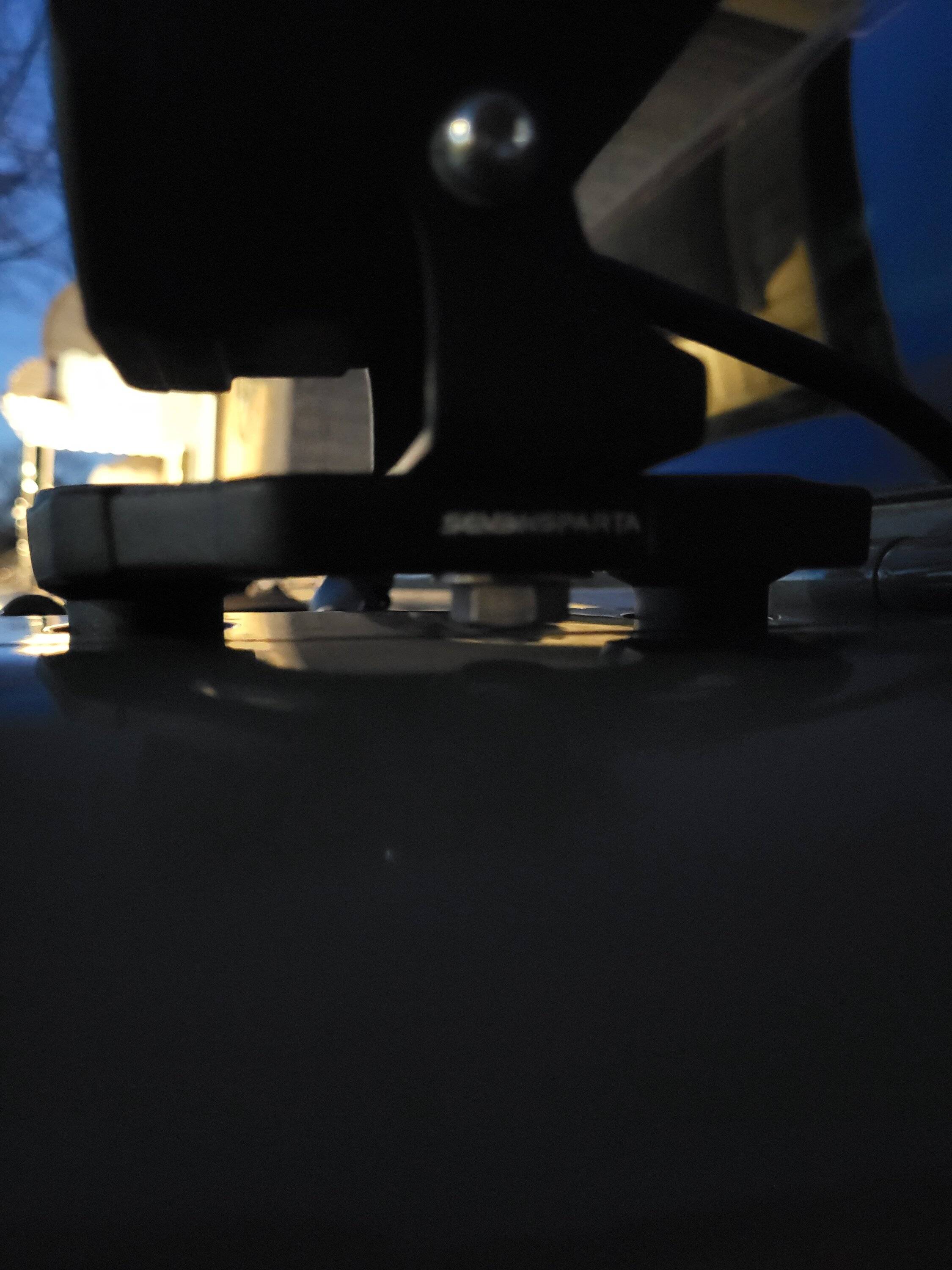

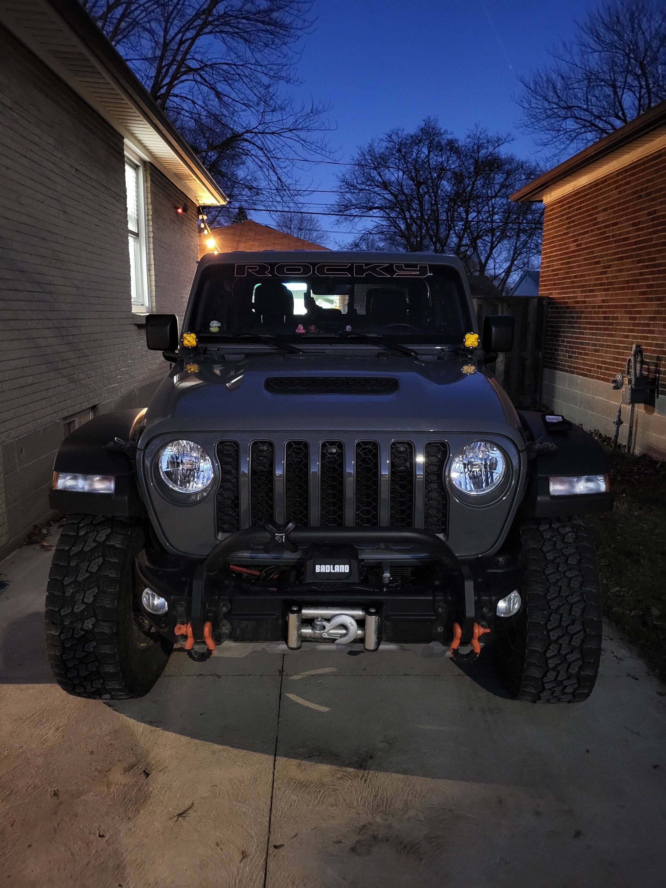

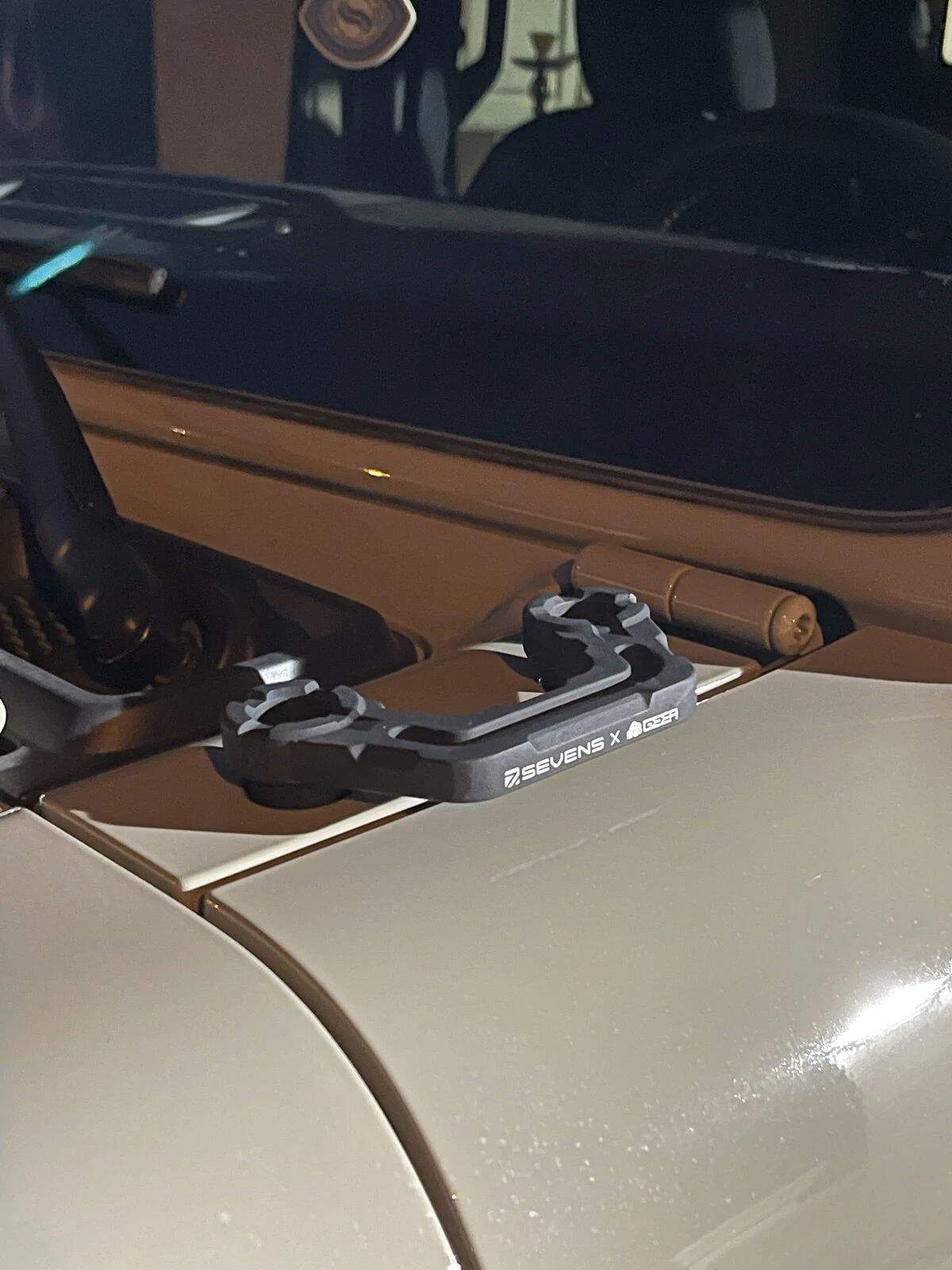

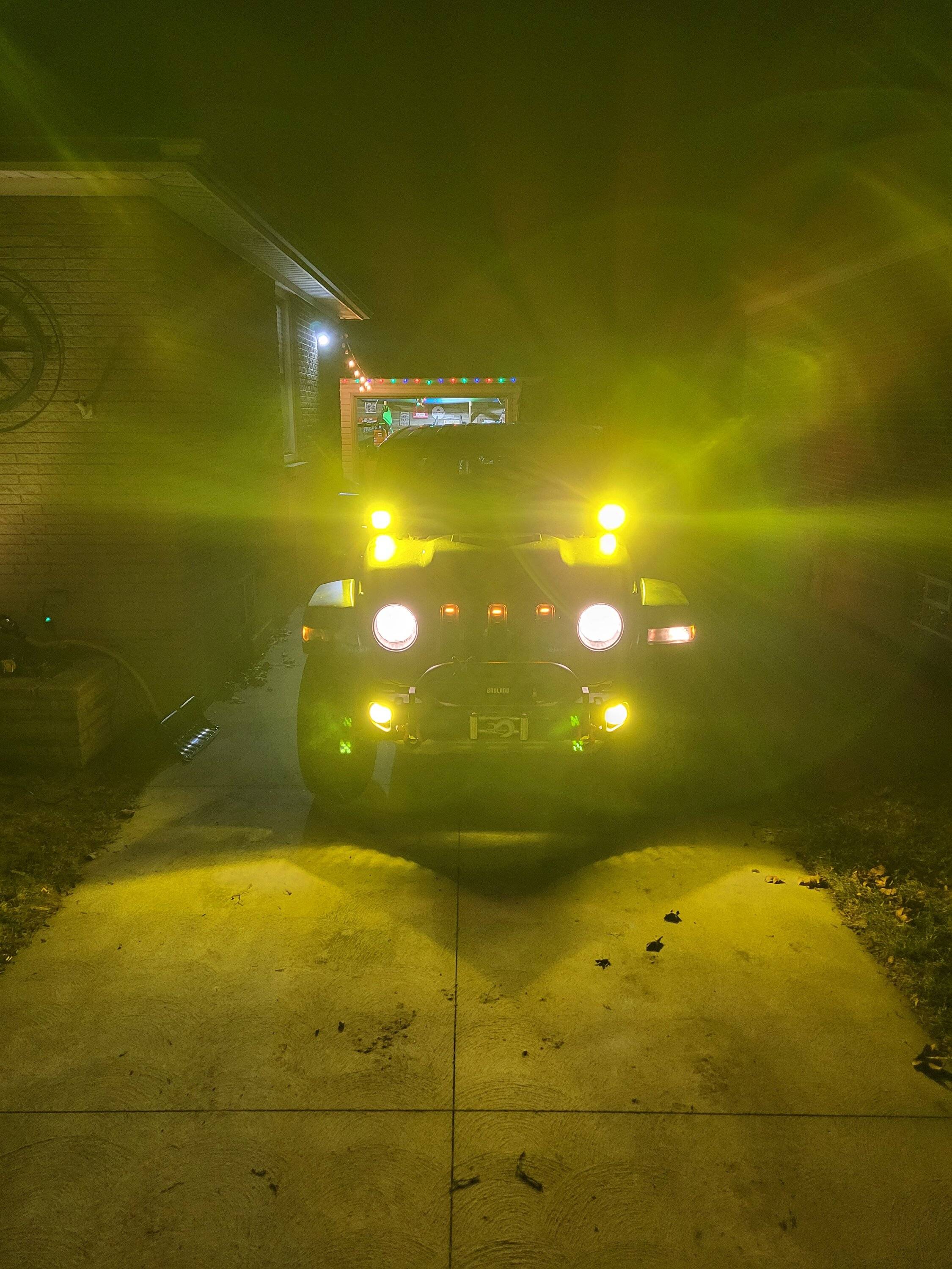

Well guys I opted to try the Seven Sparta ones off Amazon on my Mojave. With some trial and error they kind of work out of the box. I had to get some shorter bolts for my lights and bolt them up. With even just the nut on the bottom it hit the cowl and I was worried about my paint. After getting slightly bummed i couldn't us these brackets and sitting on the couch for 10 mins. Light bulb! I flipped the bolt around and put the bolt on the bottom and the washers/nut on the top. With that there is a decent gap and they are super stable. Love the "low pro" look and there is enough room for 2 3" cubes per side. Thanks to everyone for the suggestions here. Hope this helps someone else our!

I’ve never seen anybody say why the Mojave cowls are different..
Is the hood higher or something and it had to match?
The Mojave and Rubi have a taller hood.
I'll take a pic of my Mopar brackets from Allmoparparts and dig up the part number
I ordered the wrong ones the first time and had to return those and order the right ones.
Now thats thinking outside the box! The bolts on one of my kc’s was just barely touching the cowl, so i took a hacksaw to it. Flipping it around would have been a lot easier!

I also got these! Good price and you are able to use the factory bolts! 100% compatible for Mojave right out of the box. I only had to grind down the bolts for the pod lights so they don’t touch the cowl side panel.
https://www.amazon.com/dp/B08VRMZ1Q8/ref=cm_sw_r_cp_api_glt_fabc_PFNEYYKZXKVXYCT36DEH
Another vote for these. I just installed them on mine, with some rough country black series cubes last week. The mounting bracket bolt/nut for the lights on mine were close to the surface as well, but cleared enough that I'm comfortable with it. Pretty happy with these brackets, for how little they cost.
