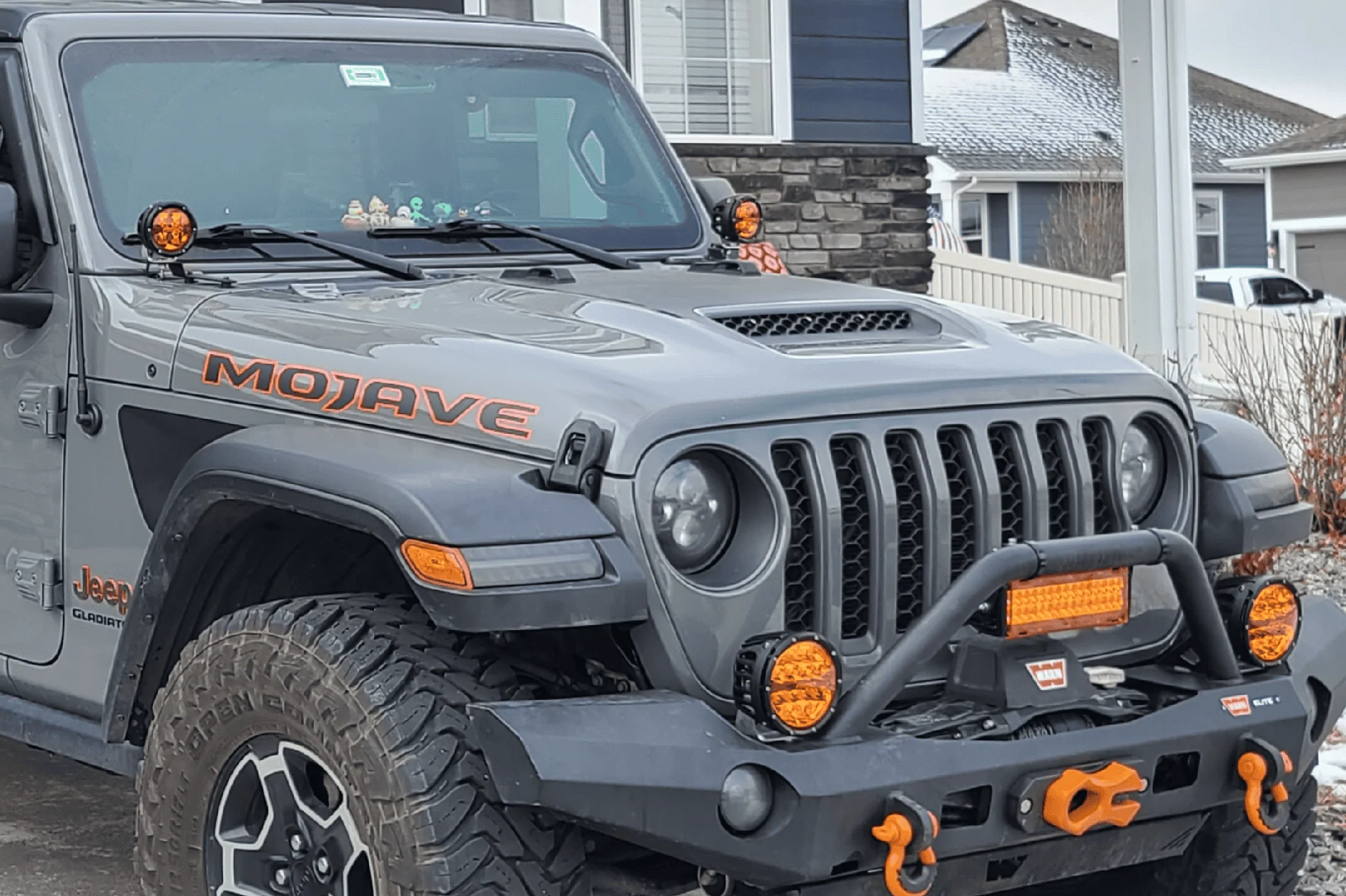

If its just the hardware you need M6x1.0 - 80mm, I have about a 1in hard rubber spacer between the hood and bracket, you can get away with shorter if you dont have that. I went with stainless hex bolts, I tried the black allen wrench type which look cool but they didnt take long to rust. If you need mount options, I used Rugged Ridge Cowl Cube Light Mount; Outside Mount (20-23 Jeep Gladiator JT) They are very sturdy no vibration or movement.
