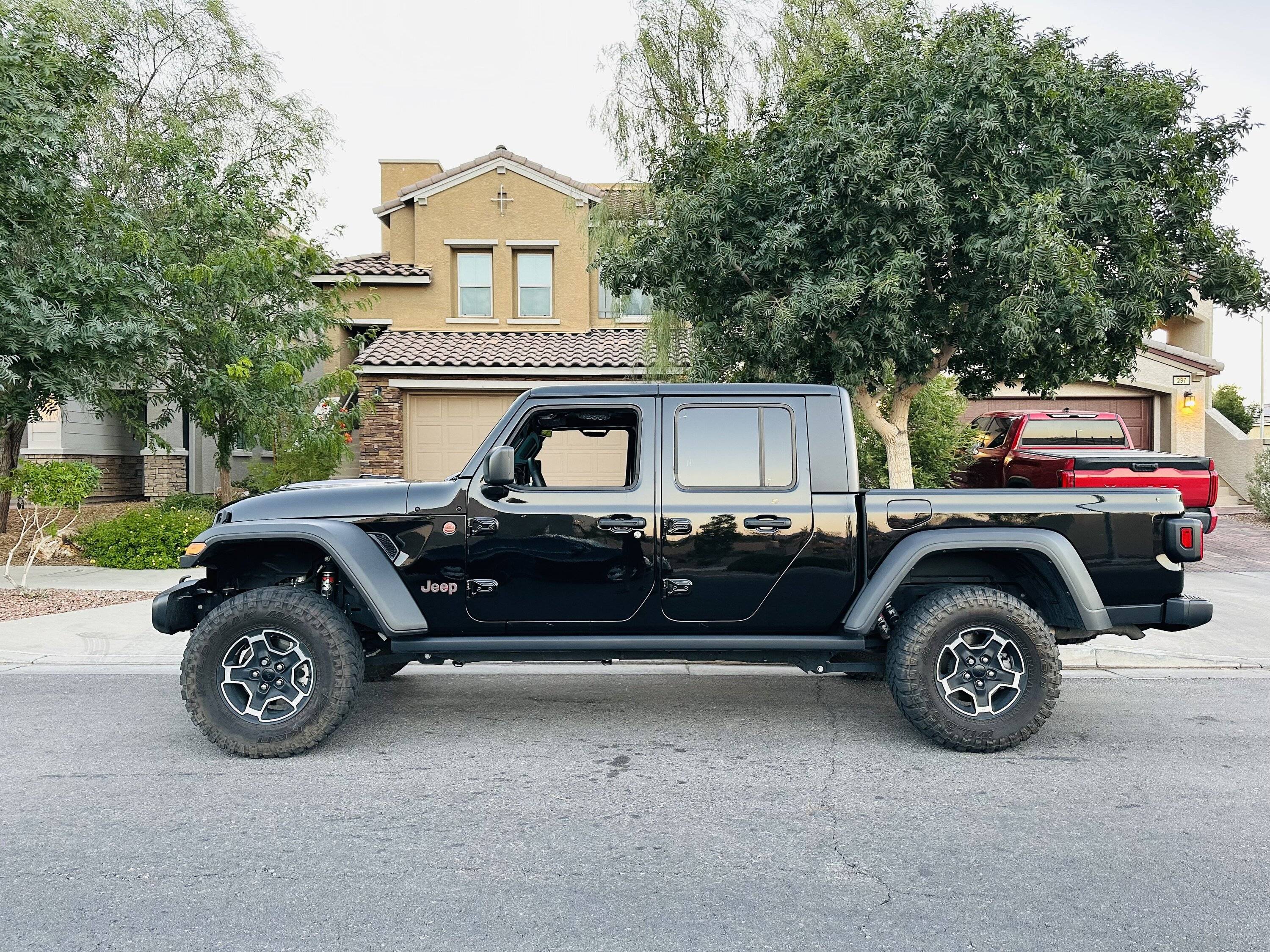

Did the kit also level it or did you still need to level the front after the 2" lift?
Lift and level.
Great kit (Mojave specific) even with my rack, basket, recovery boards and light loads (+/- 200 lbs) its stays dead even/level

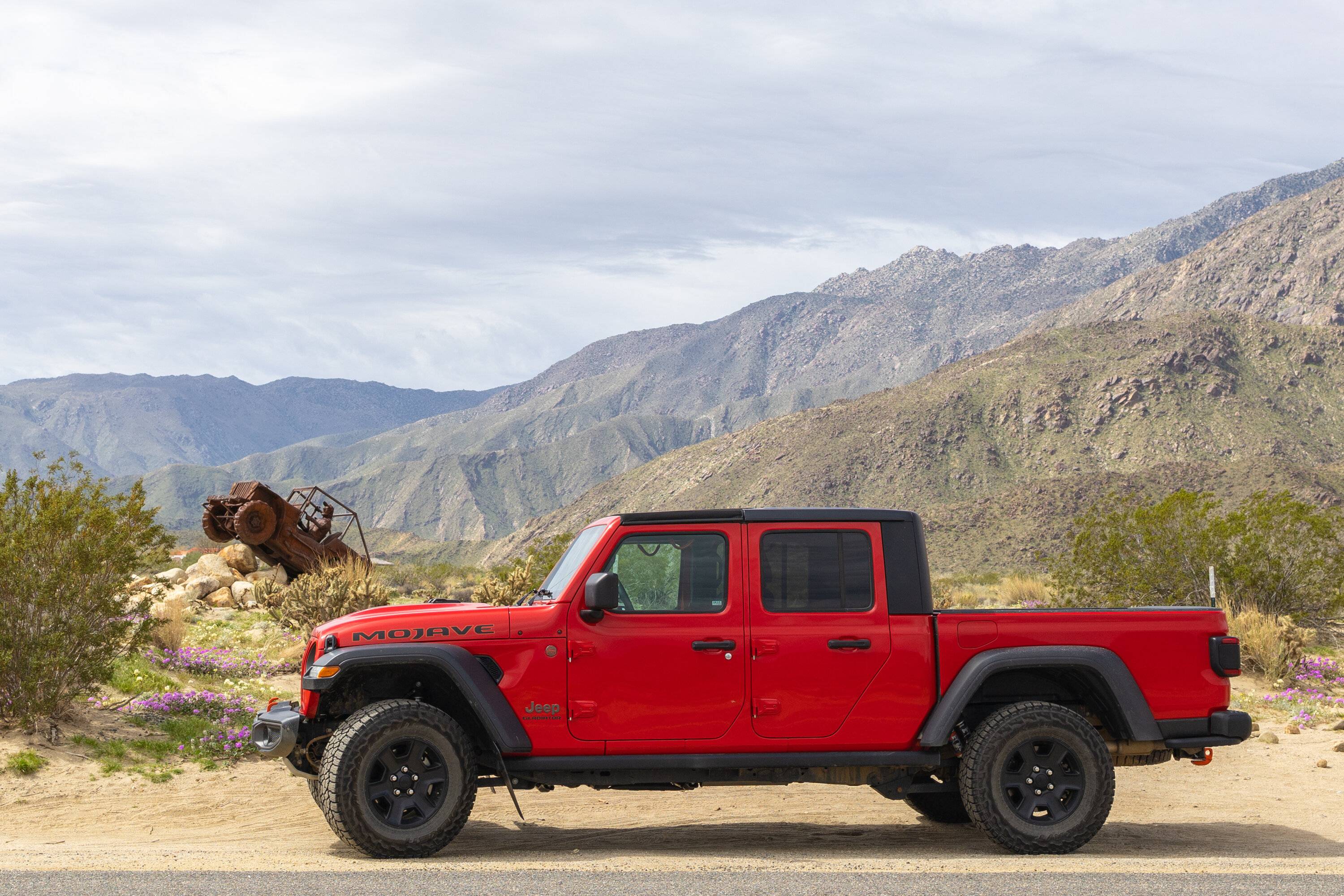

Mine was level new.
If your front is a little low just throw the Rubicon rear bumper and bed sliders on.
Stock Mojave with only Rubicon bumper group and Apex discs in the front. Every Mojave needs that bumper imo - too easy to tear up the back with the chitty plastic bumper and no bed protection.

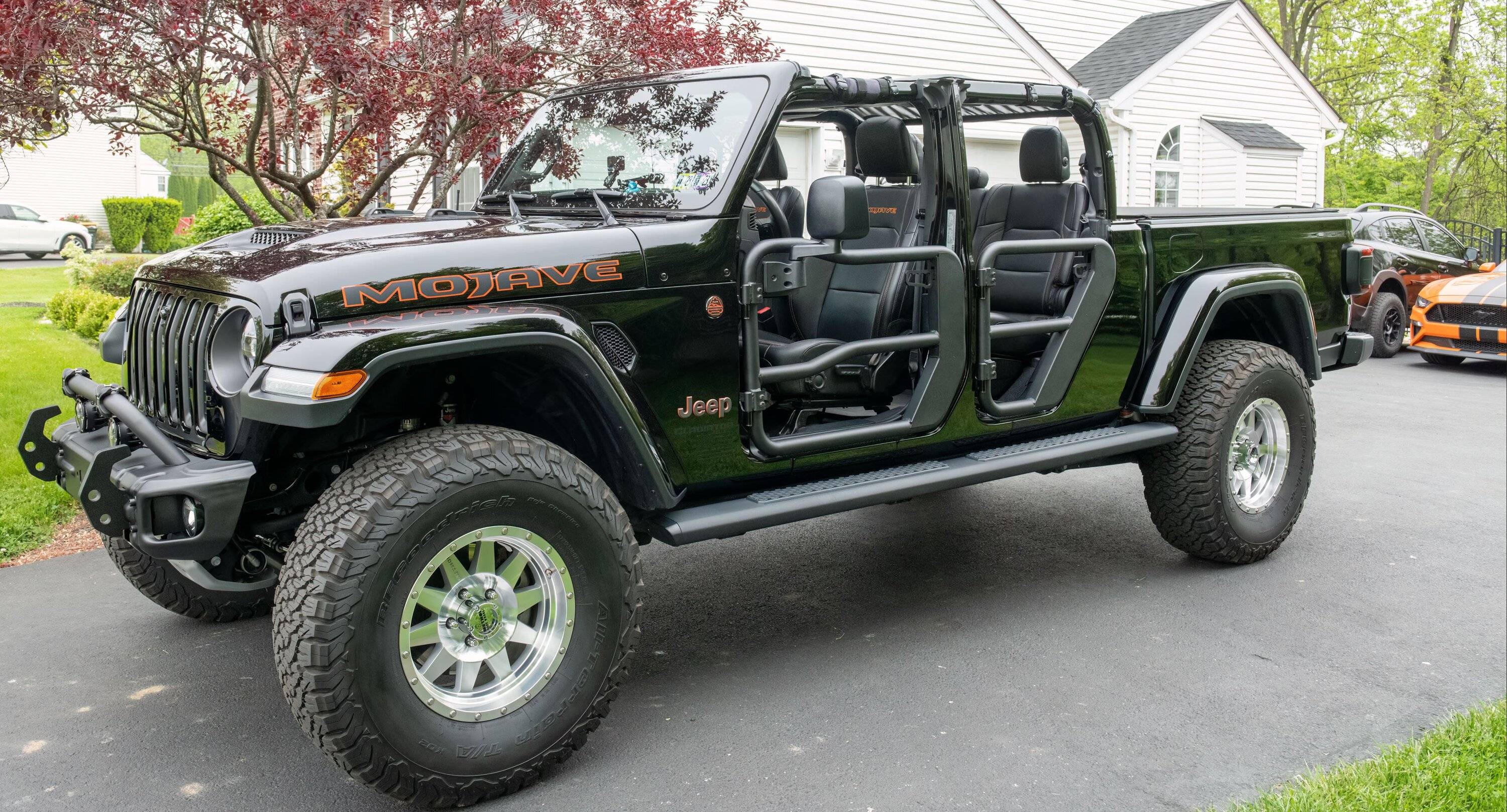

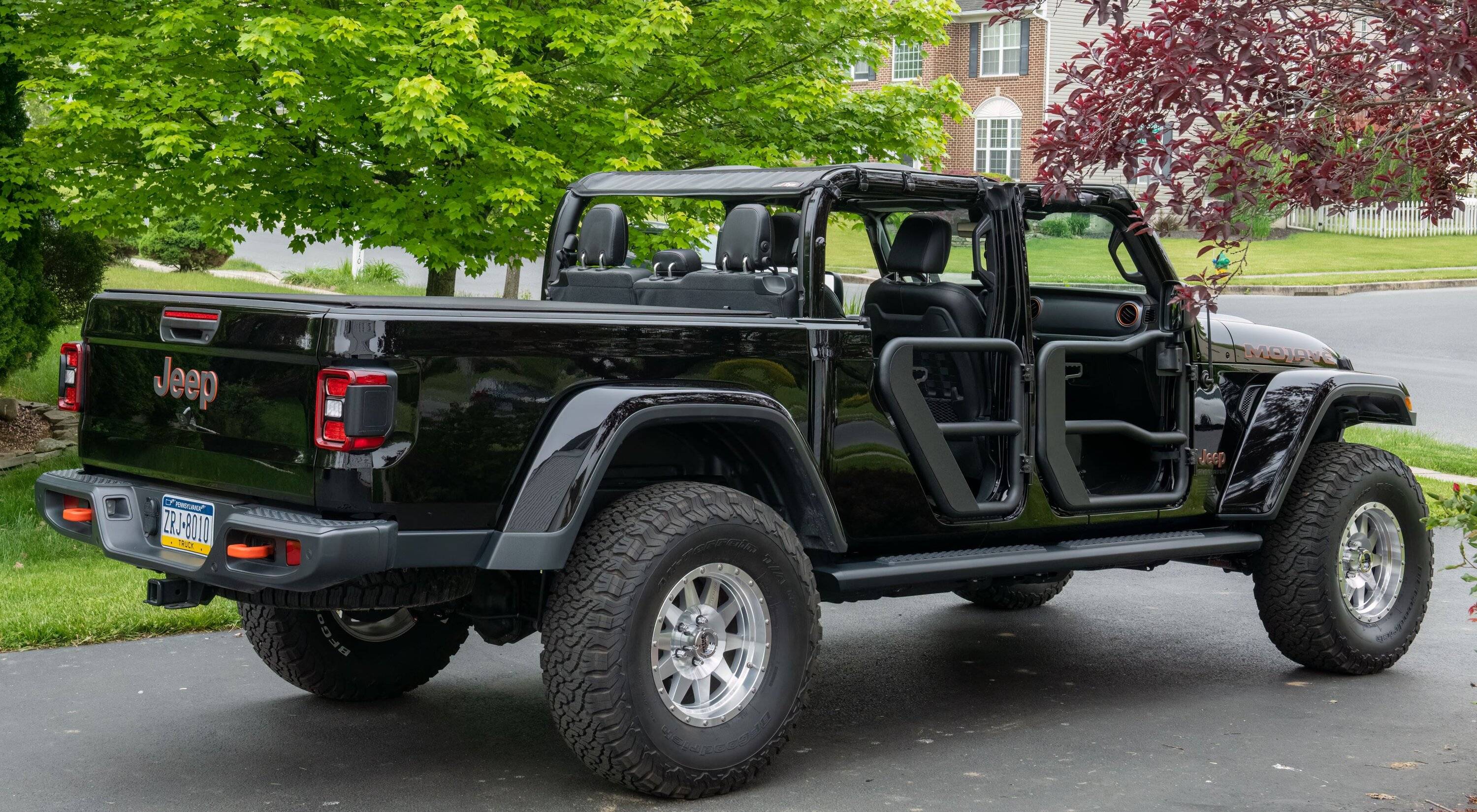

A 1.5" leveling puck may only push your axle out 1/2" to 3/4" and none of the track bars available might be capable of adjusting for that since they are generally built for 2" and up lifts.
Mine with the 1.5 teraflex was off by 3/4", I installed a Core4x4 0-6" track bar and centered no problem.

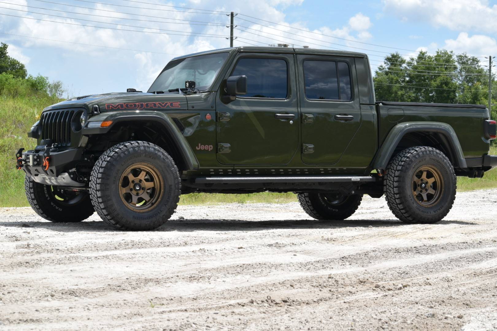

I did the AEV 2" spacer kit on my 2023. Haven't addressed LCAs yet as I'm considering control arm drop brackets instead. Even with the stock arms it drives well on the street.

Looks good but I forgot to ask you, how’s the axle offset side to side? Is it noticeable?
No issues turning with the 37x12.50’s on stock wheels?
The front is off center about 3/8". Turns and drives without issue. Eventually I'd like to add the rock krawler pro-x triangulated 4 link out back to center the axle and get rid of the rear track bar. I'll probably add an adjustable track bar up front too. I wasn't planning on building this one as we already have the jlur on 39s, but I couldn't pass up the deal on the 37s and it's snowballing from there.
