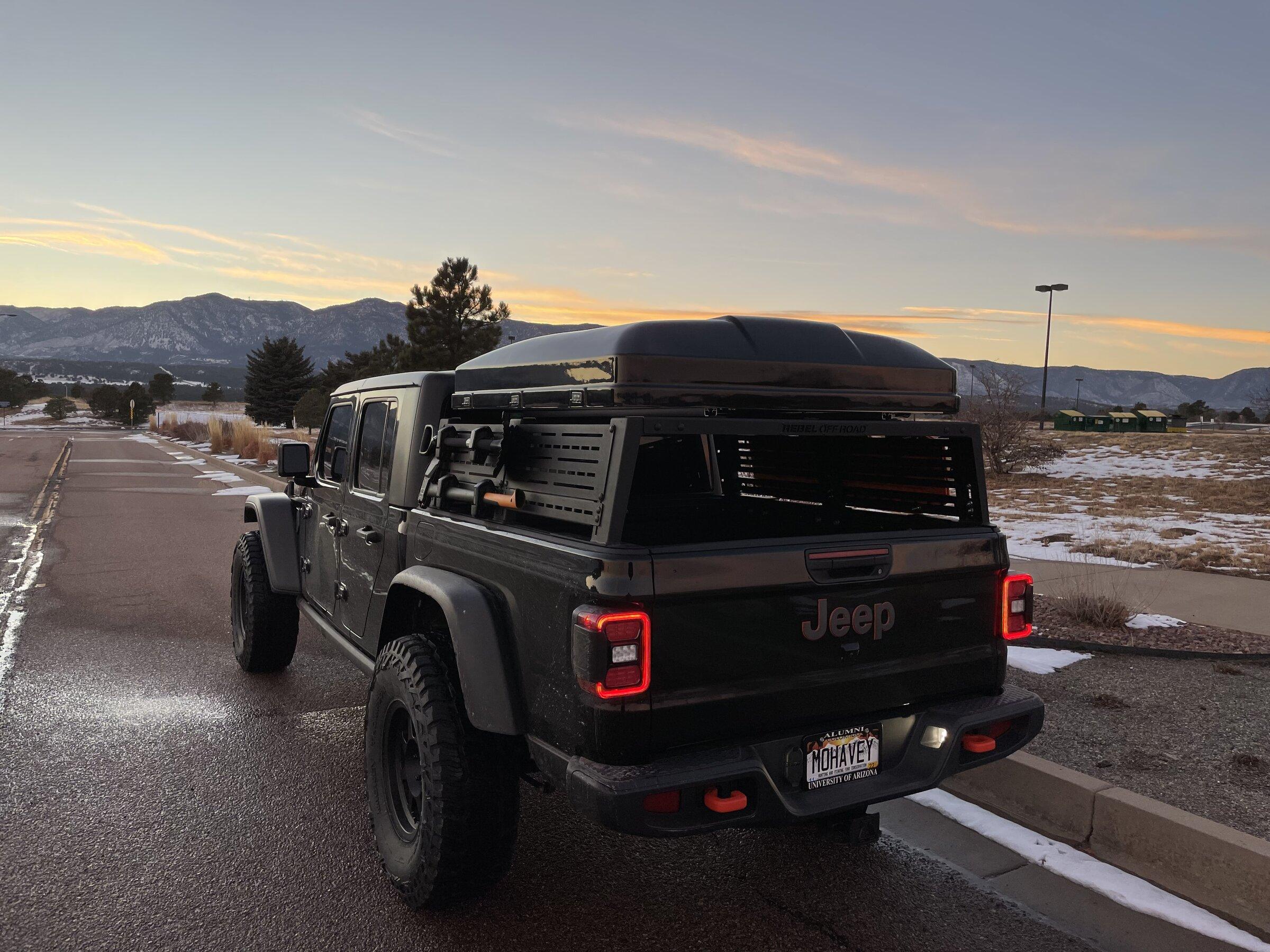

Unless you really want the lift or the look, 35’s fit perfect without a lift. Im running 37’s and have no rubbing and great articulation (with a fender chop) and left the suspension fully stock.
(Im beefing up a lot of components but height wise will remain the same)
Jeep Gladiator Mojave + Level Kit? 93766B3A-79E0-49C6-9A41-A501909B82CA
Man, that setup looks great! Might have to jump to 37s, wasn't sure I wanted to re-gear but it might be worth it

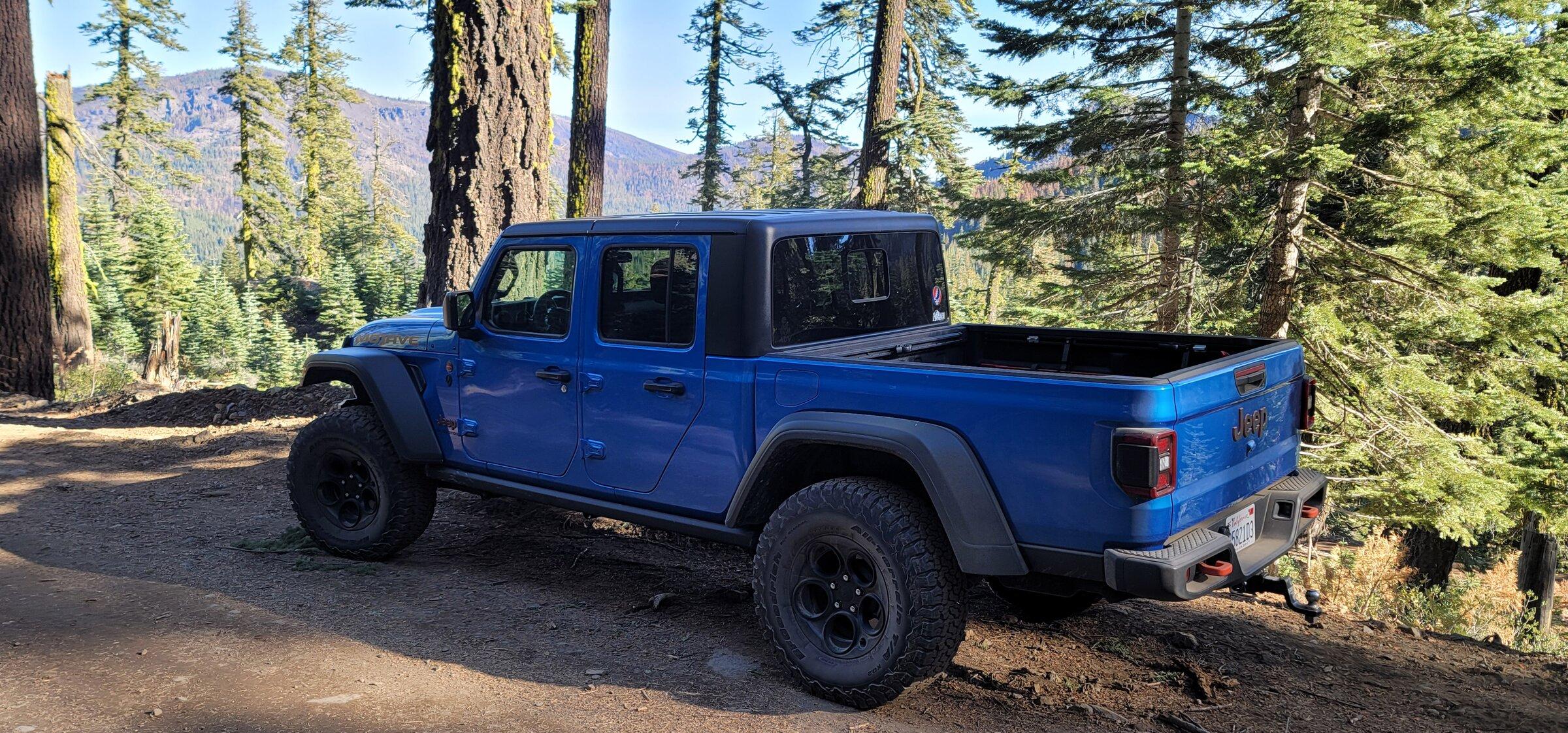

I have the AEV spacer lift. I’m on 35s now but plan on going to 37s in the future. For what it’s worth I think my Mojave looked great on 35s with no added lift.
Jeep Gladiator Mojave + Level Kit? A223F65B-A993-426D-AEE9-A0C42F90318A
I’ll regear at some point but the 4.10’s are fine with 37’s. A regear will be nice, but its not as bad without it as some people make it out to be. From 33’s to 37’s there for sure is a loss in power, but from daily driving city and highway to offroading… the 4.10’s get the job done
The blue with those aev wheels looks soooo good
Did the AEV spacer lift take the front rake out?
Tuggernuts
Scott
Oct 29, 2020
654
1,154
NorCal
Ram 1500
Truck driver
No. Doesn't seem as pronounced but it's still there. Mind you I have an aftermarket bumper and winch.
