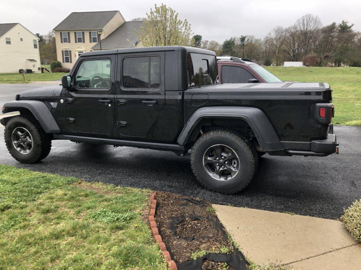

yep. As far as I was concerned it appeared perfectly level, but it did not appear nose high with a bed full of mulch bags..unlike lifts that just lift the front.
Jeep Gladiator Specific level kit questions. oyKaI2FGTyKUqFZ9fho7Jw
1.5 / 0.75 lift combo with 285/70/17 tires on rubi rims.
