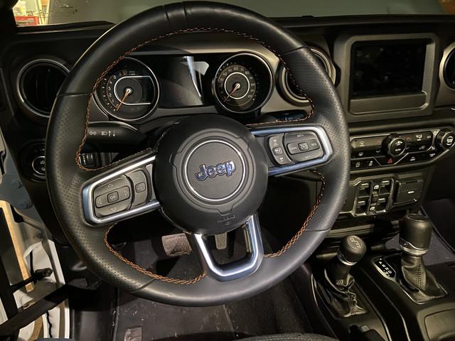

Genuine question: is the steering wheel actually different, or just wrapped differently, with the perforated leather and Orange vs Red Stitching? Is it flat bottom or something?
It's thicker and has bigger thumb pads.
