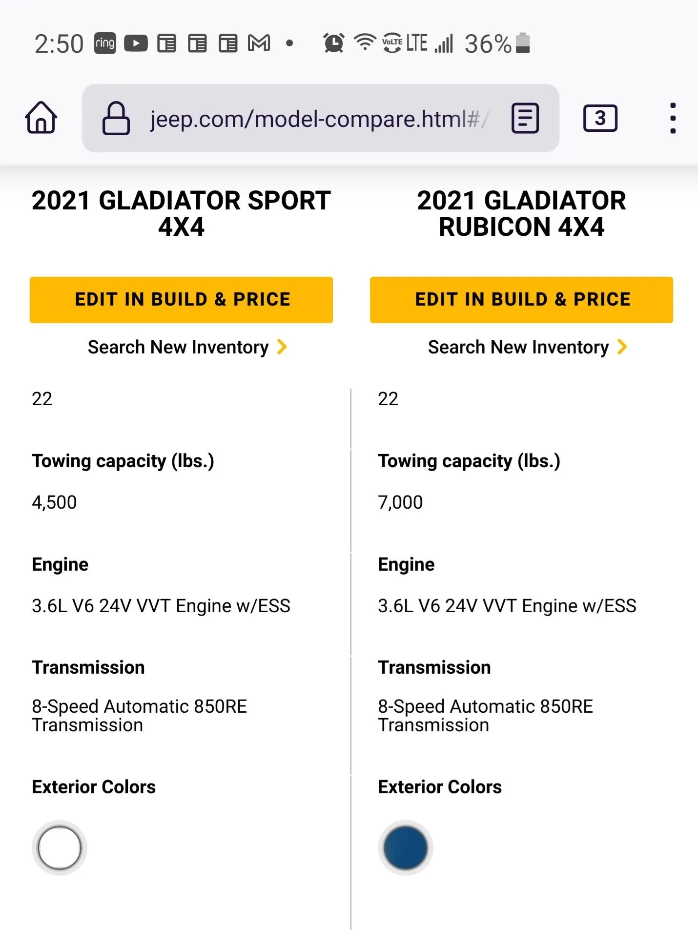

FYI, Auto Sport (and Sport S) w/tow package (not Max Tow) - 6000
Without the Tow package - 4500
Cool. I thought that seemed kind of low from when I was in the market. I just got my numbers from Jeep.com, which is apparently incorrect. It doesn't add anything for the tow package on the Sport (S)
I trust your numbers though. 4500 seems low. Post edited
