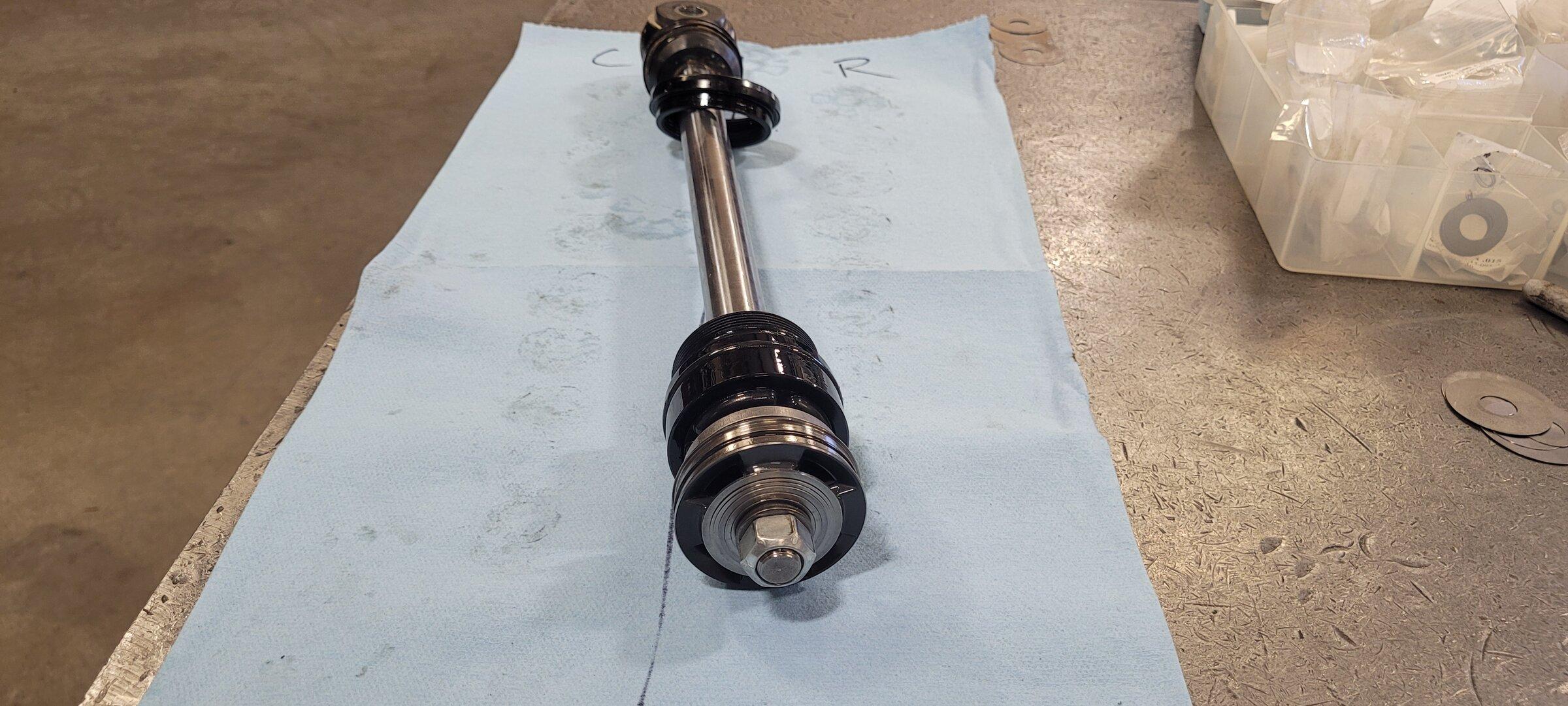

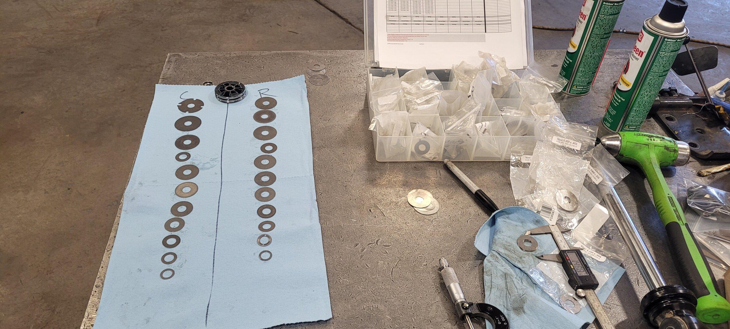

So whats involved with disassembly refresh of fluid and seal and where do you find info on this particular shocks like fluid amount and pressure.
There is no info or manuals because Fox doesn't share it or claims to not have it. I've been learning on my own with the help of Glamisfan. Insane if you ask me, but all the tuners are keeping the info close so we NEED them.
My project today was more tuning in the pursuit of perfection.....
Jeep Gladiator Mojave Shock Rebuild timeframe from Fox = maximum of 50,000 miles 20220430_101738
Jeep Gladiator Mojave Shock Rebuild timeframe from Fox = maximum of 50,000 miles 20220430_102031
Man that looks kind of fun.
That picture Reminds me of MX shocks I used to fiddle with years ago. Same thing there too. No one shared "secrets". Not that Ill ever mess with it but is the bypass adjustable to any degree?
BTW I agree a maxtow gets 90% of what most drivers ever need. I got this Mojave because I wanted a MT with 4.10 axles then discovered after the fact what a fantastic little machine it is.
This has turned into an obsession now that I understand how it works! I am pretty much over the r&r of these things, but I'm closing in.
I know almost nothing about the OE internal bypasses, I'm sure you could tune them just like anything else with the right parts and a lot of time.

A call to Fox sales and you "Should" be able to get a list of parts within a couple of days. Good chance they wont have every part you need in stock as that's been my problem and they wont let you back order anything........The whole process has been very frustrating.
"Expertly tuned" is pretty subjective. The mall crawler wants something different from the guy desert running and the rock crawler wont like what the towing guy needs! I also cant see how a tuner could really get you "Expertly Tuned" over the phone without a full checklist questionare, corner weights and selling you both springs and shocks. Shock Therapy seems to have a pretty good handle on these needs for the SXS crowd....Maybe they will be able to do the same on the trucks? Imagine being in my shoes $5-6K deep into high end shocks/bumps but its garbage out of the box?
Meeting Fox or Acutune out in your terrain of choice and doing an on site revalve would be pretty cool.........If I lived close to them, I probably would have stepped up to the pay window and gave them a try. Instead I'm teaching myself to do this and will probably be providing this service to my clients who are more picky at some time. I already have a shock dyno picked out.......
I can tell you just going from Evo to Clayton front springs required a complete revalve of my front shocks. OE Rubi springs to 2.5 Clayton's was pretty strait forward till I wanted a little more precise handling in varying conditions.
