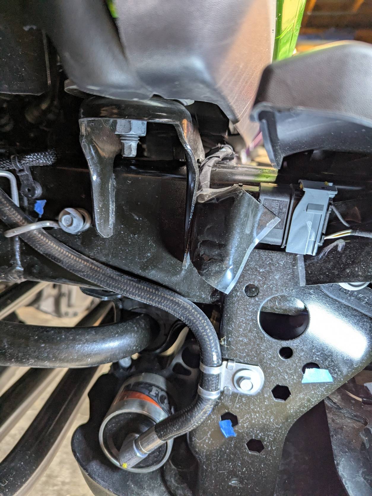

I have to relocate the shock reservoirs on my JT to accommodate the snow plow mounting brackets.
The skid plate has to be removed when the frame brackets are in place (I typically only leave them on through the winter although Western says those stay on all the time - sorry, I remove them)
I'm looking for ideas on how/where to route the hoses. The parts the hoses route through and which hold them to the frame have to move or be removed. They will be in the way for the snow plow brackets.
Has anyone here relocated the reservoirs for other reasons, and re-routed the lines/hoses? Will this even be possible without buying new lines???

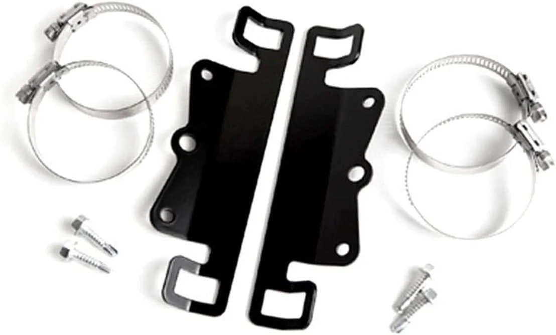

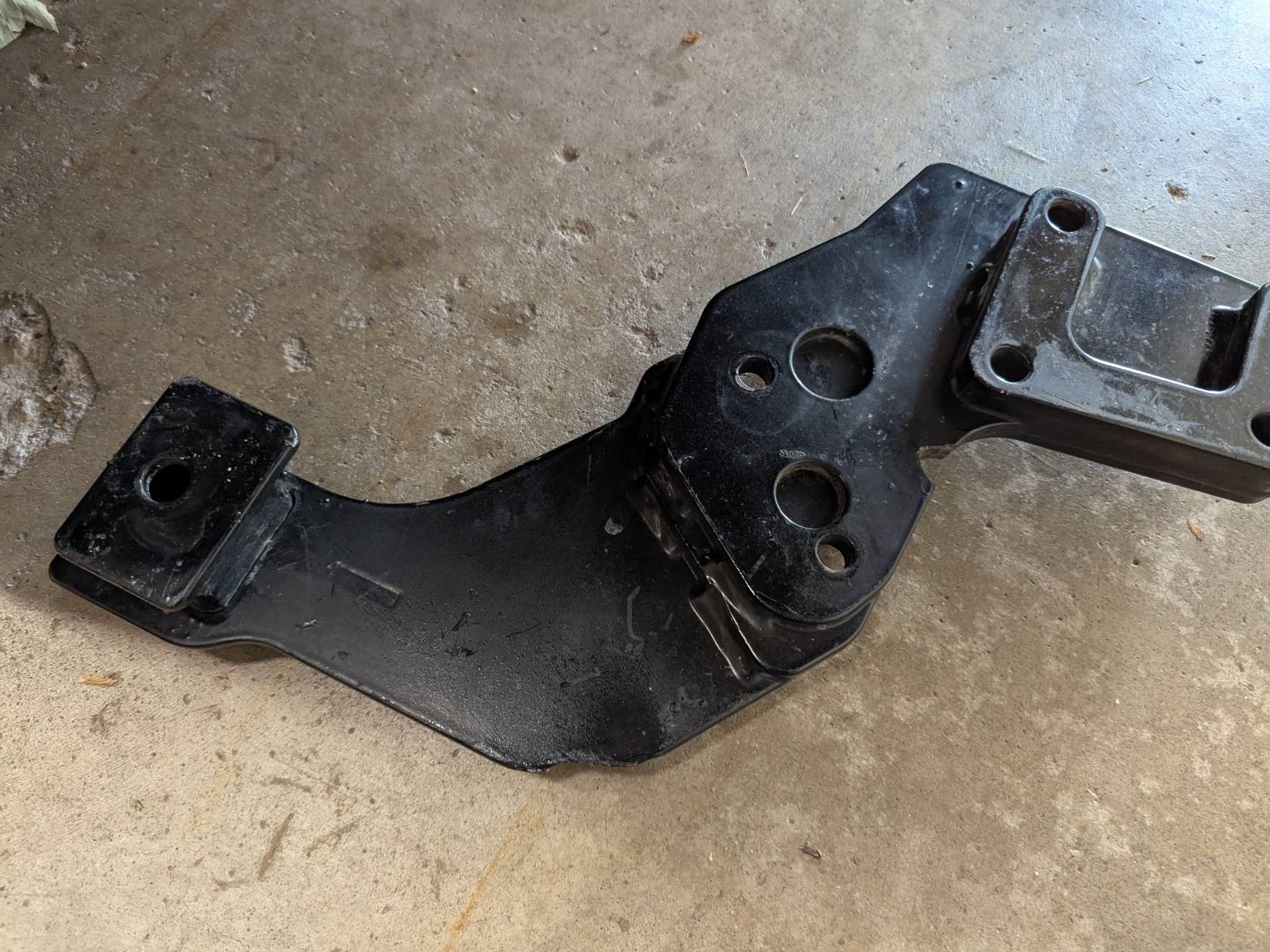

I have brackets. This is right after I powder coated them (some of you may recognize these - they bolt on where the sway bar mounts to the frame) -
Jeep Gladiator Mojave shock reservoir relocating questions PXL_20250611_213923904

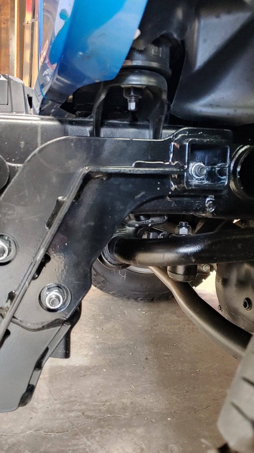

I must have the area where the tape marks these three frame holes clear for the plow brackets -
Jeep Gladiator Mojave shock reservoir relocating questions PXL_20250620_161833518

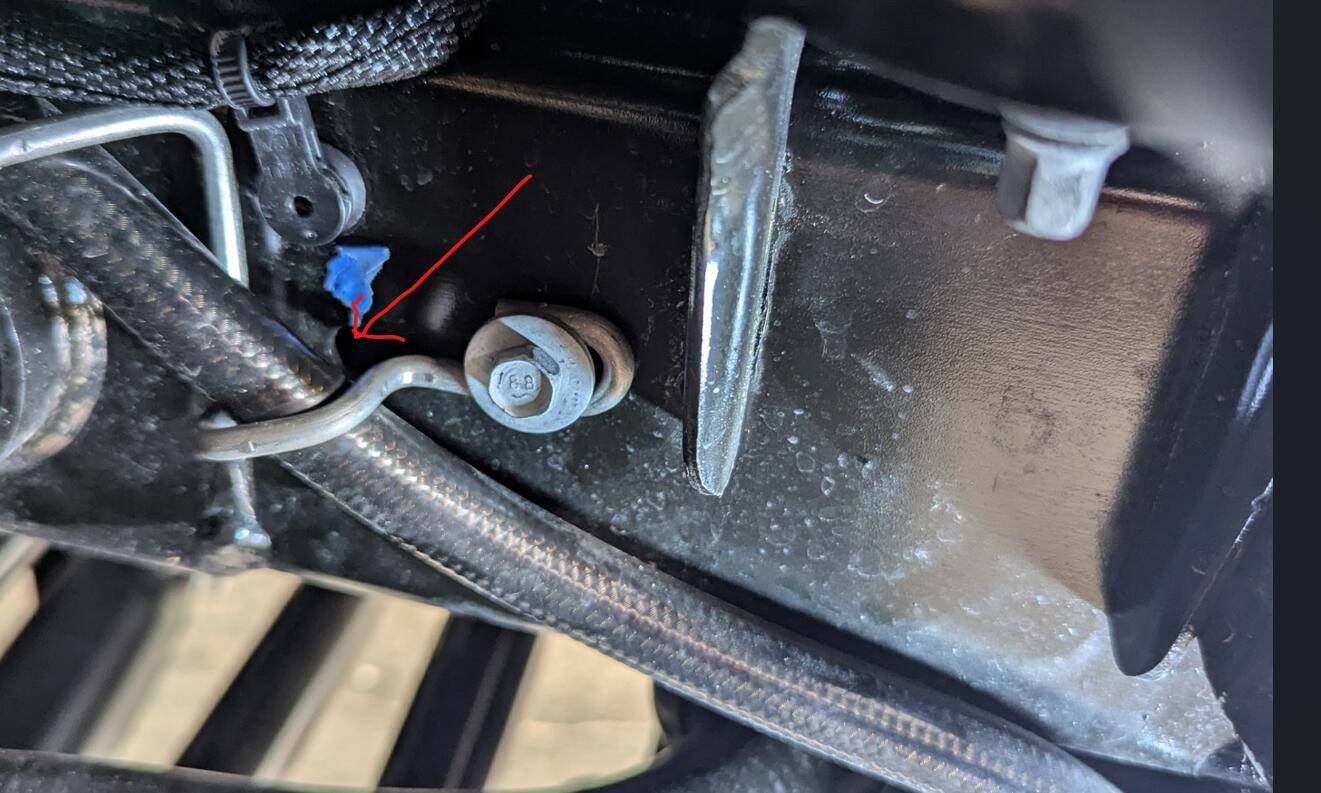

This hole is the other - hard to see in the pic above as it's partially hidden under the hose -
Jeep Gladiator Mojave shock reservoir relocating questions 1750446862840-fd

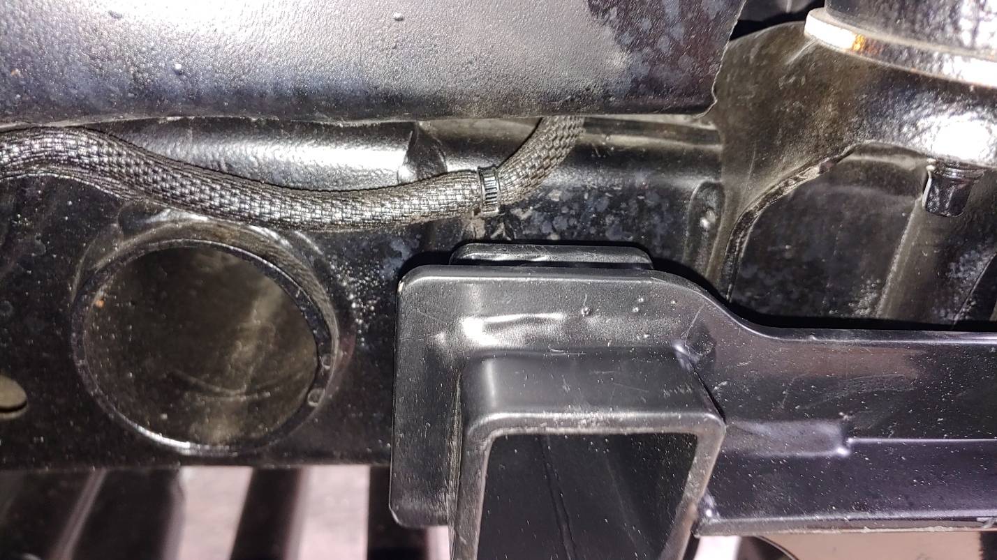

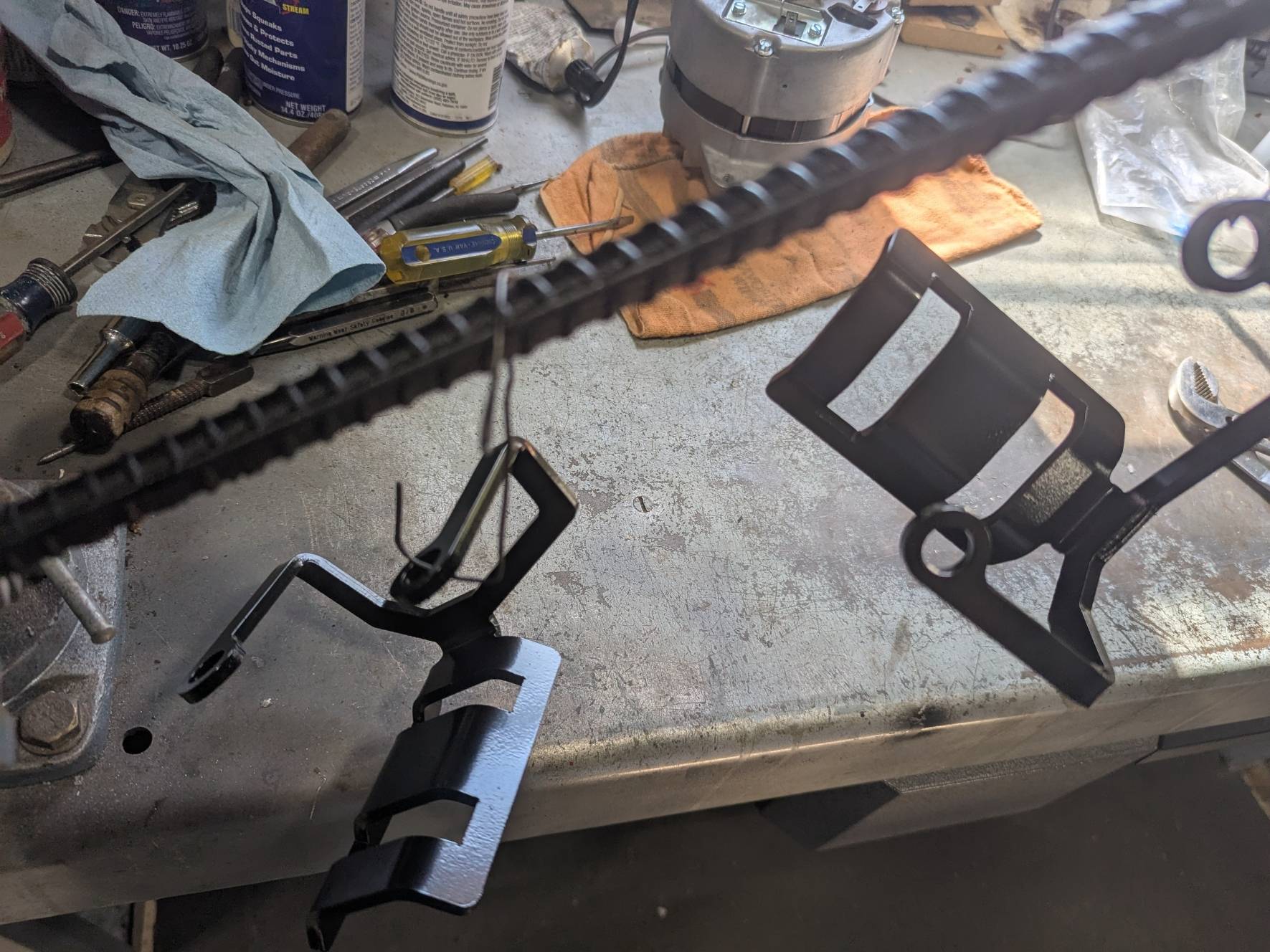

This is how it was on the 2022 Overland to give some perspective -
Jeep Gladiator Mojave shock reservoir relocating questions PXL_20240307_172327911
Jeep Gladiator Mojave shock reservoir relocating questions 20221009_091506_HDR

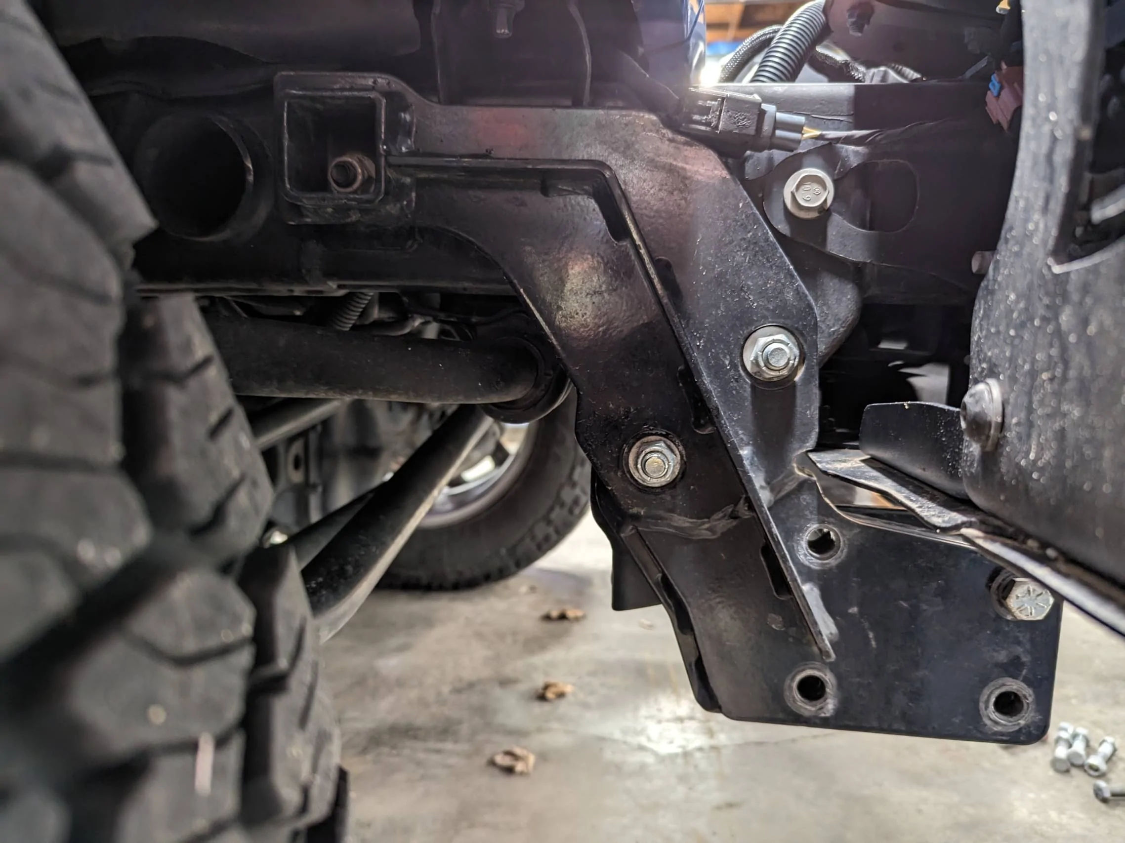

From the photos it looks like you could move the lines to the outside of the plow brackets and mount the line retaining brackets to threaded holes that you make in the plow bracket. Or, maybe you can make short extenders to the existing line brackets to move the lines (?) It seems that the plow brackets must sit tight on the frame, and that would be why the first approach is probably what should be pursued.

The brackets do need to bolt flat to the frame, but the frame isn't totally even.
The downward parts of the frame sit proud of the main frame rails. The brackets account for that.

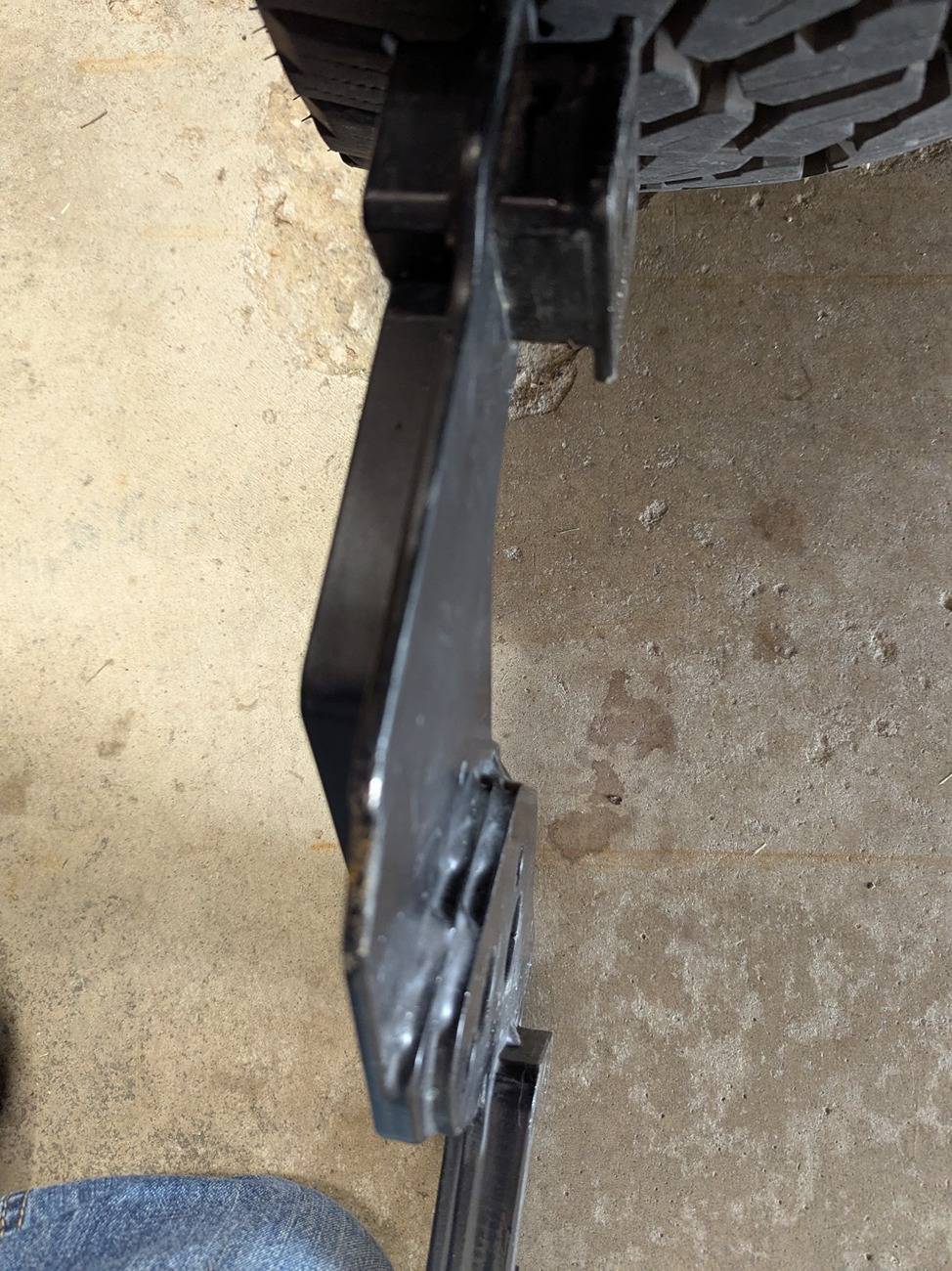

Jeep Gladiator Mojave shock reservoir relocating questions PXL_20250622_130324184
The plow mounting rail bolts to the part on the far right with the 4 holes and reinforcement.

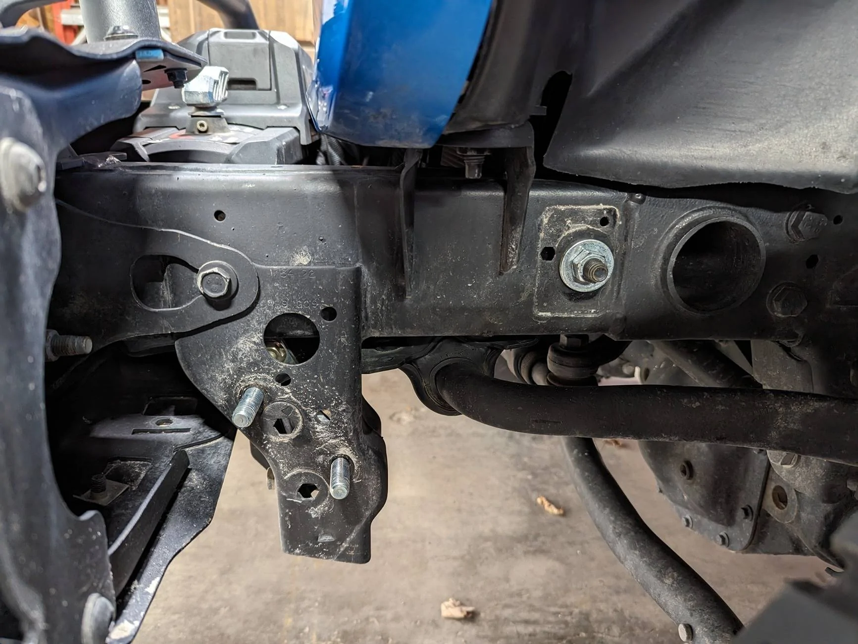

Jeep Gladiator Mojave shock reservoir relocating questions PXL_20250622_130310187
Here's the bolts that hold the plow brackets and you can tell by the dirt pattern where it hits the frame.
Jeep Gladiator Mojave shock reservoir relocating questions PXL_20240307_173246687
Jeep Gladiator Mojave shock reservoir relocating questions 20221005_144917
