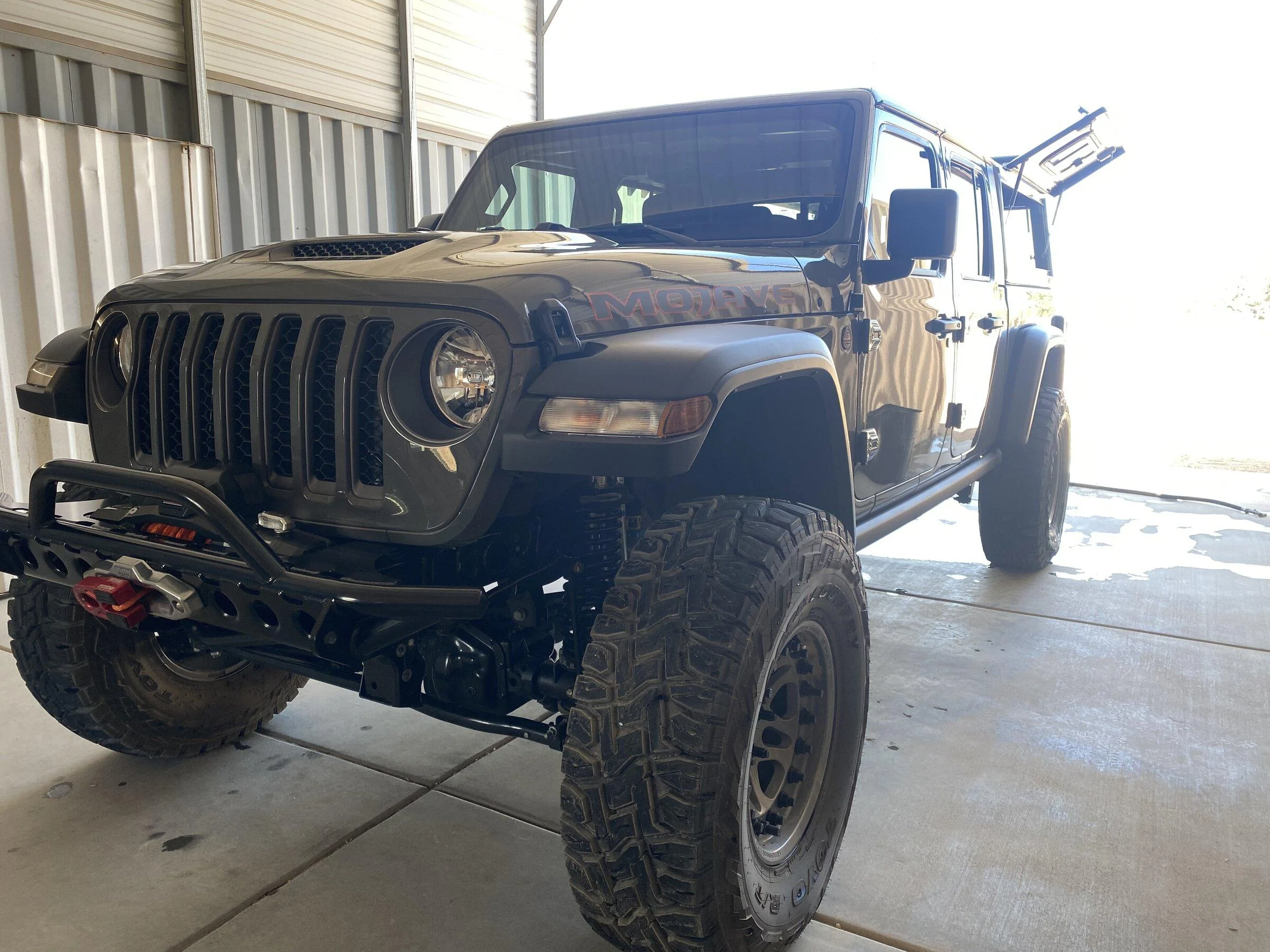

Right on. I had 37 on my Mojave for a week before my lift installation and it was fine on the street. I’d never off road it that way nonetheless
Jeep Gladiator Mojave suspension question AE3F7F07-D230-43A5-A074-5AD7E715AE0A
this is with a 2.5” lift

What lift did you go with? Did you change the shocks? Lots of folks are wheeling it with no lift and 35s, but I wouldn’t try 37s. Yours looks sharp!

Thanks. I have an Evo stage 4 with 2.5 kings. My intentions were to keep the factory shocks and get a spacer lift… but then I got bit by the bug. I actually have a currie rock jock 2” spacer for the jounce and 4 shock extensions in gonna let go. Had them on for a couple hundred miles
