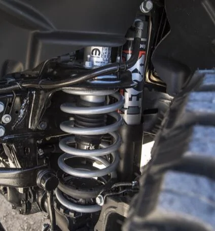

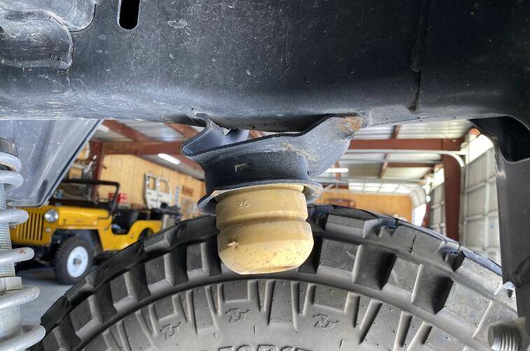

Does anyone have a picture of the front and rear bump stops on their Mojave? I want to make sure I pick up all the parts I need and have not been able to find a picture of the actual parts. When I look up pictures it's mostly advertisements that pop up.
The rear Mojave bump stops are the same as what you already have on the Sport:
Jeep Gladiator Sport Suspension -> Mojave Suspension Screenshot 2024-09-10 at 12.05.44 PM
The front Mojave bump stop is the hydraulic post mounted to the top of the spring tower and extends down inside the front springs:
