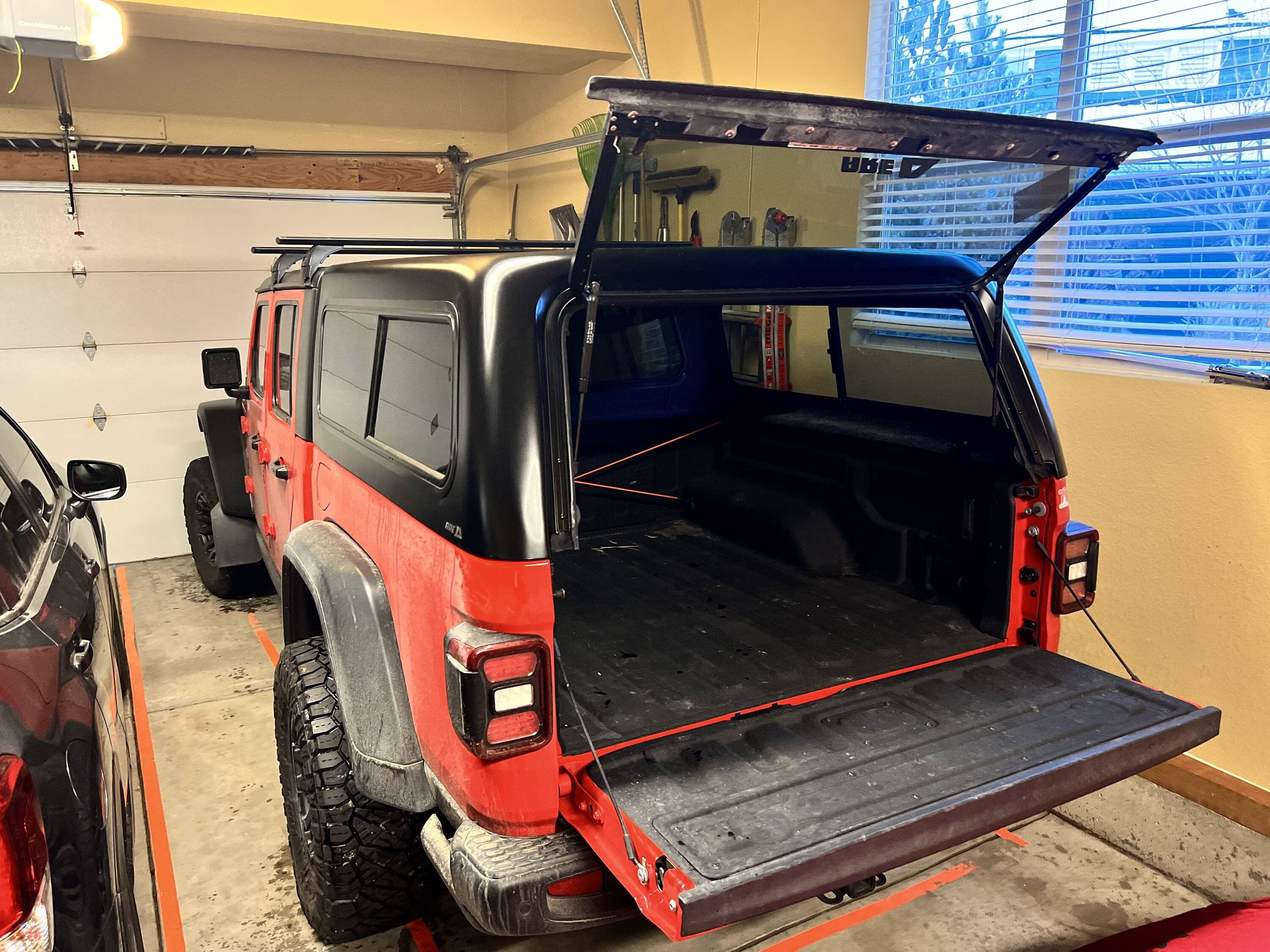

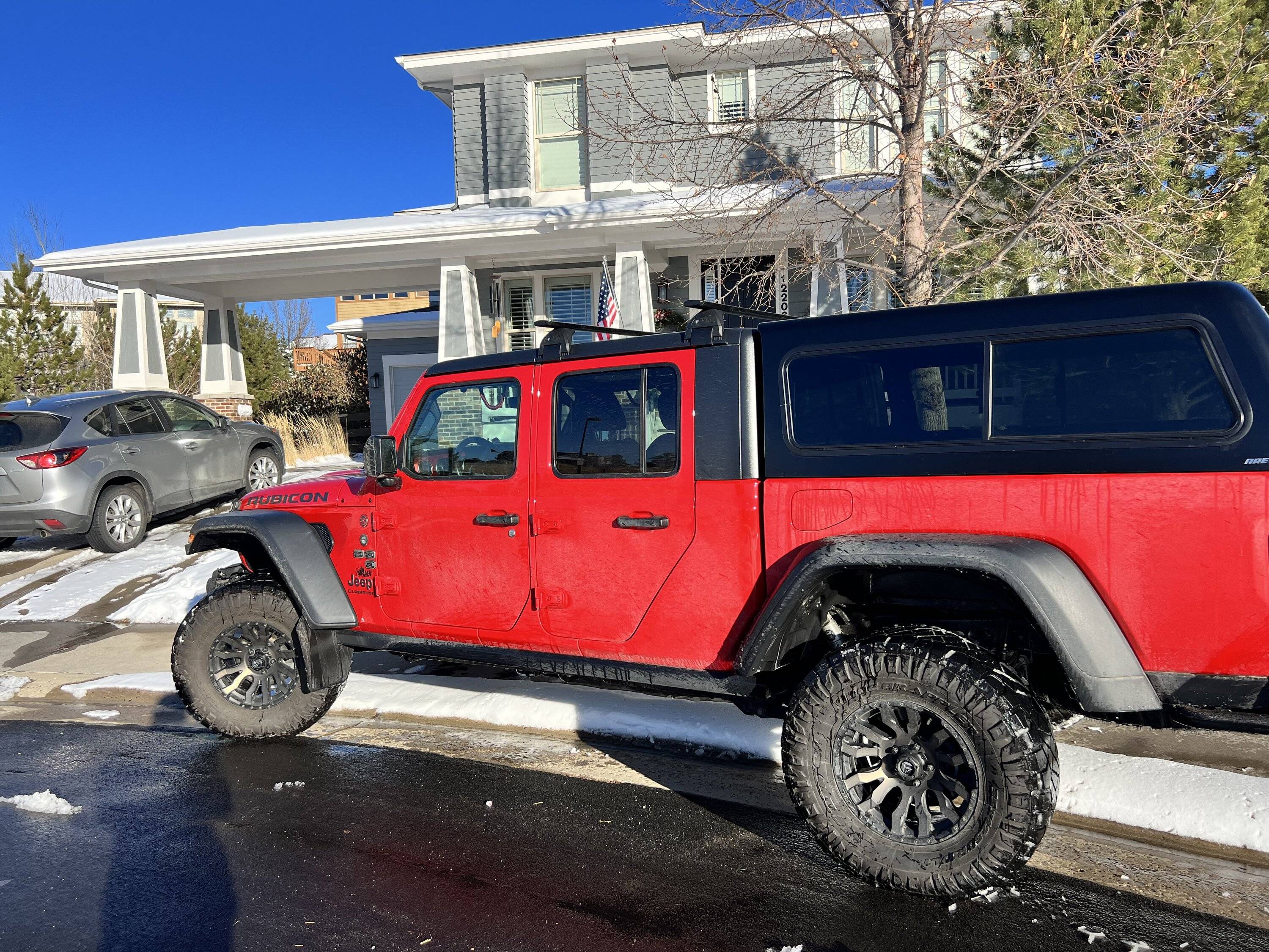

Hi there. I have a 2021 JTRD with the Mopar 2” installed.
On the front I also added metal cloak pads, and a 1/2” spacer on each side.
Today I installed an ARE CX topper, and the truck now squats an extra 3/4” in the rear.
I have a set of Daystar 3/4” poly spacers that I can install in the rear which will add some rake back.
Is there any issue with running the Mopar 2” springs and a 3/4” spacer in the rear?
Jeep Gladiator Mopar 2” on diesel, spacer question IMG_3891
Jeep Gladiator Mopar 2” on diesel, spacer question IMG_3889

No issues whatsoever. You’ll be fine adding a small spacer in the rear. It’s a good way to fine tune your height. Just remember with the added weight in the rear the suspension may feel a bit softer back there. Someone will probably get on here and tell you to buy a stiffer spring for your added weight, but take it with a grain of salt.

I run a day star 3/4 in the rear to compensate for a topper and decked system. Had Fox shocks, switched to bilstien’s and no issues. So, not sure if you have an older Mopar or a newer Mopar lift (shock difference).
