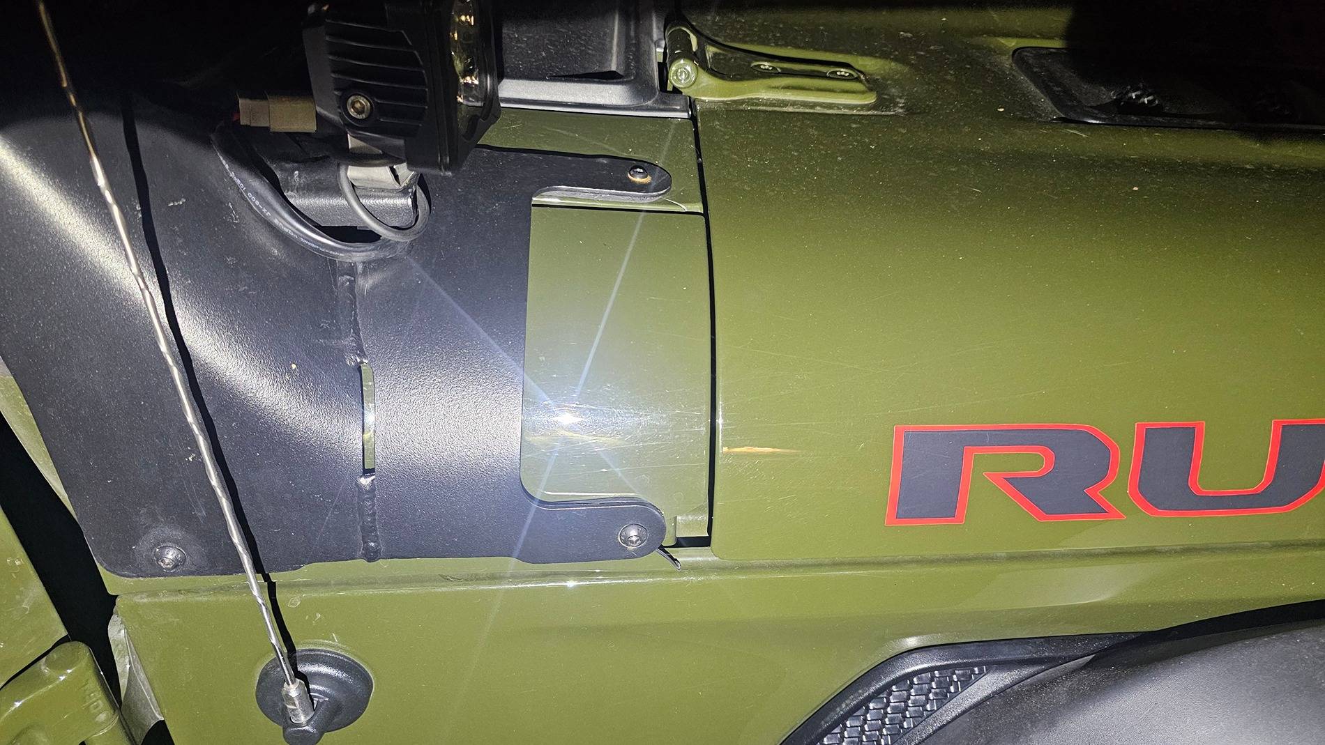

Hey Benny, I have a 2023 Sarge Green JTR, and need replacement cowls all the way across. Slid sideways into a tree branch and broke left right and center!
Which part numbers are those?

Hi Gary,
Can you post up a pic of what were looking for please.
Thanks,
- Benny

Hi Benny, sure thing! The branch hit the bottom of the light bar mount and the force propagated all the way across to the opposite side. The hole is where the branch punched through the cowl.
Wow those are the cowl pieces indeed, Just wanted to make sure. These do not come pre-painted. Here are links to them
https://parts.allmoparparts.com/oem-parts/mopar-cowl-side-trim-panel-left-6bm51tzzad
https://parts.allmoparparts.com/oem-parts/mopar-cowl-side-trim-panel-right-6bm50tzzad
https://parts.allmoparparts.com/oem-parts/mopar-cowl-top-panel-6bm52tzzae
I will send you a code you can use,
- Benny
