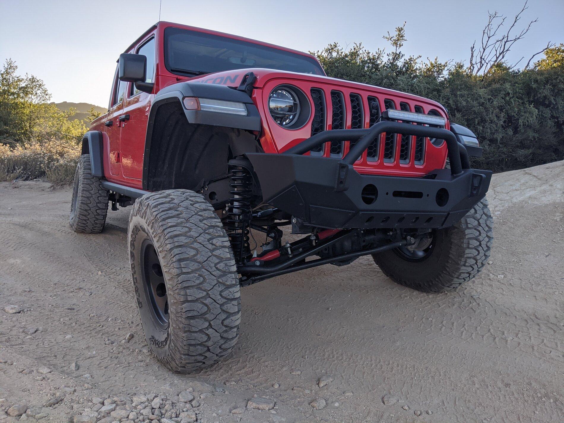

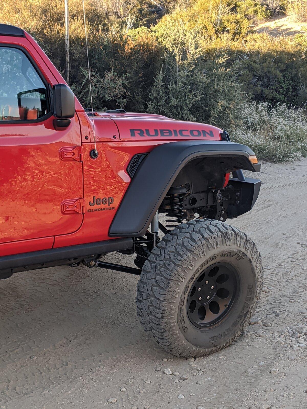

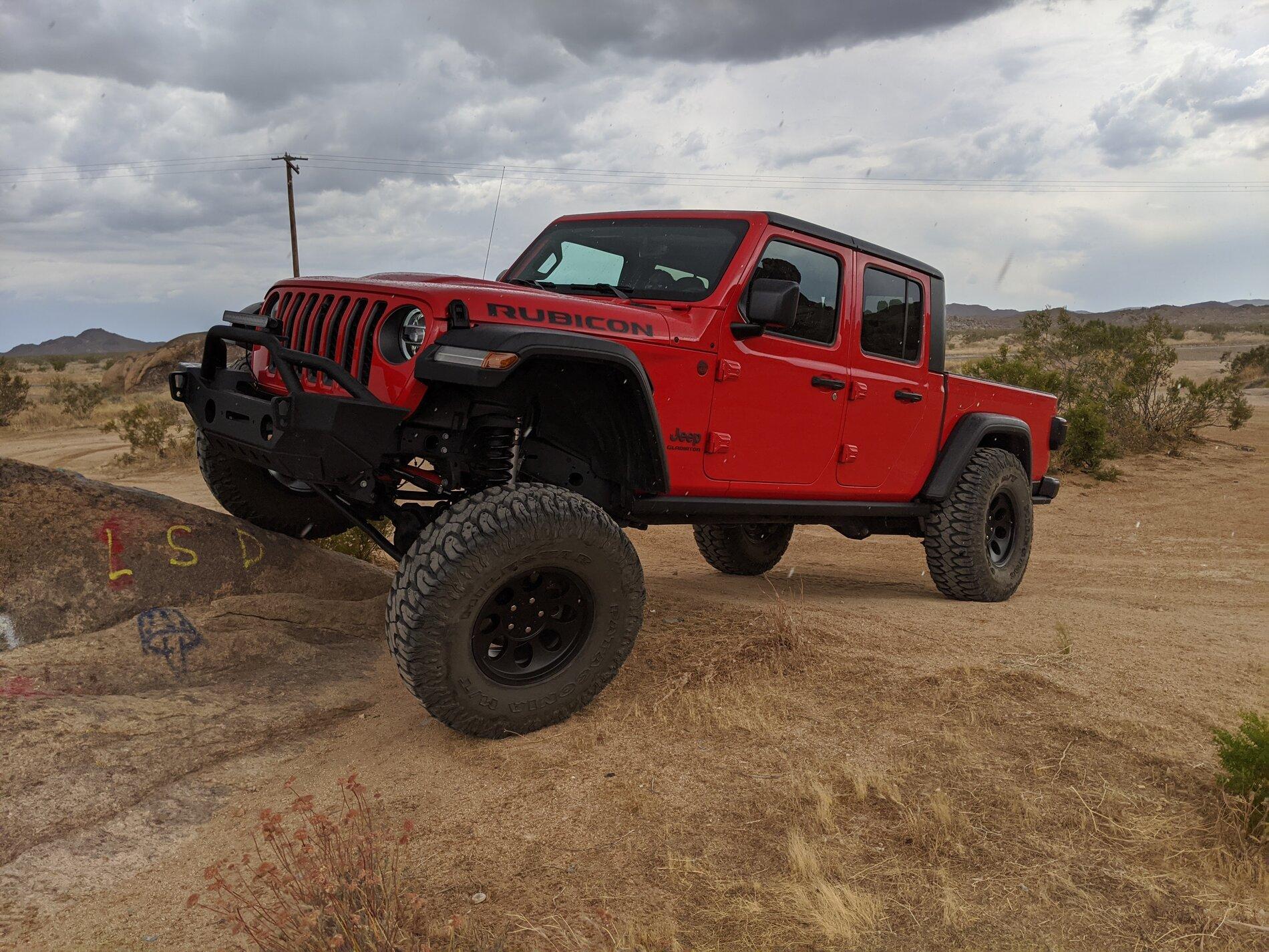

Front swaybar disconnected, 6" front lift/4.5" rear lift 4.5" EVO Enforcer lift. Stock driveshaft. Steer Smarts track bar. I plan on changing the driveshaft to the Adams shaft I have on hand.
