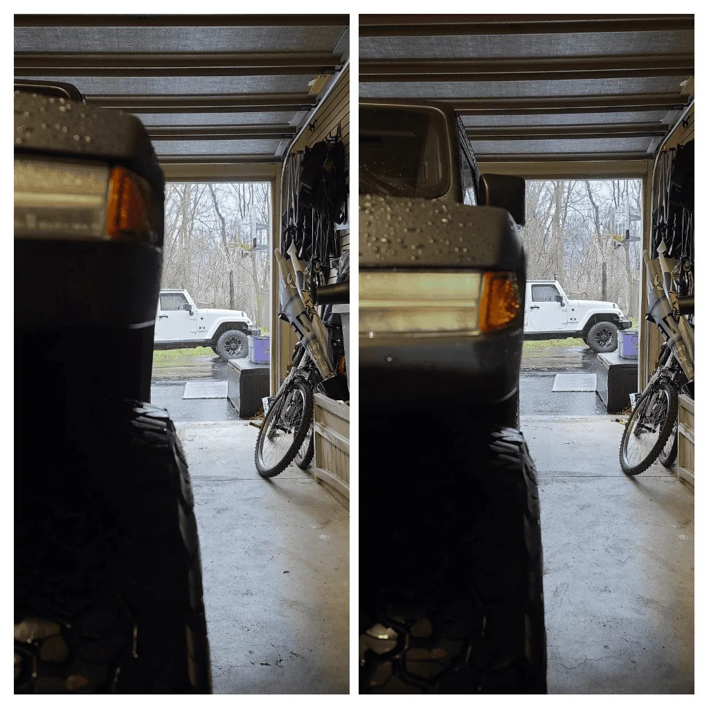

Maybe I'm just not noticing much because I have Rubicons and they already have some lift and possibly a longer track bar then the sport. Maybe it's more pronounced in the sport type trims.
Here is a before/after of mine: also a JTR with the MOPAR lift. Even though it's a rubi, the stock track bar allowed the axle to poke about 3/4" to the driver's side. I couldn't really "feel" it when driving, but my OCD got the best of me
