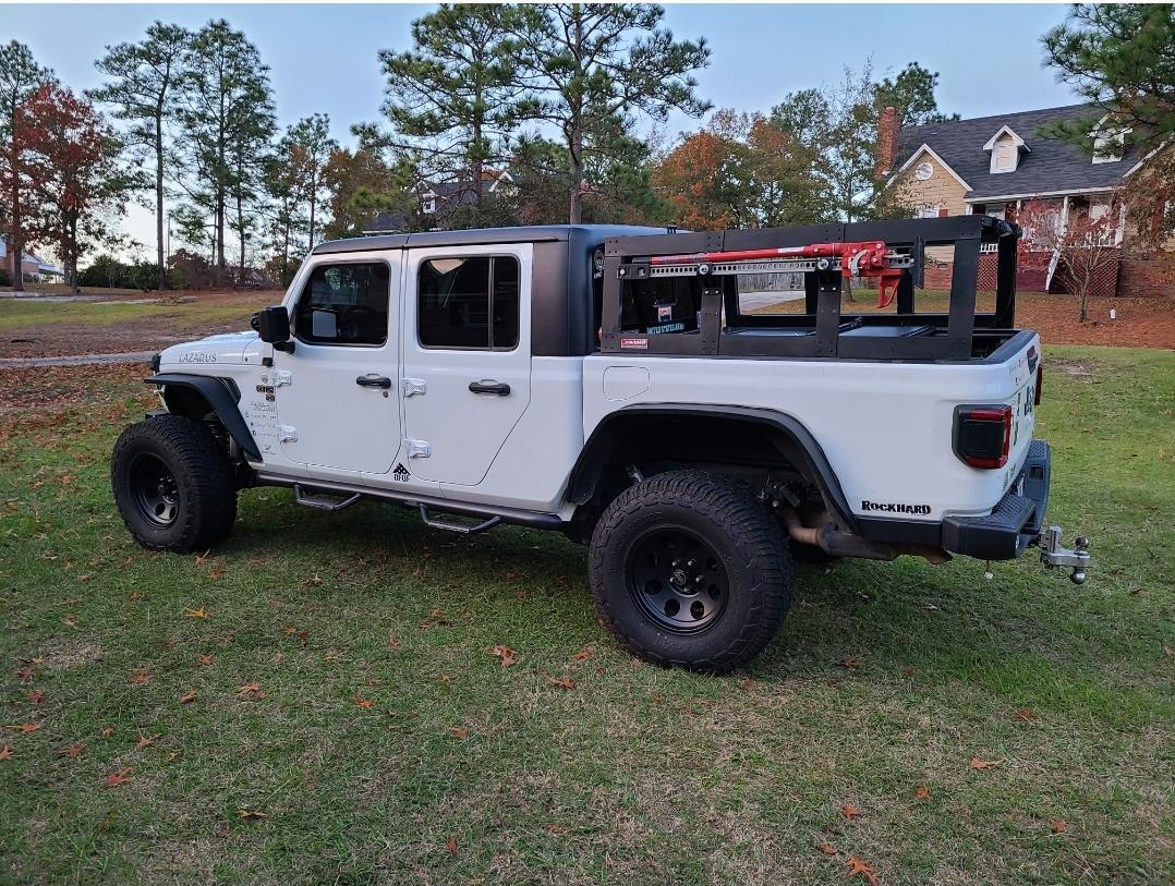

I bought my JT 6/2019. Have 57,000 miles on it. Put on the Mopar lift around 6,000 miles. I travel to different states. I jail a boat. I tow my 16' ATV trailer. And I tow a RV. I am pleased with the lift. No trac bar or anything extra. Just the kit. Rides good, handles good, performs good. ?
Edit: I guess I should note that I have a 3/4" Daystar spacer on the front of the Mopar lift. I installed the spacer when I had the lift installed because of the weight of the aftermarket bumper and winch. I already had a pretty bad rake to it. The spacer still left a little bit of a rake but it doesn't look bad.

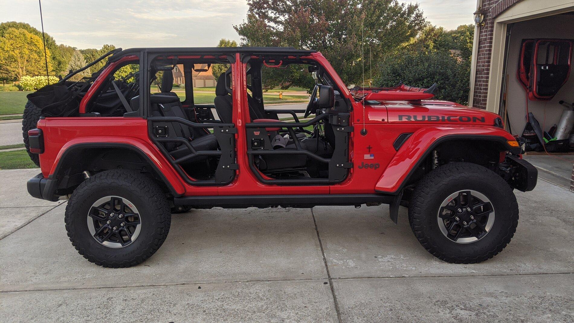

I'm no expert...but here are some clips that are consistent with my observations.
The beginning of this video (it's about track bars but I think still applies):
At the ten minute mark here he is talking about the control arms:
The ride on the Mopar lift was fine, I'm on a JT Rubicon - hard to distinguish from stock. I do prefer the metalcloak springs/shocks though. In my experience it just feels smoother overall. YMMV
I did put adjustable track bars, Rancho front, Rough Country rear, just to center the axles. It drove and performed fine without them. But like I said, I've had mine off road A LOT. I've beaten the hell out of it on all kinds of terrain, from rocks to ruts to mud to sand and snow. No issues. No tire rubbing. No regrets. And again, the shocks are simply superb, both on and off road. Friends with other lifts have ridden in it and immediately, every time, raved about the smooth ride off-road. It still corners well for a lifted Jeep, too. It's been on the Tail of the Dragon twice and was fun there, too. Good road manners with no surprises, even when pushed hard. I feel like it does everything well. I did forget to mention that I also added a Fox 2.0 steering stabilizer after the original and 2 warranty replacements failed. It works well, too. I'm on stock rims with 315x70x17 BFG KO2s with a C load range, for reference.
Jeep Gladiator Mopar lift regrets IMG_20200829_193345
We'll be putting my brother's Gladiator to the test later this winter and also in the spring, so I'll report back. From driving it around on-road, it feels just like mine on the JL, other than the stiffer ride from the E rated tires. I'll post up a review once we get it on the trail. He's very happy with it so far. Btw, his is mated to 35x12.5x17 Falken Wildpeak MTs on the stock rims. No aftermarket track bars yet. He hasn't noticed the axle offset and probably never will. Heck, I wouldn't have noticed it if I hadn't been told to look for it.
