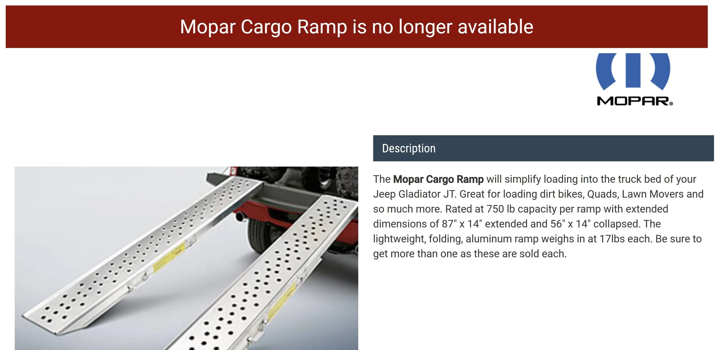

Looking for actual specs related to the tailgate load capacity when the gate is fully opened. Page 111 in the 2023 Gladiator owner's manual "the maximum load for the tailgate in the mid position is 350 lbs." I found Mopar Ramps no longer available . . Easy to overcome the loading angle issues by parking in a position the reduces the loading angle, but I'm curious about the weight capacity and why the ramps are no longer available.
Jeep Gladiator Mopar tail gate ramps - weight capacity? MoparRam

Thanks for the replies. That is exactly what I was looking for! 850 with dual ramps and 1850 appears to be a static load without ramps and the tailgate down.
