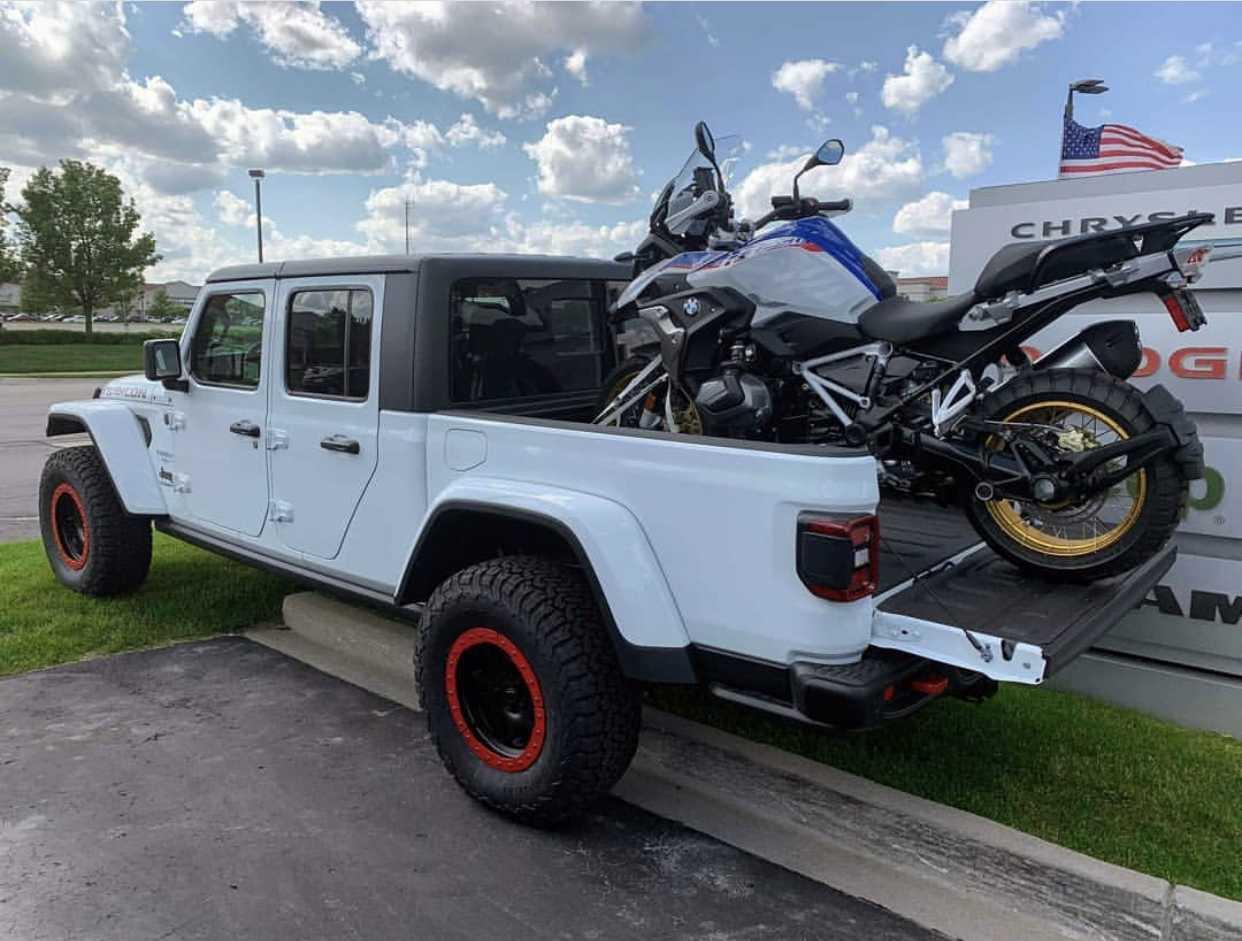

Anyone know if the tailgate can hold a HD road glide? About 1000 lbs

Will a RG fit in the bed at all? They're 8 feet long the wheelbase is over 5. It may fit. I wouldn't be worried about the weight it won't all be on the tailgate. I'd be more worried about the length. Kendon makes some very nice motorcycle trailers that's how I'd transport my bikes if I had to bring both.

Yea with the tailgate open it will fit, that's why I akaed about the wieght on it open

Good Morning,
Sorry for the delay in response, per the Jeep team:
  1. Up to 500 lbs payload can be carried in the bed with the tailgate in the mid position. This payload rating is dependent on the sheet cargo being properly supported with 2x4s positioned in the bed as specified by the owner's manual.
  2. Ramp load at end of down tailgate
    • Single ramp = 600lbs
    • Dual Ramp = 425lbs/ramp or 850lbs total
  3. Distributed load across down tailgate: 1850lbs
Please let me know if you have any additional questions.
Lamar
Jeep Social Care Specialist
This is from another discussion. The Harley will probably max it out if loading from a ramp but the full weight of the bike will be spread out so I don't think you will have a problem.

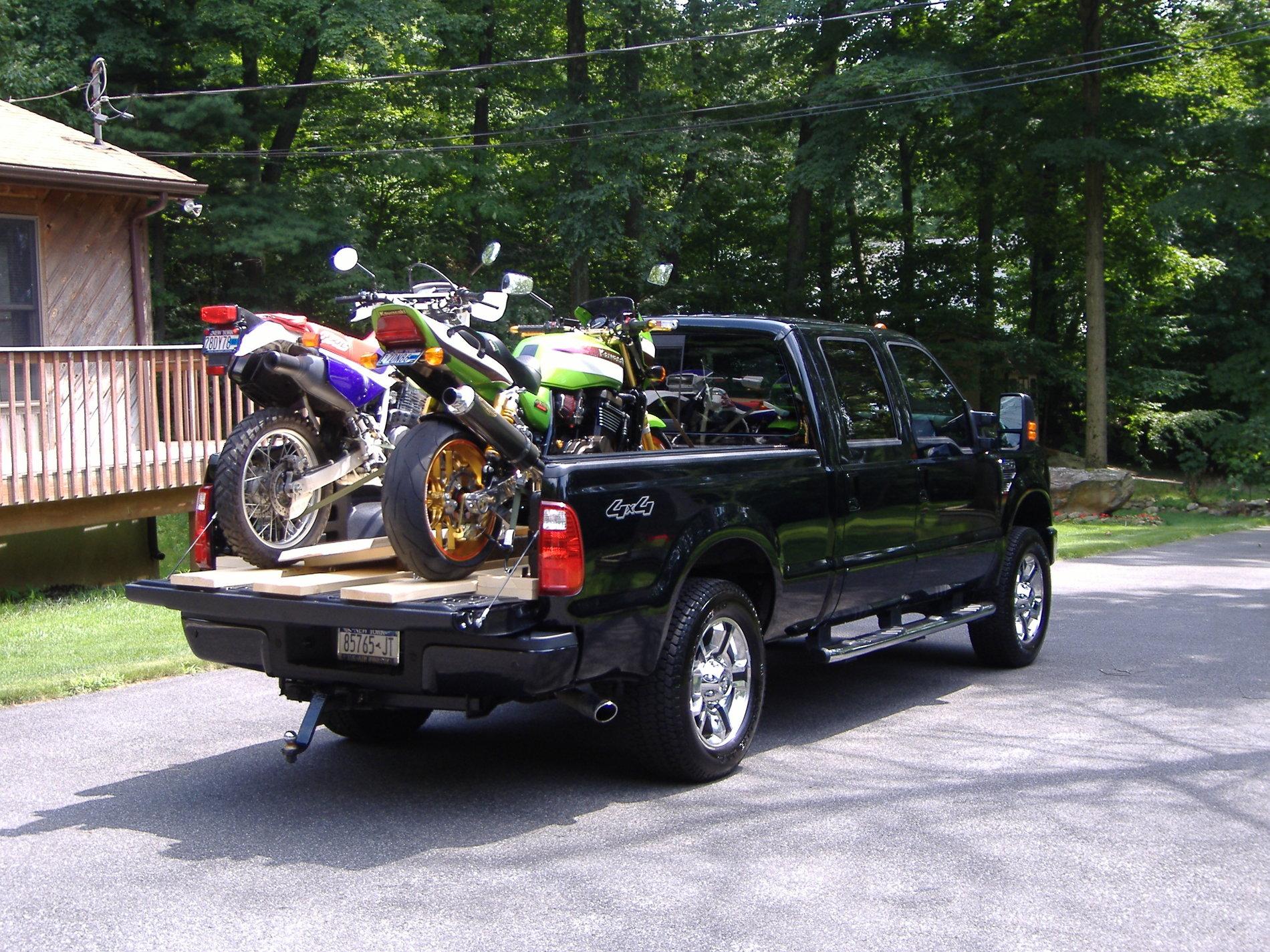

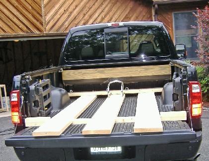

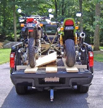

What I ended up doing with a truck I had some years ago. Snowshoe, spread the load. The weight of a bike, hitting a pothole, on a tailgate? Too much to bear. I've seen some tailgates collapse.
