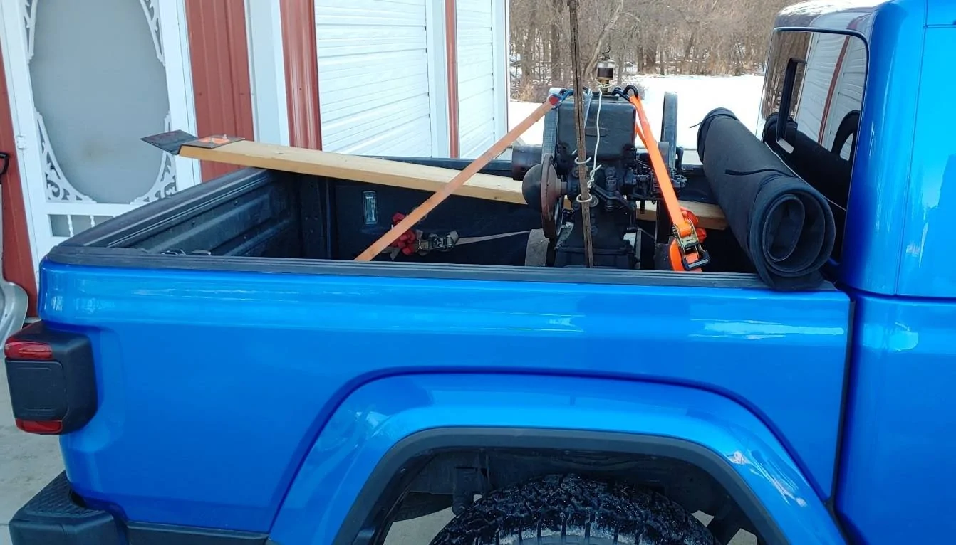

I see where I went wrong. I didn't have a 3rd support installed. I had just the forward most spar and the tailgate. I was figuring on #10/board, so about #800 not including the pressure of a ratchet strap. So there's that.
Admittedly, I didn't read the book. I just put things in the back.
A better solution would've been to lay the boards on the floor and then strap them, but hindsight is 20/20. I'll check those products out in the meantime.

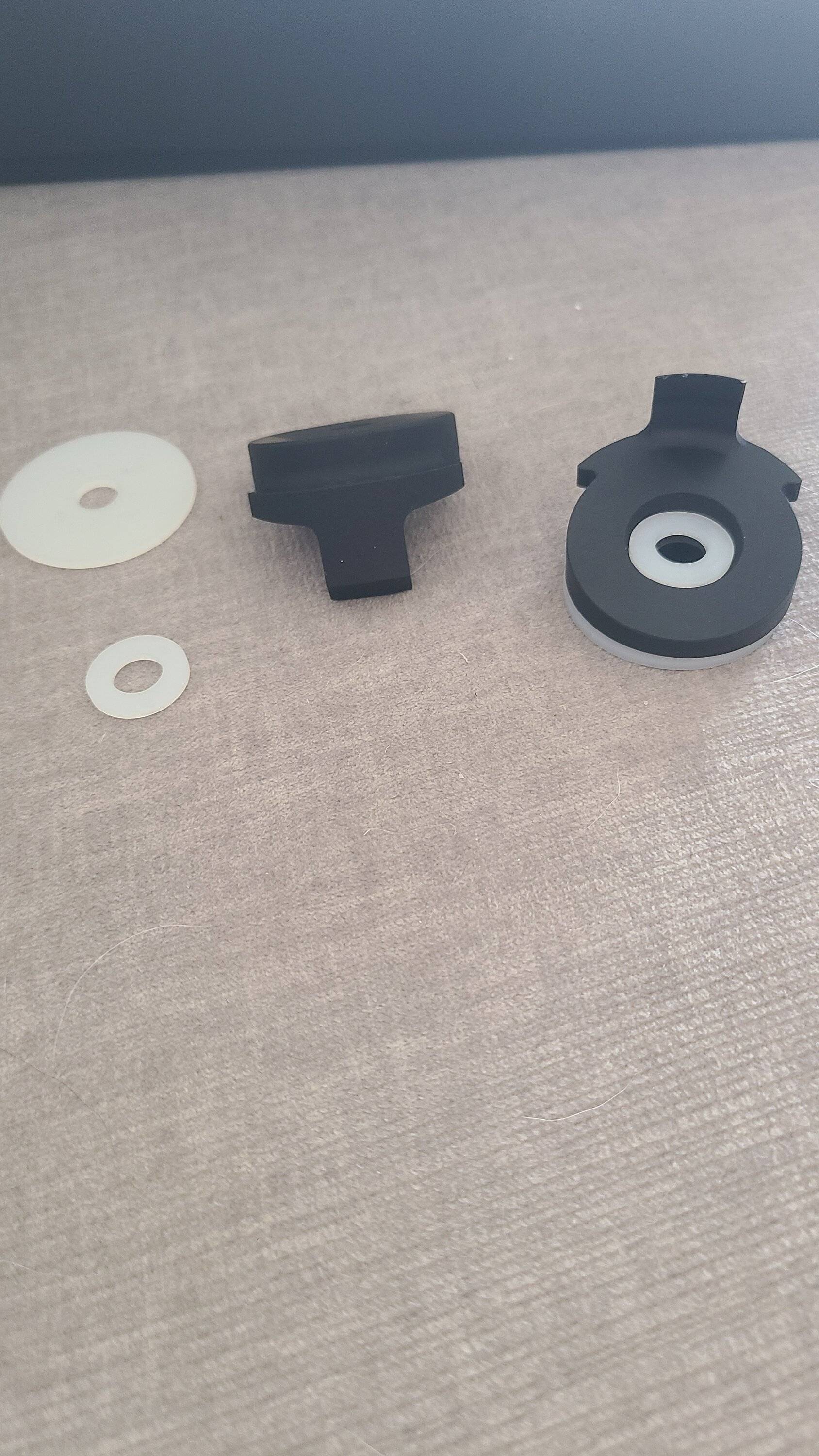

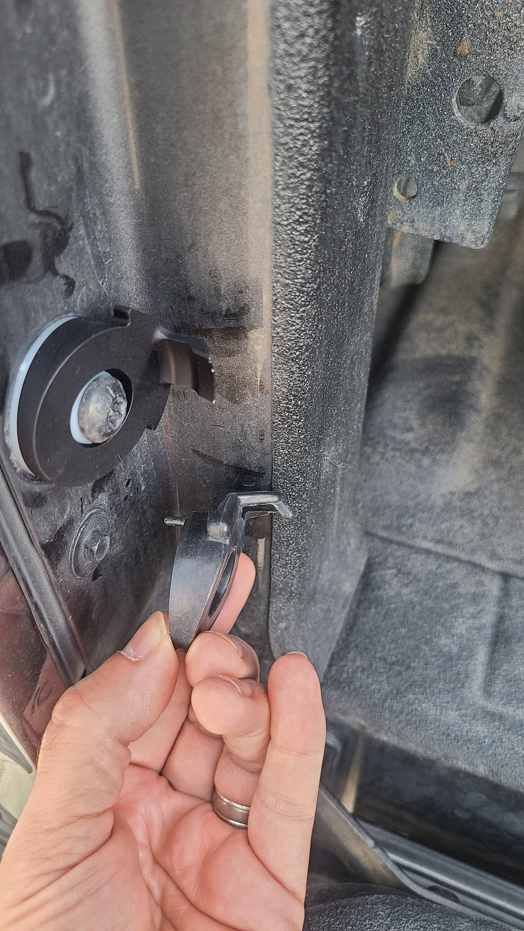

Installed the gladius offroad product today.
The finish is good (not great, but above average). It is radiused where it needs to be. Took me about the same time to install it as to unbox it.
Only minor issue is that the OEM part is indexed while the Gladius part is not (see second pic). So I will watch for rotation over time.

I just got mine in the mail today, You're right about the finish, and mine had some sharp edges but not terrible. Fast shipping. I cant see why it wouldn't work. As long as I get that middle spar in, I should be good to go. Thanks again everyone
Hey bud. I actually own Gladius Offroad and designed the bracket. It's been 9 months or so, I was just curious if you noticed any rotation. I left the index peg off to keep cost down, and the plastic one was so small, I figured it really didn't do much anyways. I originally designed it for my Jeep when I broke both of them, so I decided to just do a run of them. Mine have held up pretty well, almost 3 years now. I'm alway open to feedback to make a better product, so I appreciate the honest feedback.

Ryan,
First - awesome follow-up ... much appreciated
funny you should ask ... I haven't looked at it closely since the first week after install until today when I was taking the Christmas tree to the composting site ... it looked like the driver's side had rotated clockwise by between 5 and 10 degrees ... not causing any issues, but it was slightly off ... the passenger side had not moved (because of how I have the bed loaded, most of the time that I have the tailgate partially open and something resting on the tailgate beyond the bed the load tends to be on the driver's side ... this might explain why the driver's side rotated and the passenger side did not ... asymmetric load and vibration driver>passenger)
As a follow-up to my prior observations - the finish is holding up great after almost a year ... as to the lack of an index, it would be a nice addition but would not have changed my experience over the last year but I will probably fix the rotation within the next month just so that I can ignore it for another year! Even with the original design I would buy it again ... and with follow-up like this, even moreso
