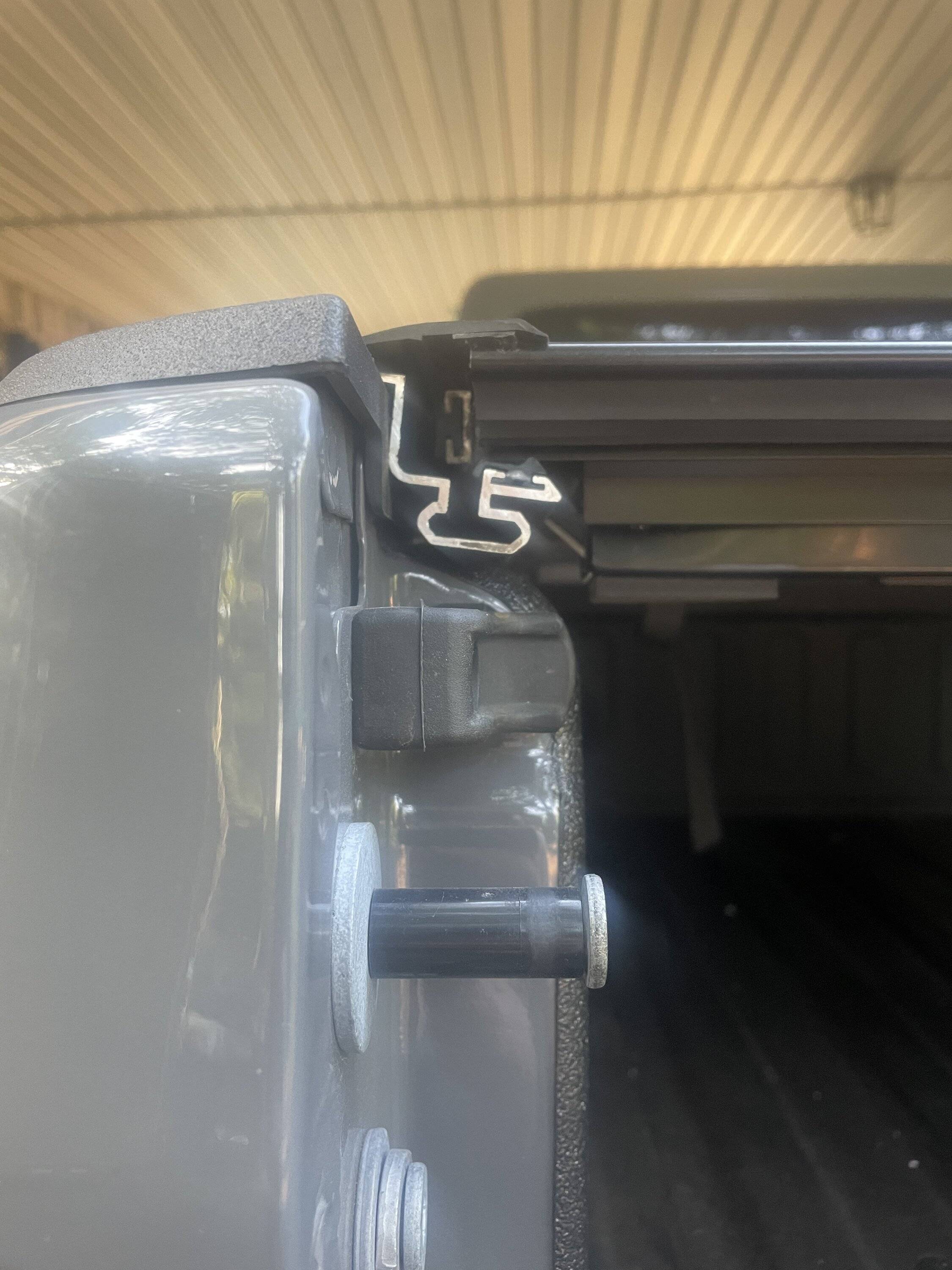

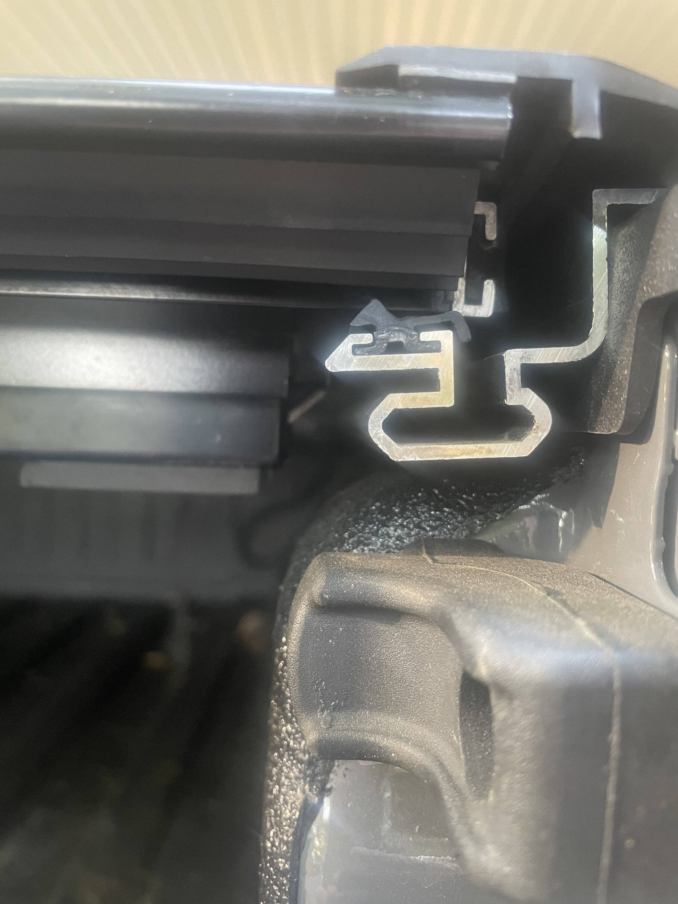

Jeep Gladiator Mopar Tri-fold latching issues 02BC9E31-52B7-4499-8B98-404BA56D016E
Jeep Gladiator Mopar Tri-fold latching issues F242FD68-D46E-40BB-B471-E99C543D11C3
At first glance, it looks like the sides sag a little so the latches don’t go down far enough.
At the end where it bolts onto the bed, 2 on each side. Behind the track there is a nylon spacer between it and the bed, when I had taken it off one time I had to replace them cause they where falling apart from getting crushed. It could be that they have fallen apart causing the track to rotate.
It is tight in there to get the two hex screws out.
DoctorDecoy
DoctorDecoy
Derek
Apr 11, 2021
81
93
West TN
Ford Escape
Thanks. Surely I can find a spacer at the nearby hardware store without having to order something from Mopar.
