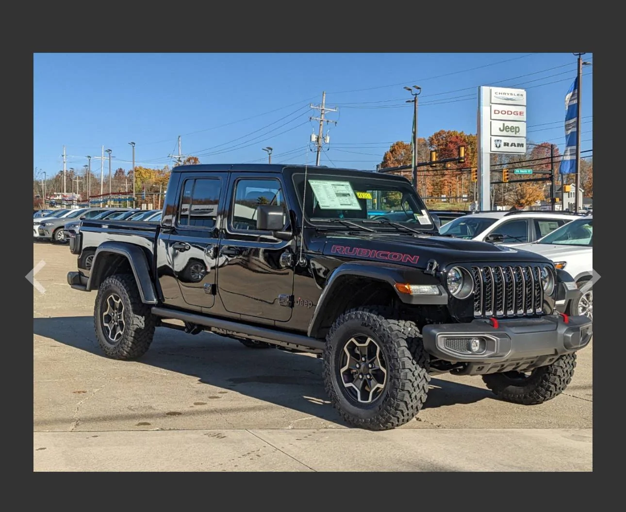

Just picked up a 2023 rubicon 2 days ago. 43 miles on it!
dealer offered me the mopar undercoat for basically free. (500$ vs the 1200$ cost) I’ve been a buyer there a long time.
so I said ok great!
As it was explained to me it’s a non rubber permanent liquid/ wax like substance.
they dry the underneath with blowers to ensure it’s 100% dry. Apply it underneath and inside the doors. Then let it sit for about 2-3 hours. It comes with a lifetime rust guarantee.
Anyone familiar with this stuff? its not fluid film as far as I can tell. Even if it’s snake oil , they guarantee I’m going to be rust free forever.
