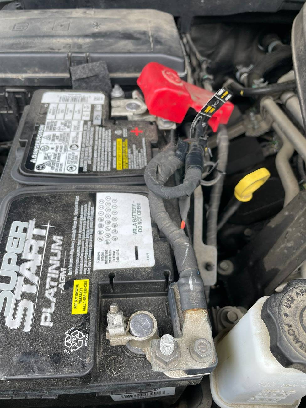

Long story short. Bypassed my aux battery and pulled the negative cable and fuse 42 etc back in Oct / Nov 2024 when the aux battery took a dump and stalled the truck in my driveway at 9V. Then my truck went haywire and voltage on the cluster was 16+ volts and changed the main battery around Jan / Feb 2025 and upgraded to a 94R battery size. All was good after that. No issues
Auxiliary battery ground cable based on year - there was a change during the 2021 model year.........
2020 and I believe early 2021 the ground cable is the small ended cable. Later 2021 and going forward, the cable with the large end is the auxiliary battery ground cable.
You can also tell by the gauge of the cable.
Jeep Gladiator More electrical gremlins. JT-neg-bat-post-cables-ibs
So those disconnecting the aux battery cable ground must make really sure they pull the correct cable.
Many simply pull the ground, pull F42 and move on, aux battery still in place, but isolated by disconnecting the correct ground cable from the top of the IBS.

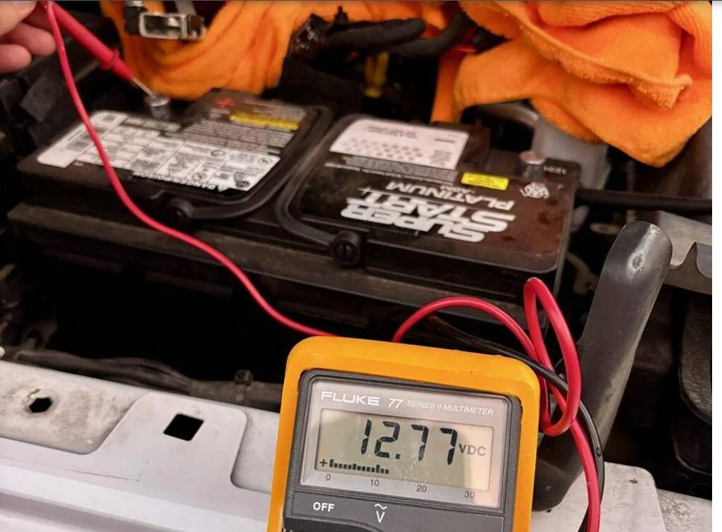

Time to charge 'em - that's only about 50% charged! They should be in the 12.8 territory fully charged, 12.2 is as far down as I'd ever let a battery get. (even an old-school battery)
Did anyone else catch this picture?
How does a Fluke read battery voltage with ONLY the positive lead on the positive terminal of a battery?
What's the Fluke black lead connected to - and if there's nothing on that battery connecting it back to the vehicle, all terminals are removed, how do you read voltage by just holding the red lead on the positive terminal?
Take a look - there's nothing at all connected to the negative battery post - yet he's getting a reading?
I just checked again for what it is worth. The Jeep has been parked for a week without running. I left the key inside and measured the voltage at the battery. 12.66vdc. I opened the door and turned the lights from auto to on. 12.5vdc but recovered to 12.6vdc in a few seconds. I got the key and turned the accessories on. 12.4vdc turned the fan on and the lights on. 12.2vdc yet if I let it sit light that for a few seconds the voltage again recovered to 12.5vdc. I started the engine( no ticking). The dash and meter both said 13.7vdc and 14.2vdc if I bumped the throttle. I pulled it closer to the next available extension cord. It'll be fine.

As far as a cable "bouncing around and touching ground" - he never said he took out or disconnected the cables at the aux battery - only that he pulled the aux ground cable at the main battery.
(Hope he pulled the correct cable! - that varies based on the year!)
Since he has a 2021 - he's in the middle of that change.........
Yup. Mine was built in Sept 2020 as a 2021 model year and have the 2020 terminals as shown above. I have only pulled the negative cable and fuse 42. You can see it tied back to the right of the battery below. Have never touched the positive cable from aux battery
